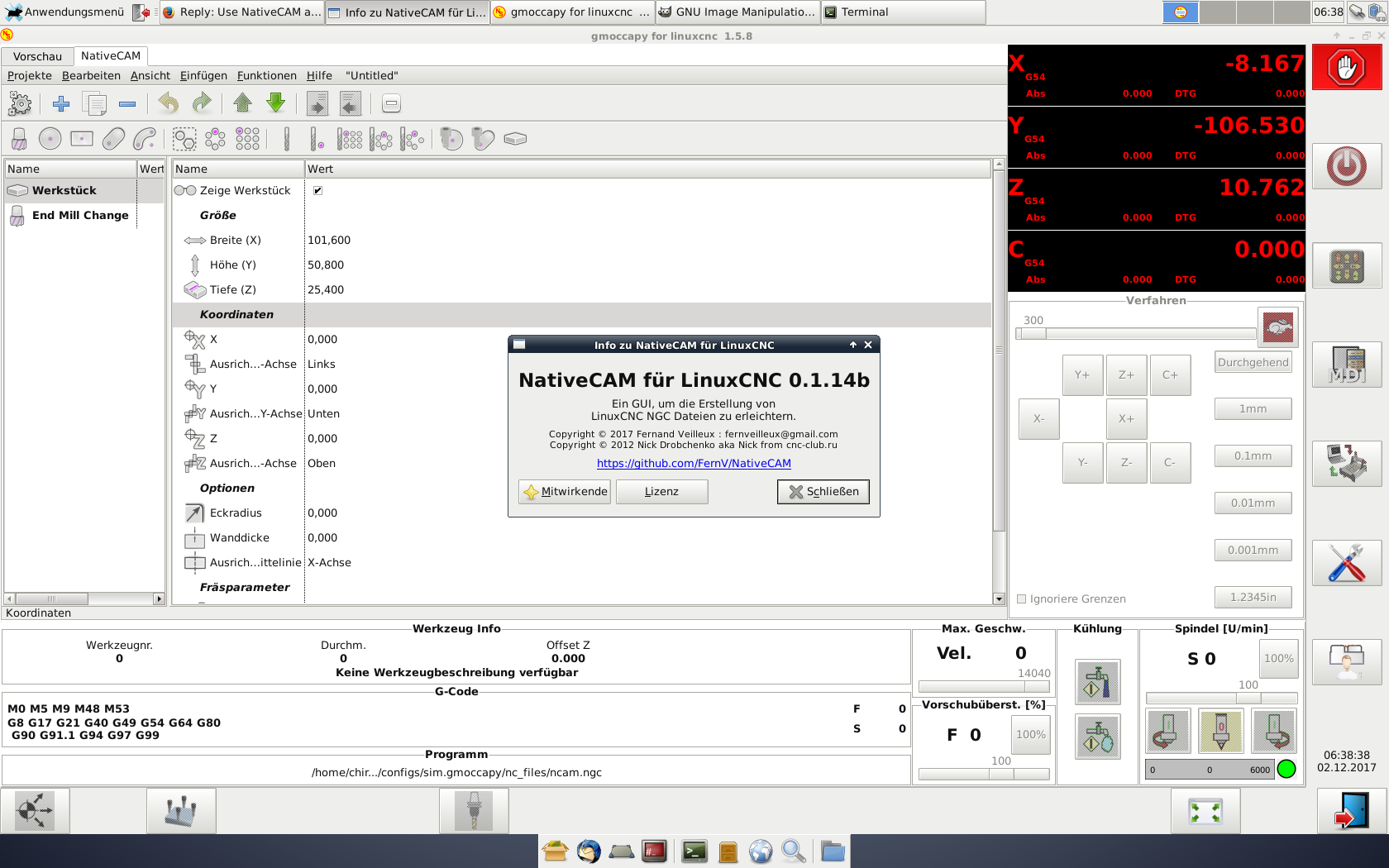

02 Dec 2017 05:47 #102581 by Weiler810T
Replied by Weiler810T on topic Use NativeCAM as a deb package now
Hallo
What's that, Bug or Feature? ;)
task: main loop took 0.013716 seconds
Xlib.protocol.request.QueryExtension
/usr/share/linuxcnc/aux_gladevcp/NativeCAM/ncam.py:2644: GtkWarning: IA__gtk_accel_label_set_accel_closure: assertion `gtk_accel_group_from_accel_closure (accel_closure) != NULL' failed
mi = _action.create_menu_item()

Benutze default mill/menu.xml, kein mill/menu-custom.xml gefunden
Voheriger Zustand nicht als aktuell abgespeichert
task: main loop took 0.011793 seconds
task: main loop took 0.011890 seconds
task: main loop took 0.017384 seconds
/usr/lib/pymodules/python2.7/gmoccapy/notification.py:168: GtkWarning: Invalid icon size 48
Current status NativeCam:
Time to create page: 0.227 seconds
