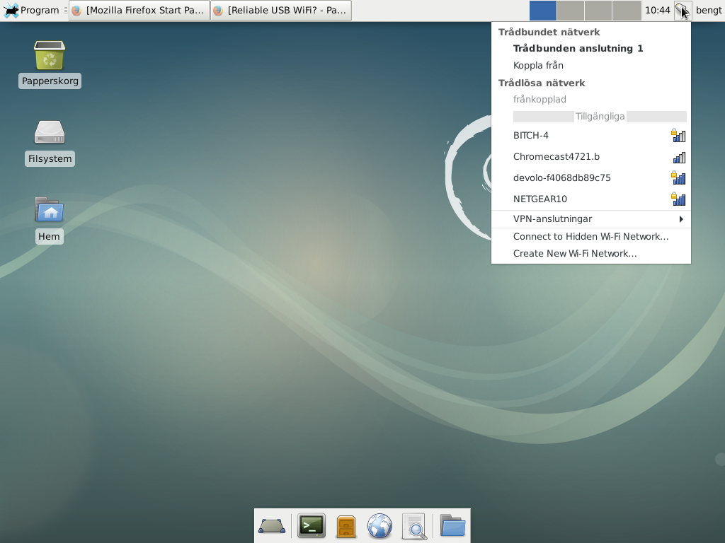

What utility are you attempting to use to configure this device ?
- tecno
- Posts: 1850
- Thank you received: 127
03 Nov 2017 09:34 #101237
by tecno
Replied by tecno on topic Reliable USB WiFi?
Only the built in *Edit Connections* on desktop top right

Is the wifi dongle seen in the config utility ? You have answered yes and no to the question .
- HumanDebris
- Visitor
03 Nov 2017 09:51 - 03 Nov 2017 10:25 #101242
by HumanDebris
Replied by HumanDebris on topic Reliable USB WiFi?
Ok
What you need to do is add these options to grub net.ifnames=0 biosdevname=0
This will rename your wired ethernet port to eth0 and wifi to wlan0
This is an example of my grub line....do not copy.
linux /boot/vmlinuz-4.4.0-62-generic root=UUID=17818cd8-a2fb-4f61-9c69-9d7f0c7058d7 ro quiet splash net.ifnames=0 biosdevname=0 $vt_handoff init=/sbin/upstart
This page will show you how to modify grub
wiki.linuxcnc.org/cgi-bin/wiki.pl?The_Is..._Parameter_And_GRUB2
The problem seems to be the wifi firmware has an issue with the length of the wifi interface name.

Yes I can see the MAC address
- Posts: 12155
- Thank you received: 4148
03 Nov 2017 09:57 #101244
Your screen dump displays a list of available networks. To me that says your USB is working and you just need to connect to your network with network password.....
Replied by rodw on topic Reliable USB WiFi?

03 Nov 2017 09:59 #101245
by tecno
Yes that is correct, I can connect with phone - laptop etc with no problems but this PC no.
