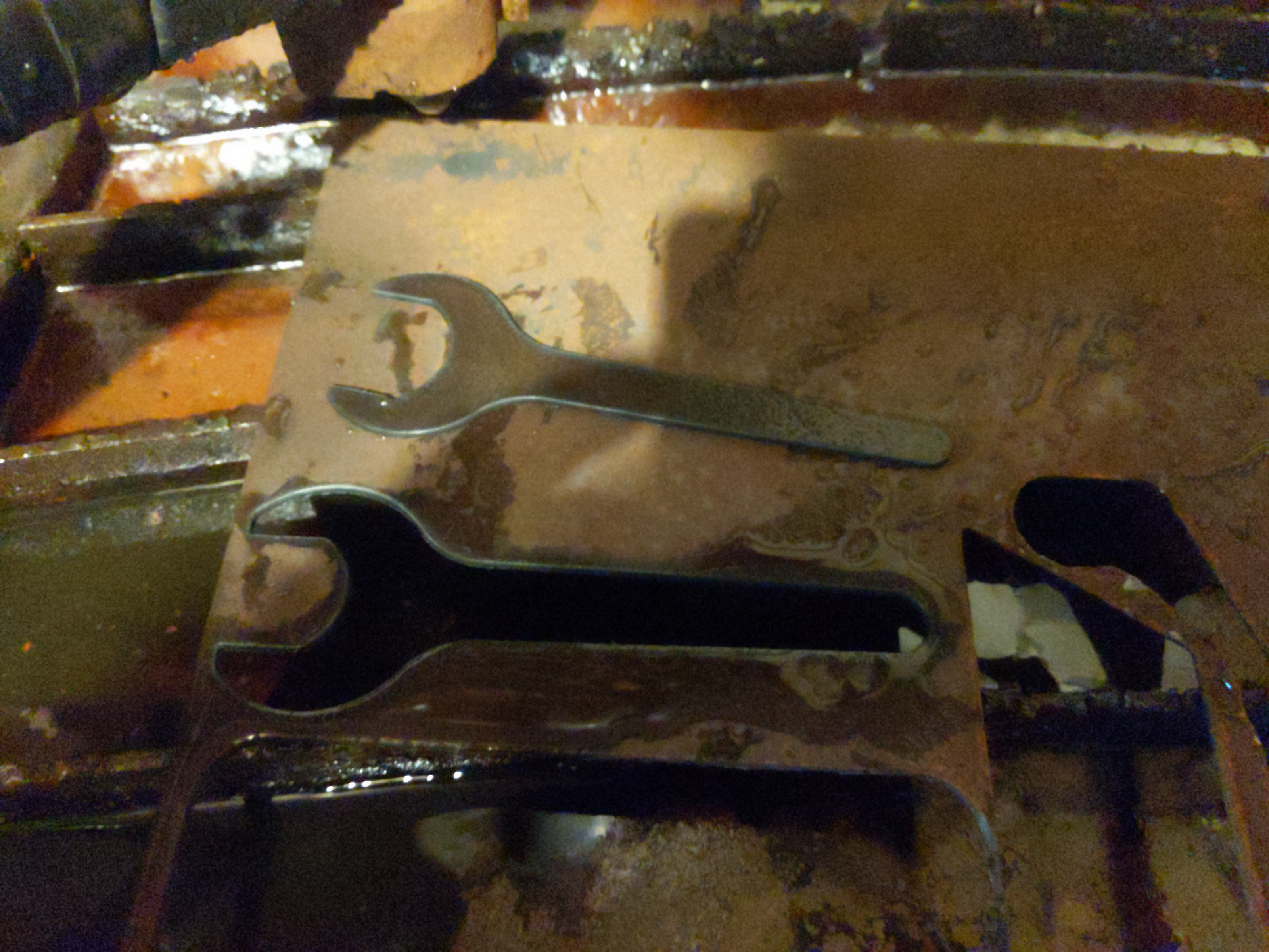

Same thing Phill,
But this time the corner lock button lights up.
- thefabricator03
- Visitor
28 Jun 2019 07:15 #138096
by thefabricator03
Replied by thefabricator03 on topic Another plasma component...
Could someone post a working Gcode file of anything for PlasmaC and I will see if it is my post processor that is causing the problem.

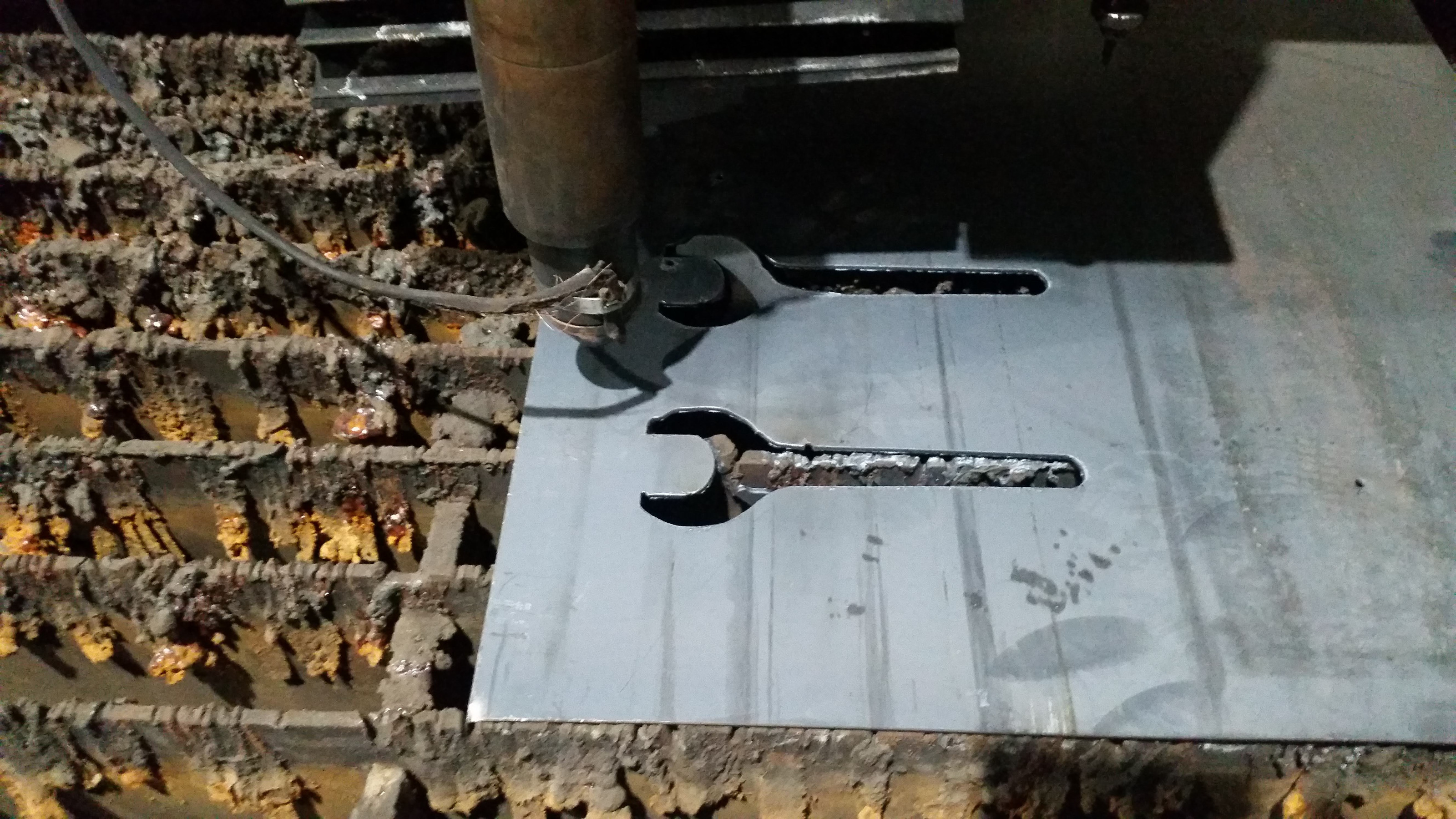

Thanks Phill for your help, It was the file I processed in sheetcam that was the problem,
- Posts: 12161
- Thank you received: 4151
28 Jun 2019 10:48 #138109
Hmm, its exciting to see another new plasmac machine operational but I think thats the fist time we've seen the plasmac spanner emerge from a cut sheet. Well done Stefan! What post processor were you using? DO you want to post about it on the sheetcam thread?
Replied by rodw on topic Another plasma component...

Thanks for the report, I hope it is working for you.
I should put a lead in on that wrench if you guys are going to actually cut it...
I could make it so that if Safe Height is zero then it goes to Z maximum height, That shouldn't affect existing configs.
