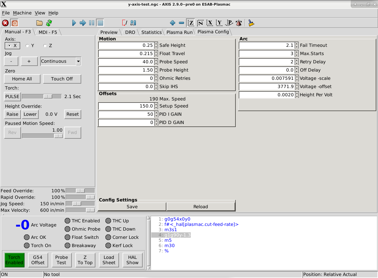

Could you post a shot of your Config tab.

01 Jul 2019 03:04 #138280
by mkardasi
Replied by mkardasi on topic Another plasma component...
- mkardasi
- Posts: 48
- Thank you received: 18
01 Jul 2019 03:05 #138281
by mkardasi
I changed Safe Height to 0.25 see if it resolved the problem and it did not.
