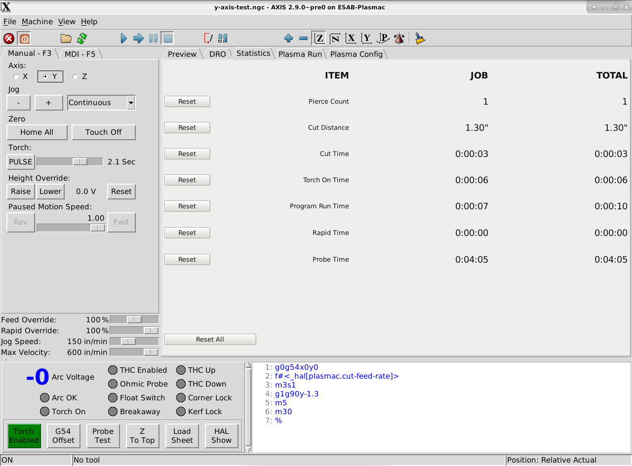

Well the good news is that the LinuxCNC buildbot now has PlasmaC in the master branch packages and the documents are now online as well, in both HTML and PDF format.
The latest version has an updated Statistics tab with figures per job and totalled plus run time and torch on time were added.

01 Jul 2019 00:09 #138266 by mkardasi
Replied by mkardasi on topic Another plasma component...
Probe time runs continuously on my cfg, even when not running a program. I suppose I am the only one using Safe Height = 0 if that matters.
