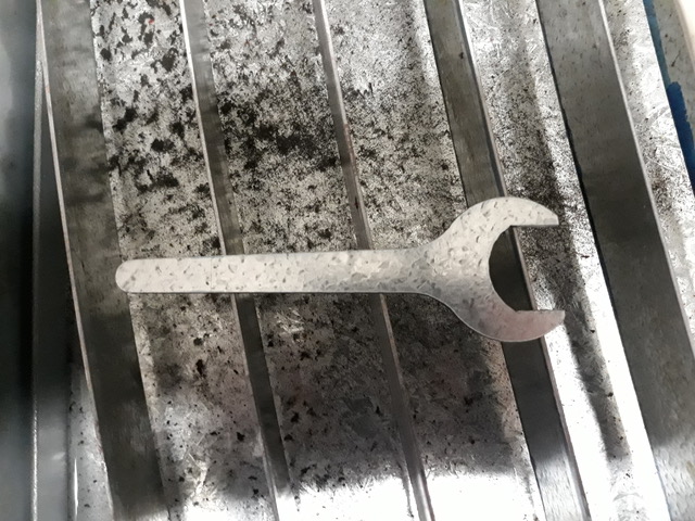

- thefabricator03
- Visitor
28 Sep 2019 04:30 #146482
by thefabricator03
Replied by thefabricator03 on topic Another plasma component...
Pics of machine?
