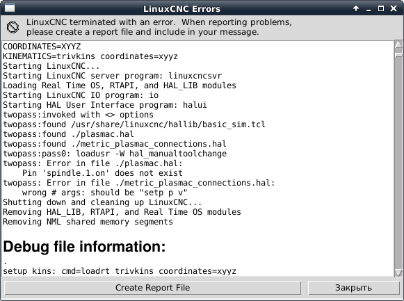

Ok, let me explain:
I set up a testing machine with a fresh new install of debian wheezy. Then I add wheezy repos(Master branch ) from buildbot.linuxcnc.org. After that I start Linuxcnc config picker from start menu.
Then i choose by machine > plasmac > metic axis;
Then i try to start it and get following error message

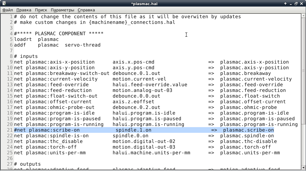

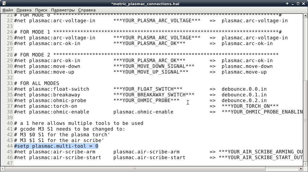

So I comment those lanes in both files:
In metric_plasmac_connections.hal
And in plasmac.hal

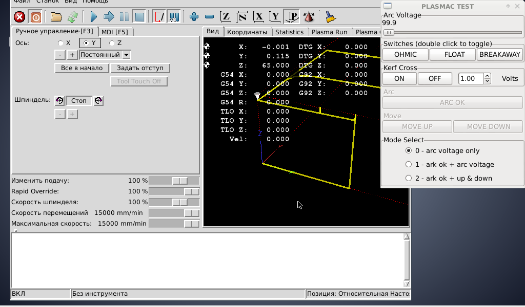

Only after that Axis starts and looks this way:
I installed debian on the old netbook, thus it has such a poor resolution, but the problem is the same on a working CNC.
So everything fine, except continuous jogging doesn't work at all. Neither keyboard nor screen buttons - and +, but if I set incremental jogging for example 10mm it moves. Then choose continuous again - nothing

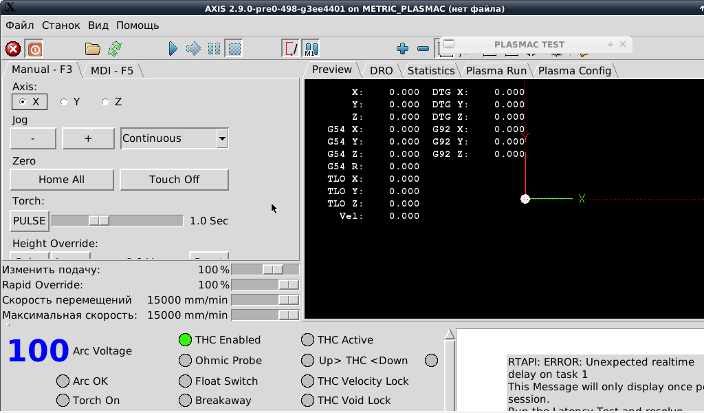

So i decided that this problem is somehow connected with the axis tweaks, because default axis behaves normally.
That's why I deleted file plasmac_axis.py and restarted linuxcnc:
Now I have working continuous jogging, but there are no PlasmaC signals at the bottom anymore.
