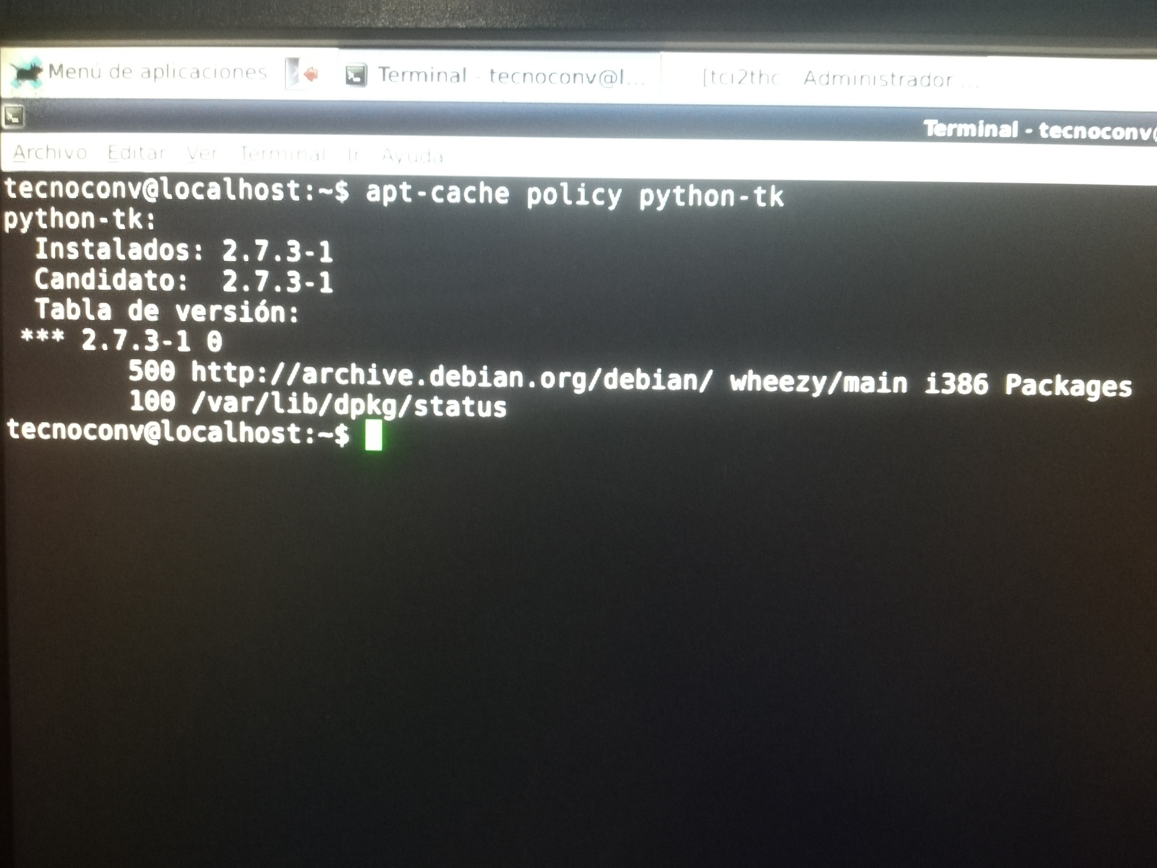

Could you open a terminal and report the results of:
apt-cache policy tk python-tkPlease Log in or Create an account to join the conversation.

09 Feb 2020 06:41 #156831
by edgemir
Replied by edgemir on topic Another plasma component...
this is the result , (at the moment i dont have internet in the working machine)

09 Feb 2020 06:43 #156832
by phillc54
Thanks, but you missed the tk before python-tk
