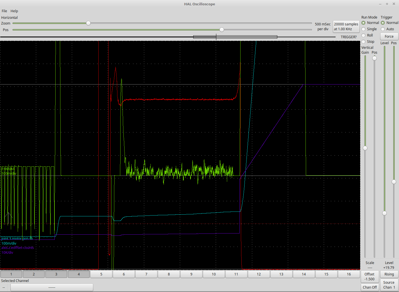

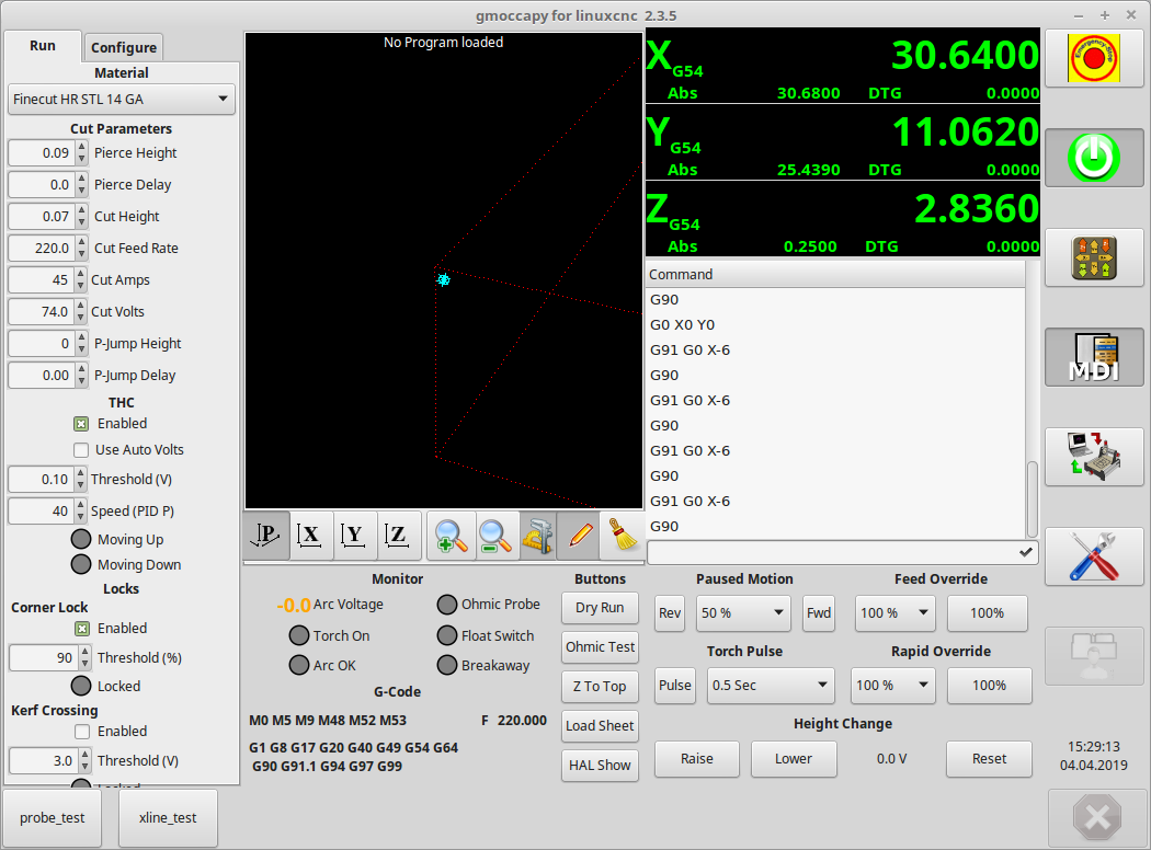

I managed to do a few (9) line tests today. The results were mixed. But first here is the test program:
O<xline_test> sub
G91
G0 X0 Y0
M3 S100
G01 X6.0 F220
M5
G90
(G01 Z 1.0)
O<xline_test> endsub
M2
This was launched as a MDI button from the bottom of the MDI screen.
I had a bunch of trouble using the dry run button (something I will never use in production work). It needs to show a change of state when it is active. Things got very confusing when trying to use it, most likely operator error. I had to shut down and restart gmoccapy to re establish predicable behavior.
While the probing test worked reliably on clean dry sheet things didn't go so well on a dirty wet one. Problems with the torch going down to the sheet surface with the Ohmic Probe LED coming on and then the torch just moving +/- .005" up and down by the DRO. The Ohmic Probe LED would sometimes briefly change state. It would do this until 30 second timer had timed out and then raise the torch.
The line tests proved less than reliable, the best I did was three in a row without a problem. Most of the problems involved some sort of probing failure. Sometimes the failure was as above but with a twist. Because there is no timer to force a time out the only way to stop the torch bouncing was hit the program stop button. At this point retries resulted in the same failure even after cleaning of the torch and material. The only way to recover correct operation was to shut down gmoccapy and restart it. On several tries the torch would move part way down and stop and fire well above the sheet surface. Stopping the program sometimes fixed the problem and sometimes didn't. Twice at the end of the cut the torch dove into the work piece only to raise up again. Once to the starting position and once into the upper limit switch. I expected the torch to raise to the safe height between cuts, some times it did and sometimes it didn't.
The good news is that THC appeared to work very well, I got the pgain up to 40 and the deadband at .1v and had no sign of oscillation and the height control was solid at the set point. The Z axis did not appear "nervous" at all. Halscope plots showed no sign of hunting or overshoot. The corner hold LED came on at the end of the cut as it should. I am very happy with how the THC works with the straight lines given the terrible time I have had previously with the EO branch. I now need to get a PP working for the plasmac branch so I can test with one of my normal pieces.
I don't know what I did but the configuration and materials files are now working correctly!
I need some guidance on what information I need to collect for you. I just don't have a good enough understanding of the plasmac component to do more than start looking a random signals.

05 Apr 2019 01:04 - 05 Apr 2019 01:28 #130322 by phillc54
And conversely I don't know enough about plasma cutting to know what questions to ask...
John, thanks for all your testing it is at least steering me in the right direction.
Could you increase the debounce.0.delay to 2 in plasmac.hal to see if that makes any difference to probing, you may need to slow the probe speed down a little to compensate for the extra overshoot.
EDIT: Actually if you have a floating head it may be worthwhile trying something like 10...
Cheers, Phill.
