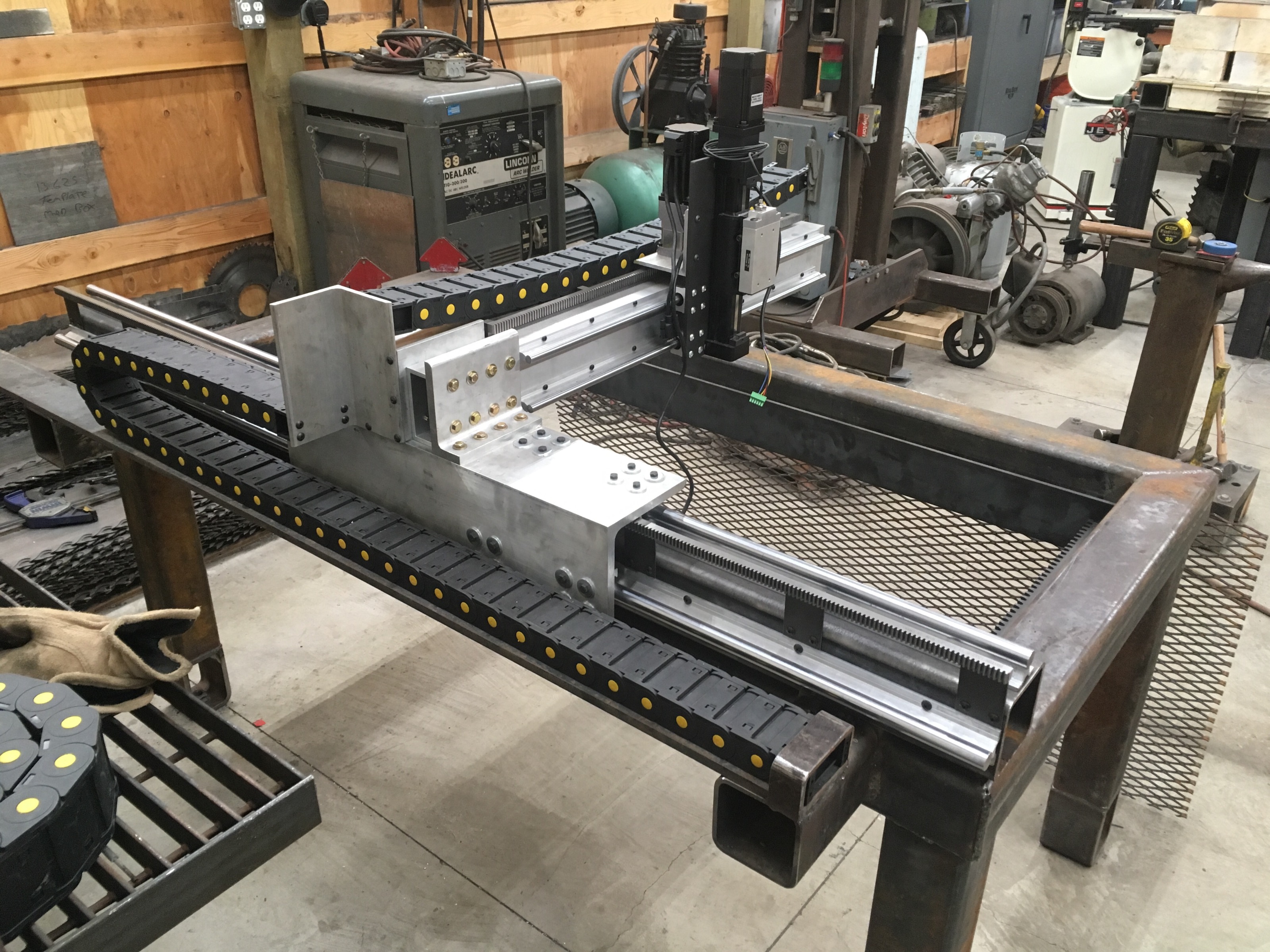

I have been holding off asking questions on here because I figured I should be able to muddle my way through it. Well I got everything installed and everything seems to have worked. Also it seems that zero stray cats where installed which in guessing is good lol. But I have come to a point where I'm kinda embarrassed to ask for help. How do I run this new fangled thing-a-ma-bob? In the home/user folder I have a folder that says LinuxCNC and LinuxCNC-dev. I'm guessing the LinuxCNC is from my previous install. I dug around the dev folder buck can't see anything to run. If I open a comand prompt and type LinuxCNC it looks like my standard cnc that opens. I dig around in the samples listed and can't find anything named like the screen shots posted on the first posts by the OP. Thanks guys - JT
My plasma table is on the cusp of being completed so I figured why not test it with the new stuff you guys have been slaving over.

No need to be embarrassed. we are here to help. So it sounds like you have installed the linuxcnc as a run in place (RIP) system and you also have an earlier installed version.
So by default, all of your path variables will be pointing to the earlier installed version. So open a terminal window and navigate to ~/linuxcnc_dev folder then try typing
There is a good tutorial here which describes this:
www.wiki.eusurplus.com/index.php/LinuxCNC_Run_In_Place
note the dots before the first slash. that is important
So you should now open the compiled version.
If you have not yet compiled plasmac, you can make a new folder ~/plasmac and follow the instructions to compile again except connect to Phill's git, not linuxcnc's
Good looking machine!
EDIT: what you are doing is setting the runtime environment variables to look in the ~/linuxcnc-dev folder as all of the RIP executables are in that folder, not installed in the system folders as is the case with the standard install. Al all errors should get printed to the terminal window if you stuff something up.
