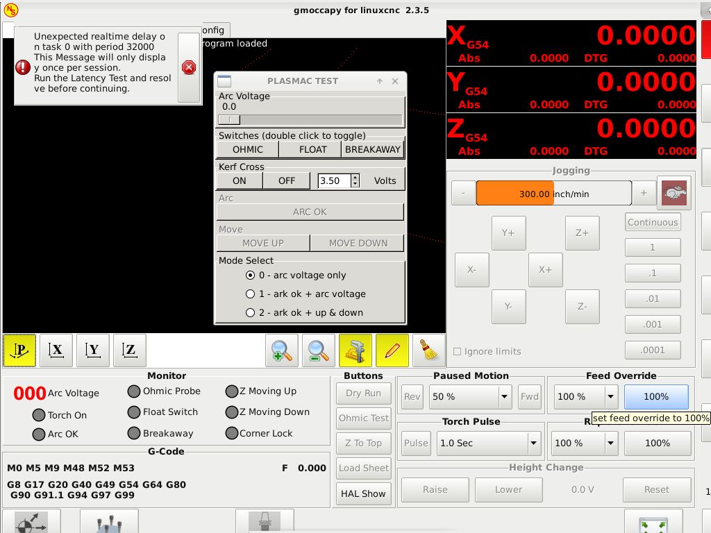

15 Apr 2019 17:47 #130910
by JTknives
Replied by JTknives on topic Another plasma component...
I would also like to have a torch disable function to fit parts onto already cut sheets.
On a side note I think everything worked and I can now load plasmac sim. when I do I get this and I cant close that top test window. I don't know if thats a feature of the sim but I can move it around. Now how do I move forward from here and go from using a sim to an actual controller?
And I figured out how to do screen shots lol

15 Apr 2019 18:00 #130911
by islander261
Replied by islander261 on topic Another plasma component...
Do you have working .ini and .hal files that move your mechanics correctly? If so post them.
I will give complete instructions later when I am finished with the days work.
John
