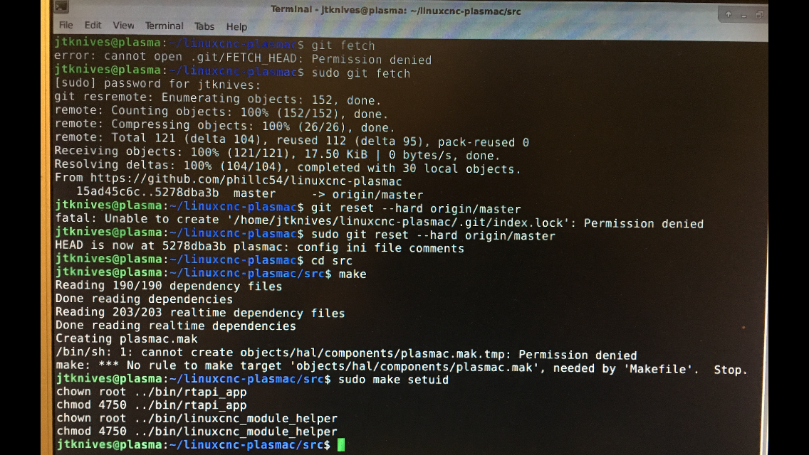

13 Apr 2019 22:35 #130795
by islander261
Replied by islander261 on topic Another plasma component...
Ok
First we need to make sure we are working with the same versions of files.
In a terminal go to your plasmac directory ( the place you originally cloned the plasmac branch).
If you can't get this to work post terminal text or screen shot.
John
git fetch
git reset --hard origin/master
cd src
make
sudo make setuidIf you can't get this to work post terminal text or screen shot.
John

13 Apr 2019 22:58 #130796

jtknives@plasma:~$ . linuxcnc-plasmac/scripts/rip-environment
jtknives@plasma:~$ linuxcncIt does matter where you start from. Same as your last post, copy and paste terminal output into message. And I will get back ASAP.
John
- Posts: 21897
- Thank you received: 7465
14 Apr 2019 00:06 #130802
Replied by tommylight on topic Another plasma component...
It looks like you ran the make with sudo the first time, you have twice in the log files "permission denied".
I do not know how to fix that, maybe someone else will chime in.
