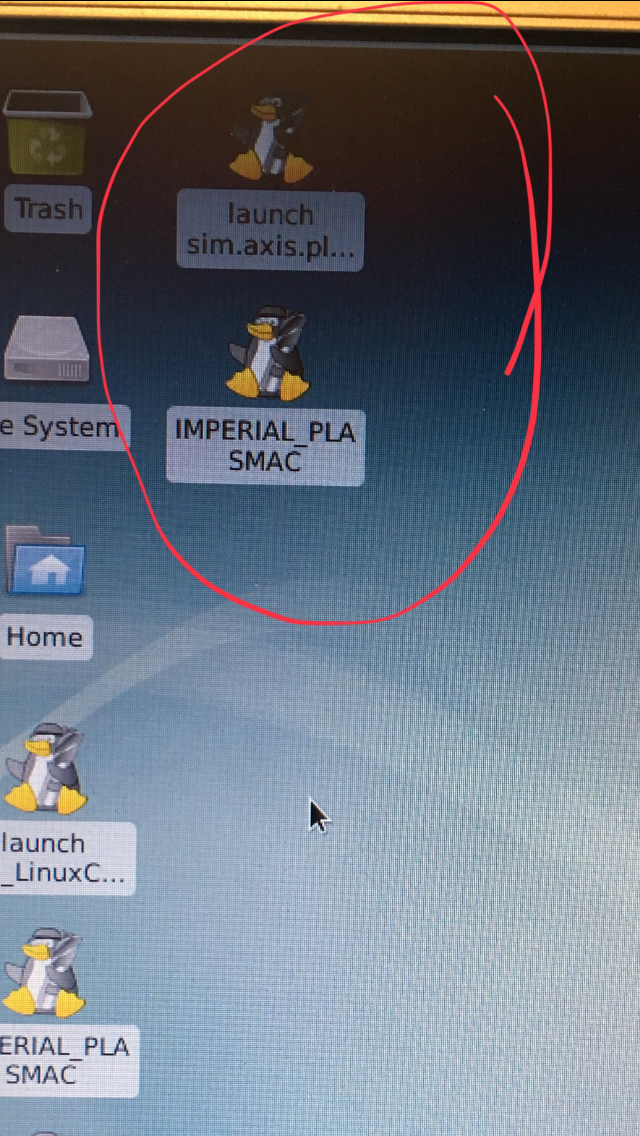

13 Apr 2019 16:50 #130780 by JTknives
Replied by JTknives on topic Another plasma component...
I think I'm closer but still getting errors. I now see the plasmac when I run LinuxCNC from a terminal. I select imperial from the axis sim But it Fails. I then open pncconf wizard and point it to the new folder in the config folder. I run through that and save. Then I look for the Hal file with the address and change that to 10.10.10.10 but still errors out. Not sure what I'm doing right or wrong.
13 Apr 2019 16:56 #130781 by JTknives
I'm half tempted to just erase everything and start over. At least remove linux cnc and just install this version. I think half my problems is having multiple versions installed. How would I get all this off so I could start from scratch.

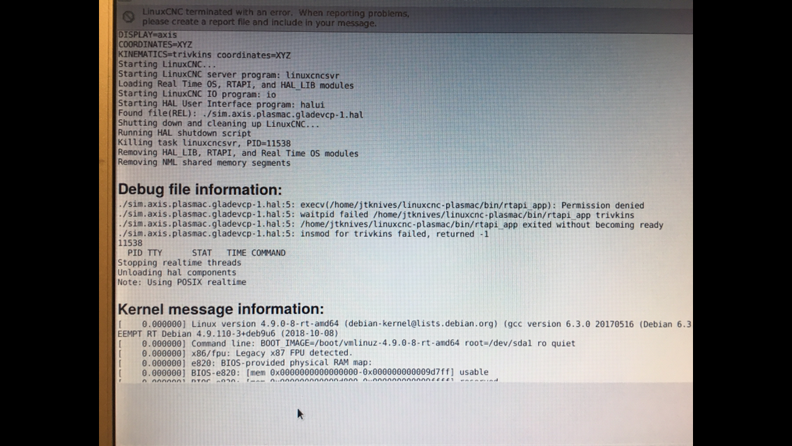

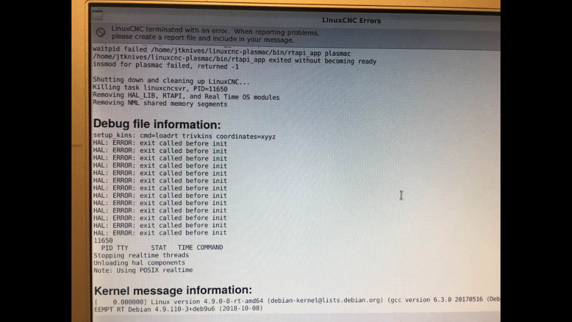

13 Apr 2019 17:26 - 13 Apr 2019 17:29 #130783 by JTknives
This is what it shows when I try and run the 2 icons I have circled.
Last edit: 13 Apr 2019 17:29 by JTknives. Reason: Add pictures
