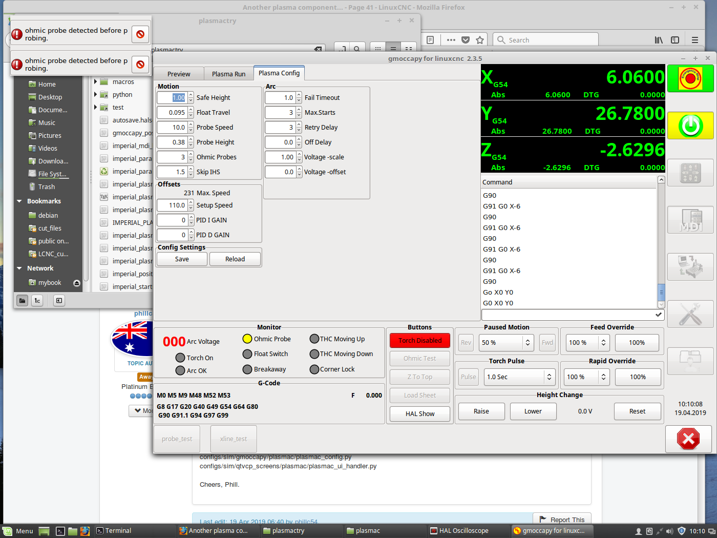

19 Apr 2019 18:20 - 19 Apr 2019 18:30 #131253
by islander261
Replied by islander261 on topic Another plasma component...
Phill
I tried to test the latest release and couldn't get the probing to work correctly while doing static testing. Both the ohmic and float switch probing did the same thing except for displaying the appropriate error message. I was using my probing test program that activates the plasmac.probe-test pin to start the probing. What happens is the probing starts with the torch at machine Z0 (G53 G0 Z0) which is near the top of the Z travel on my machine. The torch lowers at the Setup Speed until it contacts the material surface activating either the ohmic probe or float switch. The torch motion stops and the appropriate error message "... detected before probing." is posted to the screen. At the end of the test delay (to give time to check actual physical height when things work correctly) the plasmac.probe-test pin is de-asserted and the torch returns to machine Z0. Please see attached screen shot and code.
I also found this in the terminal that I have never seen before:
John
RUN
IDLE
No option 'offset_axis_z' in section: 'DEFAULT'
(<__main__.gmoccapy object at 0x7fc409b3a2d0>, <Dialogs object at 0x7fc3f57b9f00 (Dialogs at 0x1fd5c20)>, 'alert')
('MDI Mode', False)
3 2
RUN
ohmic probe detected before probing.ohmic probe detected before probing.
/home/jd/plasmac/lib/python/gmoccapy/notification.py:168: GtkWarning: Invalid icon size 48
self.popup.show()
(<__main__.gmoccapy object at 0x7fc409b3a2d0>, None, 'error')John
Last edit: 19 Apr 2019 18:30 by islander261. Reason: Added terminal output.

20 Apr 2019 02:37 - 20 Apr 2019 03:52 #131267
by phillc54
John,
I have just finished setting up my test rig in a similar configuration to yours and haveno problems with probing.
Yay, I can now do macros in Gmoccapy and I also learnt (after much hair pulling) that you cannot have a ngc file in the ncfiles directory with the same name as one you are trying to run from the config directory...
Is it possible that the 0.38 probe height is actually lower than the surface you are probing to.
Probe height is the distance above the Z axis minimum limit.
Cheers, Phill.
EDIT: I just 'cleaned' up my configs and had the same error...
Cheers, Phill.
Last edit: 20 Apr 2019 03:52 by phillc54.
- islander261
- Posts: 757
- Thank you received: 216
20 Apr 2019 04:01 #131273
by islander261
Phill
Thank you, now that I know how it is supposed to work the correct .ini values fixed everything. I will try and test tomorrow.
John
John
