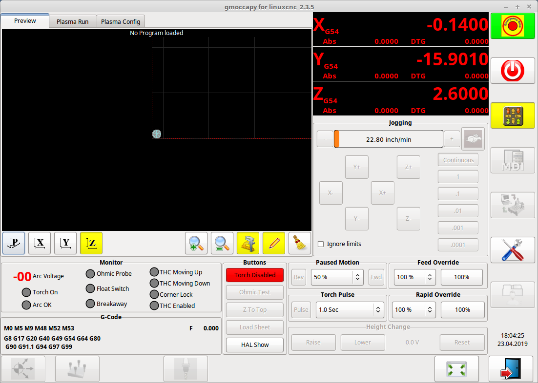

24 Apr 2019 01:06 - 24 Apr 2019 01:07 #131727 by islander261
Replied by islander261 on topic Another plasma component...
Phill
Sorry, bit of a brain **** last post. Here is my current screen.
John
