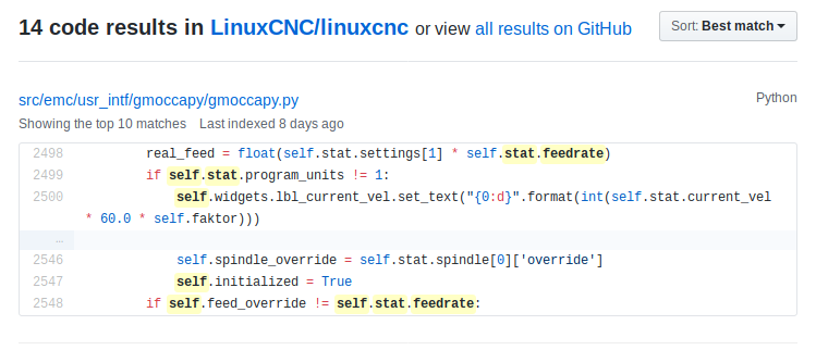

islander 261 wrote:
The feedrate displayed on the Gmoccapy active Gcode and feedrate frame only intermittently updated to current feedrate. I couldn't detect any pattern to what was going on but I was seeing the correct speed with a halmeter but the wrong one on the UI and then sometimes it was correct.
I see the same here, it appears that it may be a Gmoccapy thing as the velocity display in Axis works fine. It doesn't seem related to timing as the DRO's seem to update ok.
Cheers, Phill.

I looked at the Gmoccapy Glade file and Gmoccapy python handler and it looks like it gets the current feedrate from self.stat.feedrate which is hooked to the LinuxCNC internals some how. Part of this code is well beyond my limited Python and LinuxCNC internals knowledge. Are you sure the remap of the F blocks doesn't mess this up some how? I do know that on my system the displayed F block is always the last non zero one and usually follows the F block in Gcode closely.

it's from self.s.feedrate (if feedrate status exists... check by man page)
Jes, it exists : . linuxcnc.stat attributes => feedrate (returns float) - current feedrate override.
Why override? Did we ask for this? The comment is not so carefully made for "override".
source is then self status channel.
The self.status.feedrate command will work also in Gmocappy source code
Multiple (re)definition's of this can be done in the same source file i think without concequences.
