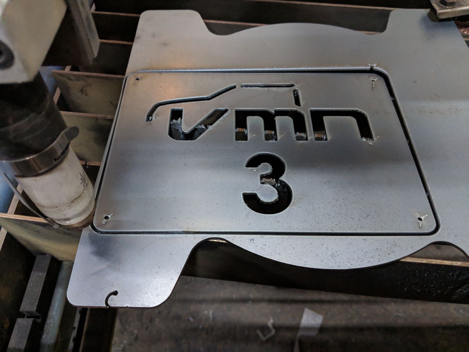

Yes, I am away and cutting! Now I've found the G54 offsets in Gmocappy. I've just put the Z offset in there
I still don't understand how to set G54 offsets from Gcode.
Anyway, I needed a unit number to put on the building So I've got this sandblasted and am waiting for the paint to dry... I cut this once before but the torch dragged on an earlier config as I did not have Ohmic sensing.... Very cool thanks Phill!
So next will be real parts.
