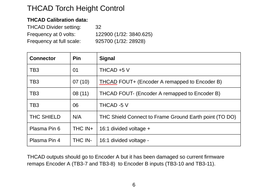

30 May 2019 06:41 #135363 by rodw
Replied by rodw on topic Another plasma component...
Speaking of barebone config, the last hal component I need to hook up is the torch voltage. I'm running a 7i96 and a thcad10. What lines do I need to get the thc hooked up? Right now the only hal config I have in regard to this is
net plasmac:arc-voltage-in hm2_7i96.0.encoder.00.velocity => plasmac.arc-voltage-in
But it's just a placeholder to get the config to load until I figure out what it's supposed to be. All I know is i'm to wire into encoder A and somehow calibrate with the sticker on the back of the thcad card. I know the THCAD manual has a simple formula for converting the frequency to voltage with these calibration figures, but when I was looking through plasmac.comp I didn't see where I use these.
I disagree with Phill here. you don't need to put a voltage on the input as you have the calibration data from mesa so you know what it will be reading at 10 volts.
Make sure the board is set to 1/32 divide mode on the link on the THCAD. Divide both values on the board by 32 and write them down. Work out what will be the actual volts indicated. Say you have a 30:1 divider and full scale frequency is 28000. 10 volts x 30 = 300 volts. So your scale is 300/28,000 = 0.0107 and your offset will be 1/32 of the 0 volt frequency you wrote down earlier (probably around 3800)
The 1/32 setting is better for LInuxCNC's servo thread speed and allows more accurate sampling by the THCAD via some kind of averaging algorithim in the chip.
30 May 2019 07:33 #135366 by rodw
I must be missing something. plasmac.arc-voltage-in voltage-out, as well as hm2_7i96.0.encoder.00.velocity don't show anything, all zero.
Here is my THCAD connection pinouts. Ignore the numbers in brackets. Theu are specific to my machine
The following user(s) said Thank You: AgentWD40
30 May 2019 07:37 - 30 May 2019 07:42 #135368 by AgentWD40
Replied by AgentWD40 on topic Another plasma component...
Thank you rod, I actually found your pinout chart a little while ago. That's when I decided I better use the frequency divider.
Anyway, I figure troubleshooting my THCAD may be getting off topic here. I've posted some more info over here: forum.linuxcnc.org/27-driver-boards/3659...6-and-thcad?start=30
