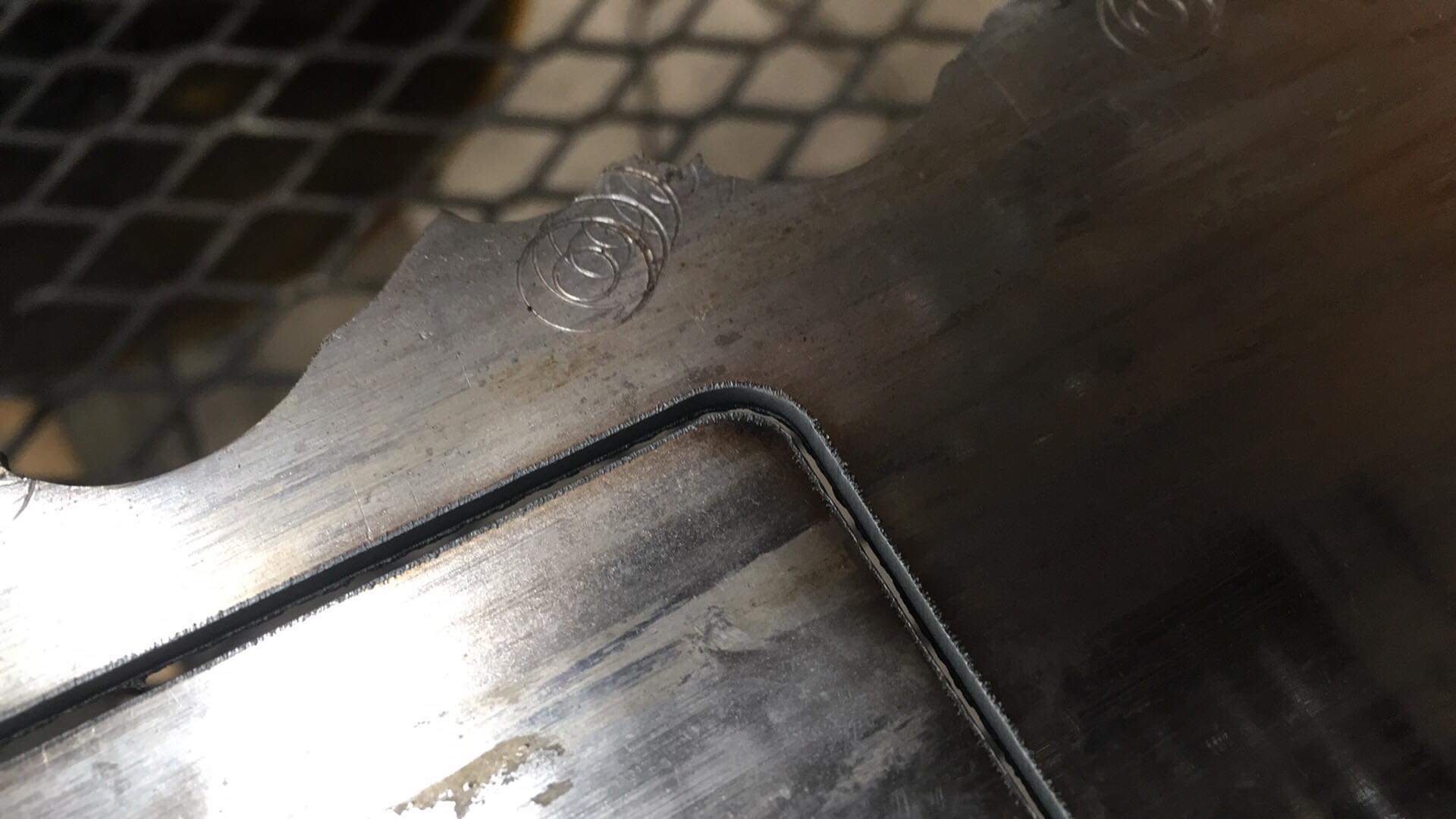

Anyone know why it would start cutting round corners. I was cutting sheets out and stopped to run to town. Came back and I tweaked some cut speed settings. And it started doing this. I don’t have a G02/G03 any where in the program. I closed LinuxCNC and still doing it. I also dropped cut speed to 50%. I changed feed rate from 100in/min to 200 in/min in the program file. This also brings up another weird thing. It seams to be running off the feed rate in the program not the feed rate set in the settings. And sometimes it’s still not using the THC. It touches off and just takes off but never adjusts the Z.

My guess is that you are not setting your G64 correctly. Look in the docs!

All my machinest experance centers around lathes and mills. I am quickly realizing plasma is a diffrent beast. I have never used G64, I will play with it.

John has set you straight on the rounding. When I first got my table moving, I drew a large square at maximum speed and it rounded the corners by many inches. So i put it in the startup code (which in plasmac's case is in a .ngc file in the config directory)
If you have feed rates in the gcode, they will be used. To use the one set in the plasmac gui, you need to add
M190 Pn
M66 P3 L3 Q1
F#<_hal[plasmac.cut-feed-rate]>
M3 S1
where Pn contains the plasmac tool number. If you have a lot of tools (50 or so), you might need to increase the Q1 to Q2

Rod is on the right track here but you do not have to use the M190 and M66 lines, they are only used if you are specifying material numbers. You could omit these and it will use the parameters of the currently displayed material. You do need the F#<_hal[plasmac.cut-feed-rate]> if you want to use the displayed materials cut feed rate. If you specify a feed rate in gcode say F2000 then if that is less than 99.9% of the displayed materials cut feed rate then cornerlock will stay locked because the machine will not reach the displayed materials cut feed rate.

Have a look in imperial_startup.ngc, I have specified G64 P0.04 (1mm), it should have been 0.004 (0.1mm) it is correct in metric_startup.ngc.
