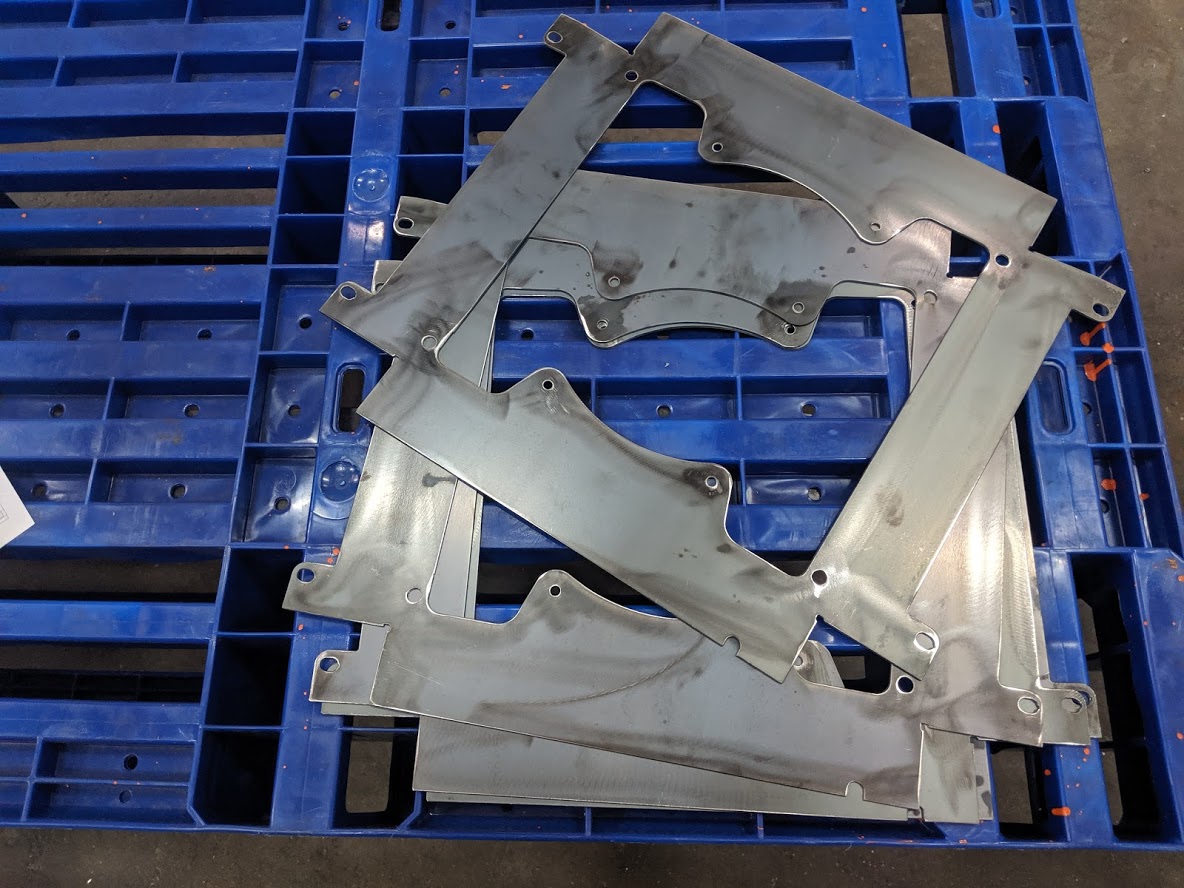

John thanks. I just ran a flap disk over them. There were some burrs where I drilled holes that needed to be cleaned up as well. I'll give a wire brush a go.

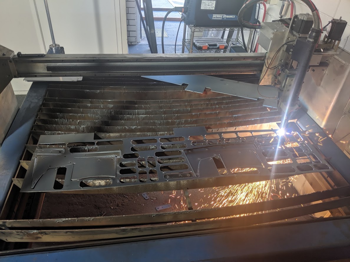

I did a fairly busy nest in sheetcam today to clean up an offcut
I'm not sure what happened here.

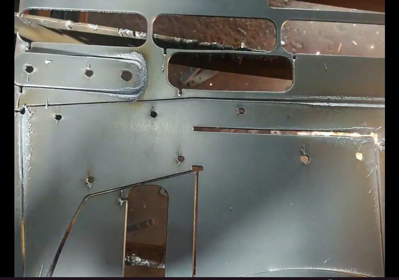

This was near the beginning of the cut and the edge warped up about 40mm while cutting. I wondered if the air pressure was too low or something. I'll remember to purge the air line with the torch pulse function next time. Managed to work out how to nest parts in sheetcam inside the flange cutout. So much to learn.

@Rod,
For your previous post 29 of may post nr. 135227.
My advise for you is to use the code snipped ( on circles and small shapes ) to lower your speed
to 50-70%. Sheetcam lines will turn from green to blue where the code snipped is active.
This will result in more accurate holes and small shapes. At the moment you go to fast i see at the picture.
The post after this 29 May 2019 08:39, i marked up your plate allignment of plasma cutting is wrong in relation to the working table.
Always try to cut the long pieces the other way. Try alway's to cut the long pieces over the metal strips 90 degrees.
See this as your nesting protocol !
And in the end. Why don't you have a water table? This will end in a much more accurate product.
