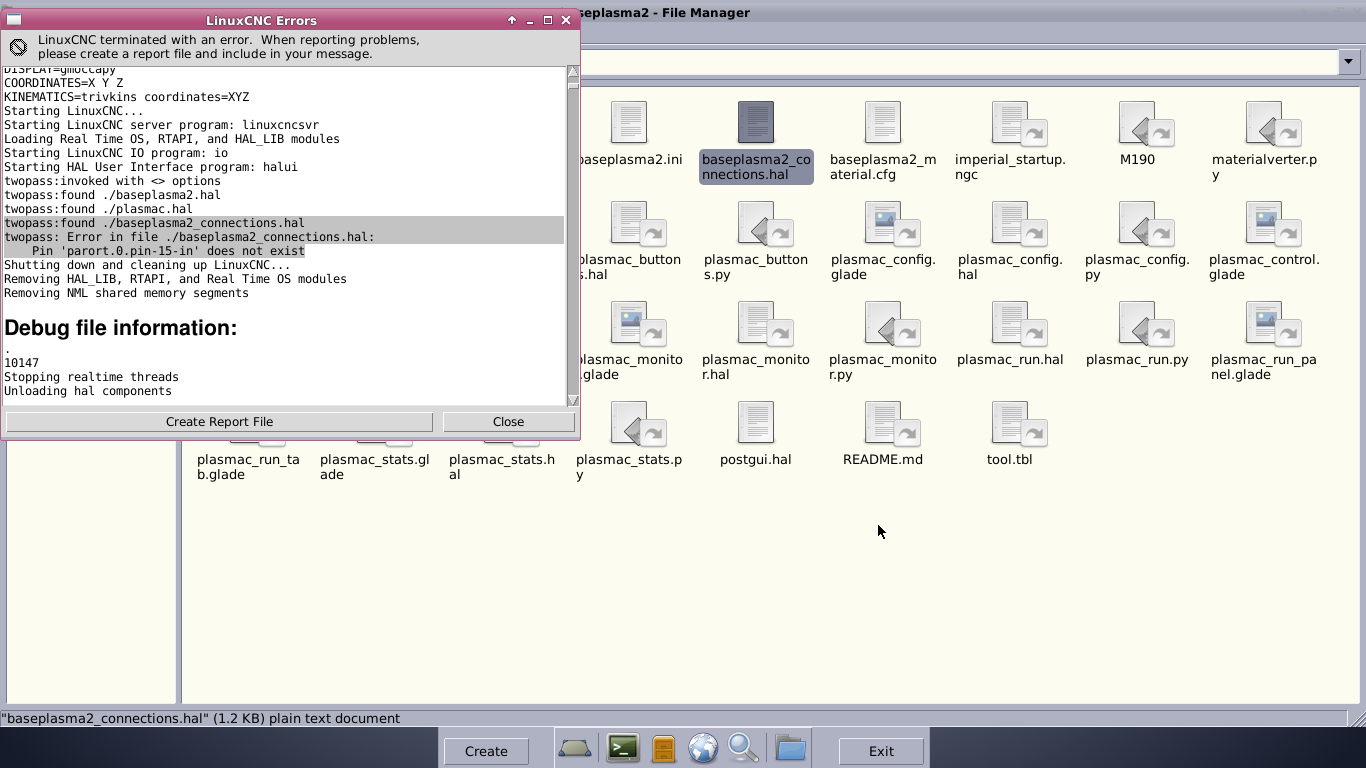

So now you have connected it to a pin that does not exist on your parallel port so it cannot work.
My recommendation would be to forget about plasmac for a while and revert to your base config. Use halshow (show machine configuration) from the axis menu. Explore the pins that are available on the parallel port and note their names and write them down. Then run plasmac's configurator and ensure valid pin names are used (same as halshow) and ensure inputs are used as inputs and outputs used as outputs.

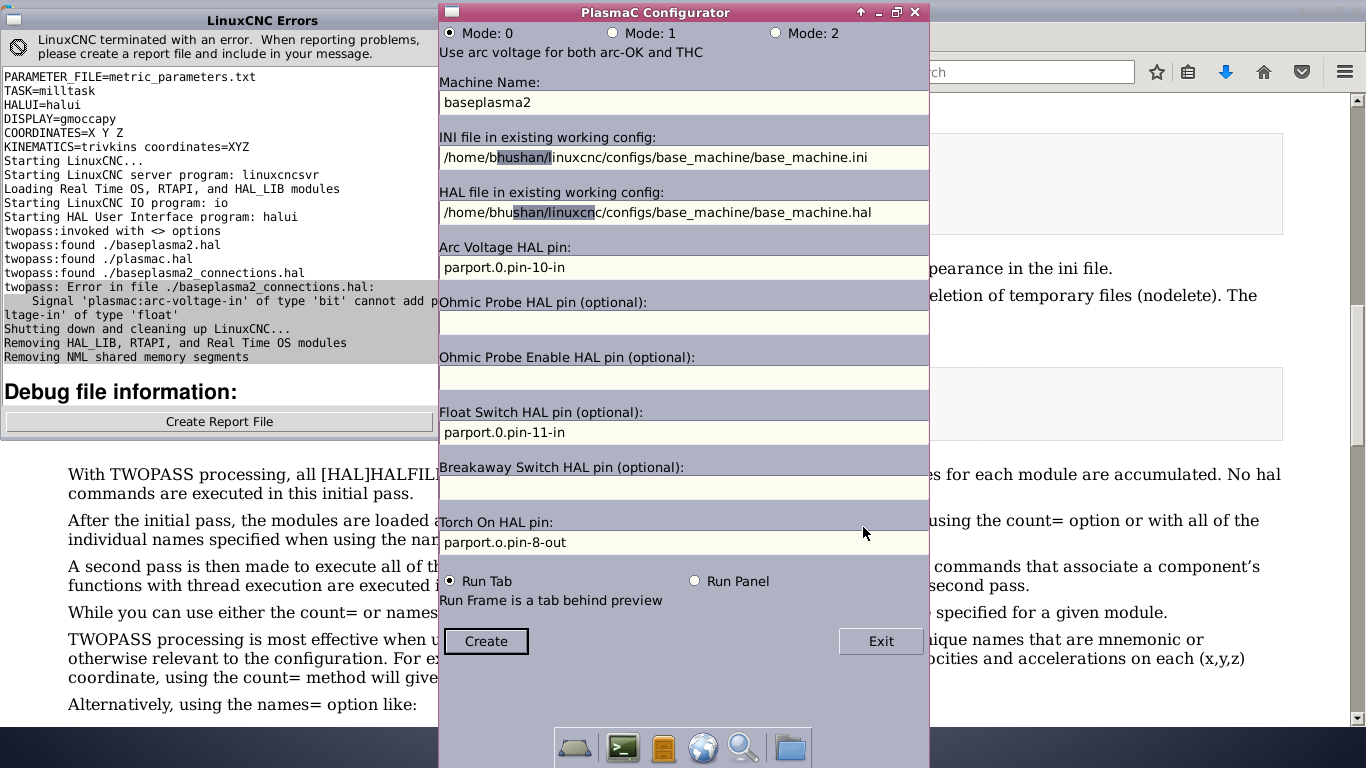

The plasmac.arc-voltage-in is a HAL FLOAT and you are trying to connect a pin which is a HAL BIT
Edit: Just comment out that line for the time being.

Look at the Types on this page linuxcnc.org/docs/devel/html/hal/intro.html#_hal_concepts

And this also has been answered already.
If you indeed have a frequency input on pin 10 you will need to add an encoder
component in LinuxCNC and use that to convert the input frequency read on
pin 10 to a number (via the encoder components velocity pin ) that
you _can_ connect to plasmacs arc-voltage-in
Edit:
Also if you have a _working_ non-plasmac config, I would encourage you to make a file
of all available pins so you do not have to guess at spelling, types, directions etc:
To do this, type this in a terminal window when LinuxCNC is running with your working config:
halcmd show pin > mypins.txt
You can now use the text file mypins.txt as a reference and "donor" file for copy pasting pin names

I have just realised that in one of your configs you are using Mode 0 and in another you are using Mode 2 which is the correct one?

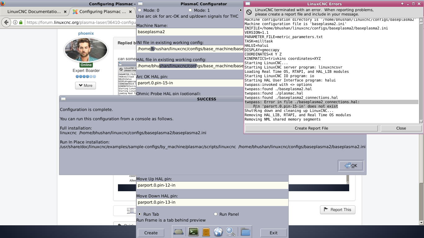

i tried all three modes and not a single one works
i get it if i want to use mode 1 or 2 i need an encoder
but when using mode 3 it say twopaas error even when i have twopaas = on in my hal section
and it also says MY ARC OK PIN DOES NOT EXIST no matter if its 15-in or any other pin

If you look carefully at the last error message you posted it says parort which should be parport.
