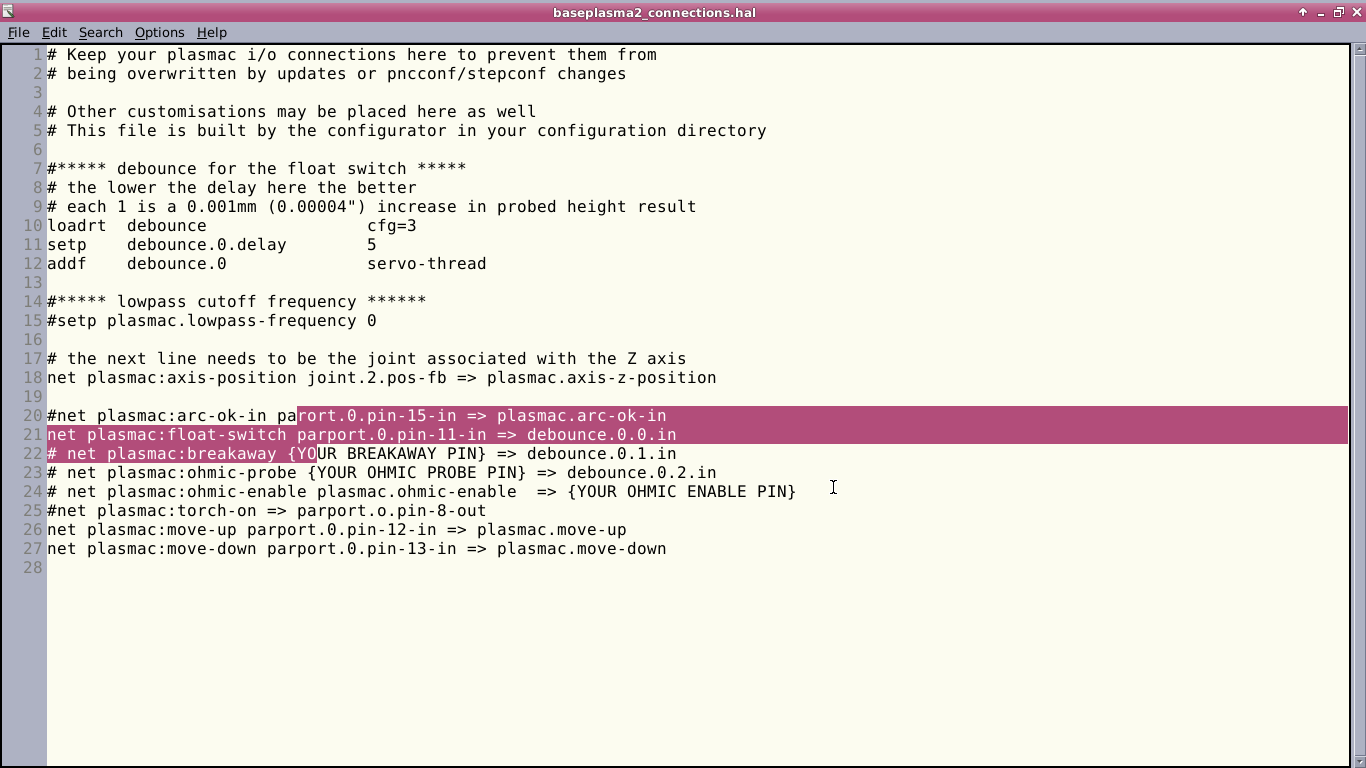

opps yeah you are right that was indeed a silly mistake but correcting it doesnt chnage anything
at last i have to comment out my arc ok and torch-on pins and finally it runs
but as soon i uncomment them it says pins 8 out not found or 11 i not found

21 Jul 2019 12:06 #140067 by phillc54
Replied by phillc54 on topic Installing PLASMAC - Another Plasma Component
For the torch on you have lower case O instead of zero
