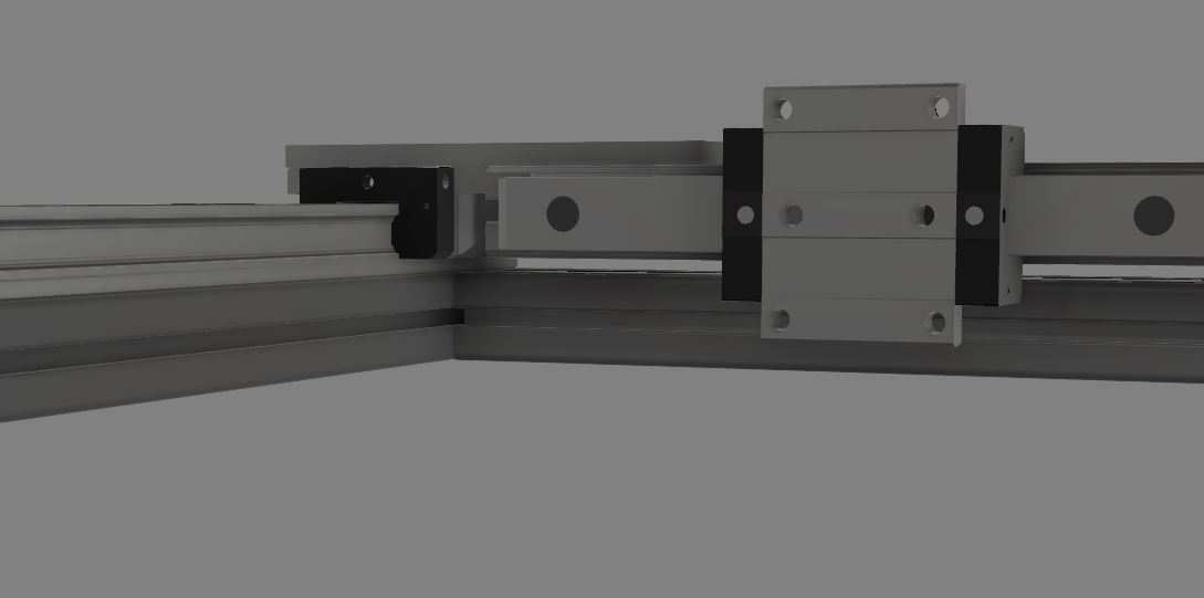

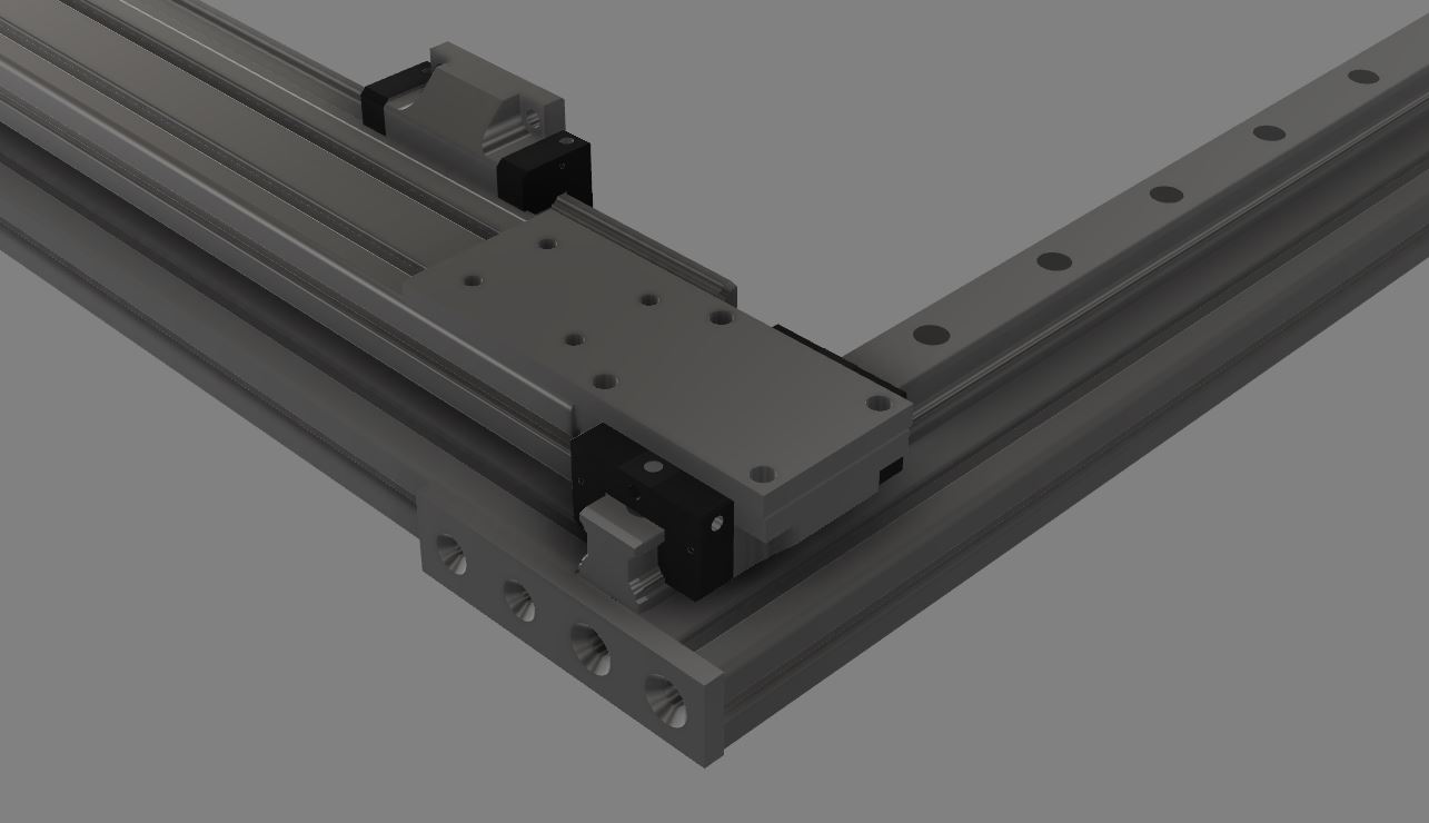

Thanks for the tip, will take that in designing the main stand with eventual waterpan and grating or whatever it is called.
I assume that amount of warping occurs on very thin materials?
- Posts: 21901
- Thank you received: 7465
26 Jun 2019 23:19 #137940
Replied by tommylight on topic Low budget plasma setup, what do I need?
If you plan on using water table, it will have to be more than 50mm above, then again without water table it should also be more than 50mm. The dust from cutting ( or water ) can easily reach 100mm or more, that is very fine dust that will end up on those rails and soon enough it will make them lock due to tight tolerances.
If at all possible make the table at least 200 to 250mm above cutting surface, make the torch holder so it can be 70 to 100mm above cutting surface. That is easy to do and it will prolong the life of the rails a lot. One carriage is enough to hold the torch and floating head and cables, and a lot more.

Also to add to what Tom said,
The torch airflow will be left on for a period after the torch has been fired. This causes water to be sprayed all over the place from the airflow.
I would allow a min 100mm for the torch to be parked about the water level at the end of a cut.
