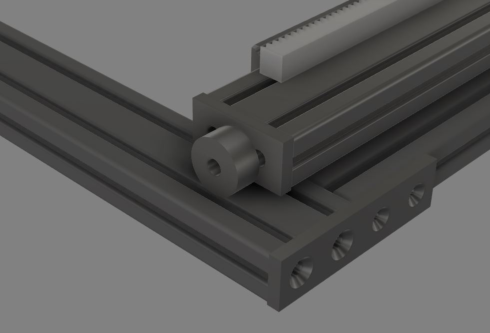

depending on Y length i thik the wrong Side of the Y bar used will bend as it is made for Wx WY use and in this setup i see it is the Force in Wz of the bar so not the best way to go
is it a 45x90mm bar we taking in Y or smaller and what is the max width between the X fix rails
to get a calculation on
if a Mechanical touch off is used i think it wil ltroubel

Profiles are thick wall 80 x 40 1400mm long + 800mm so the opening is 1240 by 800
This will give me plenty space to cut 1000 x 500 plates
Linear rails are 35mm for R1651 linear guides
The *arm* is 800mm long and supported with ball bearing so X is only with one rail.
So you are worried about torsion force on this arm, I can make the open arm to ride on two bearing well apart to counteract this if needed. I am not particularly worried about this as the load is not so high.
A secondary linear rail is easily fixed if needed on the other side but for now it will have to do with only one side.
