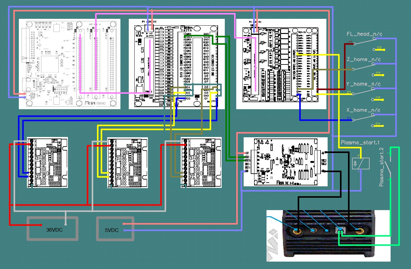

- tecno
- Posts: 1850
- Thank you received: 127
25 Jun 2019 09:56 #137780
by tecno
Replied by tecno on topic Low budget plasma setup, what do I need?
- Posts: 12161
- Thank you received: 4151
25 Jun 2019 10:21 #137782
Replied by rodw on topic Low budget plasma setup, what do I need?
There is nothing to connect for the pilot arc, thats handled by the machine. Sorry but I don't know enough about the cards you are using to comment on anything else.
5 volt logic level seems low to me as I'm used to working with 24 volts, I hope its not affected by noise.
- tecno
- Posts: 1850
25 Jun 2019 10:31 #137785
by tecno
Is ARC OK to be setup somehow? Is some sensing device needed?
- Posts: 12161
25 Jun 2019 12:20 #137795
I think you might be able to synthesise ArcOK by monitoring current on the material clamp lead. You may have luck with a slotted ferrite ring with a hall effect sensor glued into the slot placed around the cable. I did make one ages ago but my plasma died so I never used it in anger to know if it worked.
But you might just use the correct mode in Plasmac which sets a voltage threshold for ArcOK for those machines that don't have a signal.
The following user(s) said Thank You: tecno
