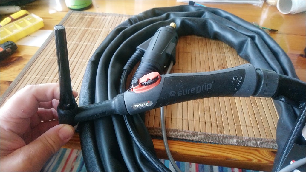

20 Jun 2019 19:07 #137411
by tecno
The welder/plasma has landed today
Initial TIG test looks OK
The new Parker torch with current adjustment is very nice, now I need some hours of testing.
Replied by tecno on topic Low budget plasma setup, what do I need?
As suspected = NOTHING
So now I have decided to step up a notch and as my primary goal is a AC/DC TIG with decent functionality such as low Amp start for very thin material.
This is what is on its way to me tiny.cc/04c07y
Built in 50 Plasma with Pilot Arc
