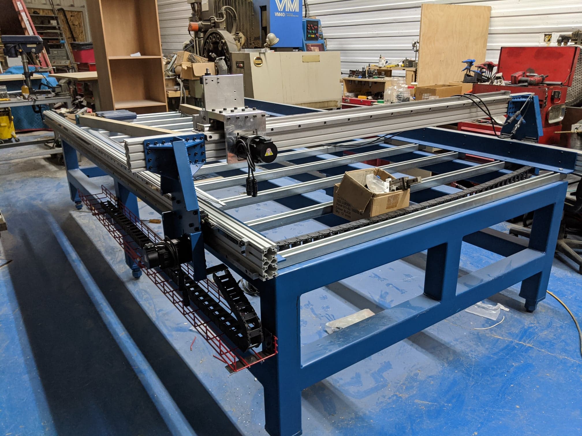

Looks awesome. How long is that gantry ?

I have to put float bearing then torch plate. USe magnets, and he wants to do 45 degree angle cuts. So I will add a wedge so he can just remove the torch, stick the wedge (with magnet) and stick the torch plate( with magnets) on.
Sounds nice theoretically, I don't know how well it will work though.

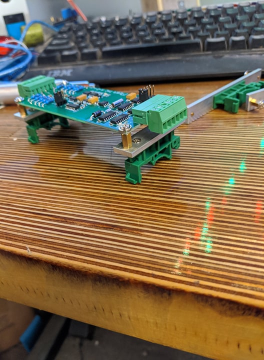

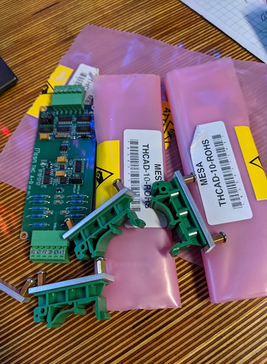

Here Bob, A couple of DXF's for you to mount THCADS on a DIN rail (single and double). Looks like you might need them.
Designed to use a Meanwell metal Din Rail mount.

I already have a thcad. I am working on two plasmas.

I bought din rail mounts from JT..... I'll take a look at them though.

Yeh but the THCAD has a different pitch between holes so JT's mounts won't work with the THCAD...Hence my plasma cuttable templates but heck I'm sure you can make do with a router for now! I used 1.6mm Ally sheet metal.

He has some specific for the thcad.

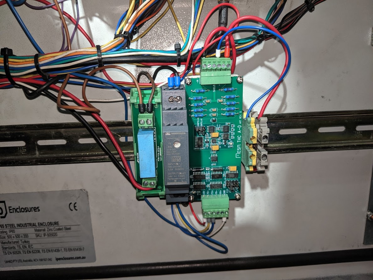

It seems the difference between JT's and my DXF is that his is very expensive in terms of the DIN rail they use.
If you cut the mount and used one of those clips to mount the plate, you would run the THCAD perpendicular with the rail
This layout makes more sense to me.
Replied by rodw on topic Bob's Plasmac Build
