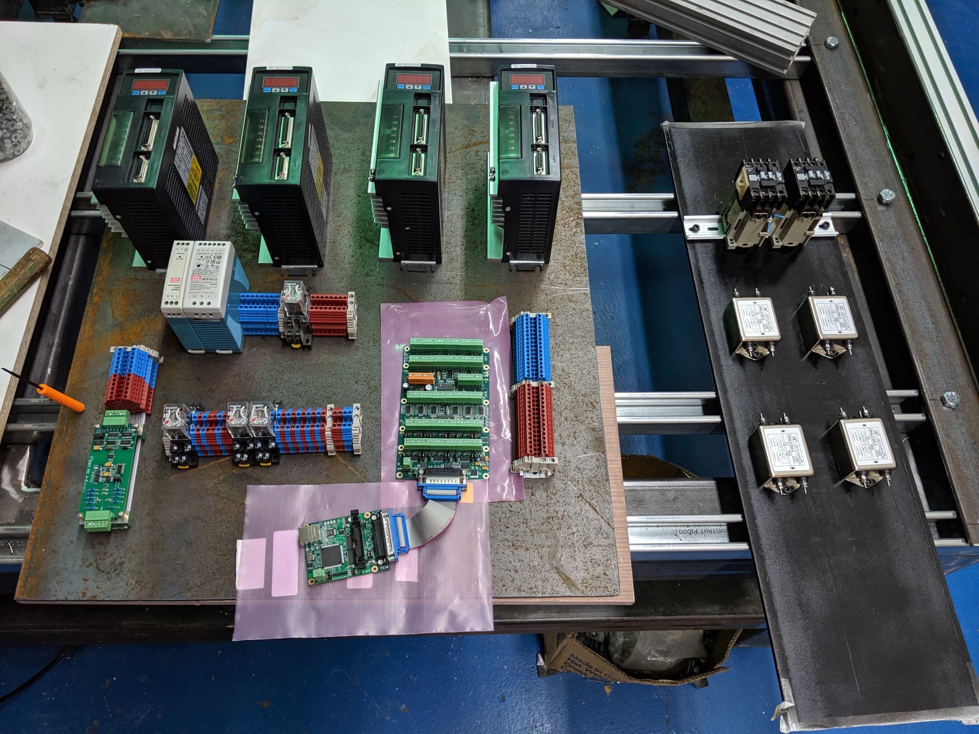

16 Jun 2019 19:56 #137057
by bevins
Replied by bevins on topic Bob's Plasmac Build
- Posts: 12156
- Thank you received: 4149
16 Jun 2019 20:17 #137058
Replied by rodw on topic Bob's Plasmac Build
Looks good Bob. I wonder if its worth going with opto isolated relays rather than mechanical ones? I used the ones you have there and replaced most of them when I added ohmic sensing (becasue I had to by a pack of 5). The only one left disables the stepper drives on estop (Just becasue I've been lazy but I have the part here.).
- bevins
- Posts: 1947
- Thank you received: 338
16 Jun 2019 21:16 #137060
by bevins
Oh yeah. I forgot about that. I have a boatload of these already. I will use the optoisalator ones for the ohmic sensor and the I/o for the plasma. I always use two to follow machine-is-on for enabling drives and such. One for estop logic.
Good point. Thanks.
Good point. Thanks.
- bevins
- Posts: 1947
16 Jun 2019 21:18 #137061
by bevins
Also forgot panduit. Need to leave room for that.
- Posts: 12156
16 Jun 2019 21:41 #137062
Somewhere PCW suggested using the 7i76e Spindle on contacts for torch on which might save a relay. Of course that was after I built mine relay and all! I'll save it for when I run out of outputs!

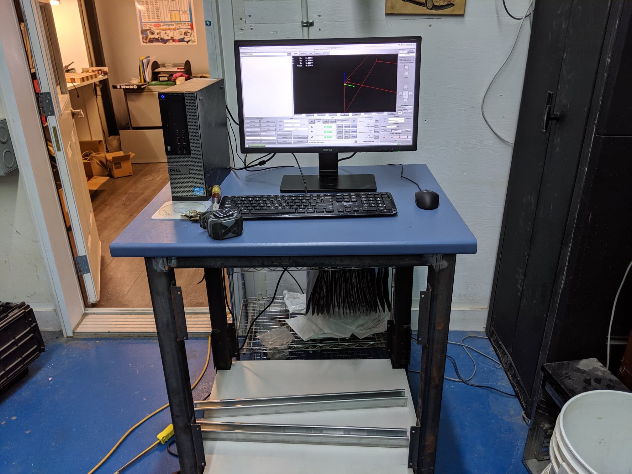

16 Jun 2019 22:55 #137070
Replied by tommylight on topic Bob's Plasmac Build
Bob, I think I already mentioned it here somewhere, the client I built the rotaray plasma ( links to YouTube videos in the show your stuff section of this forum ) requested a 6X2meter cut area so I do have to leave some room and that makes it at least 7X2.5 meters. Chasing unicorns, or 7m rails !!!
Rod, I would highly suggest not using the spindle on directly wired to a plasma cutter, I am sure it is OK in most cases but I have seen a fair share of manufacturing cost cuts in all sorts of equipment.
Oh and Bob, you've been holding on us, what is that on the monitor? A new screen, or did I miss something somewhere???
