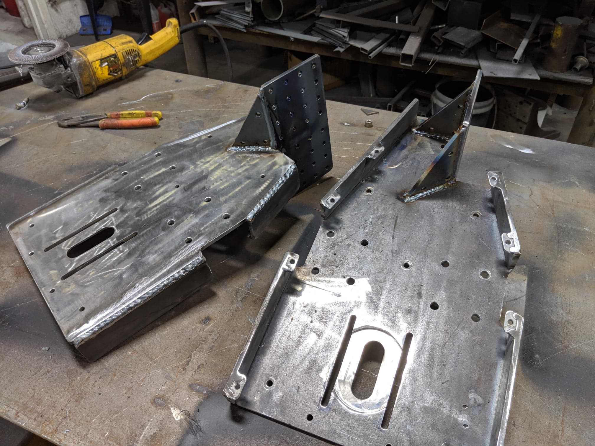

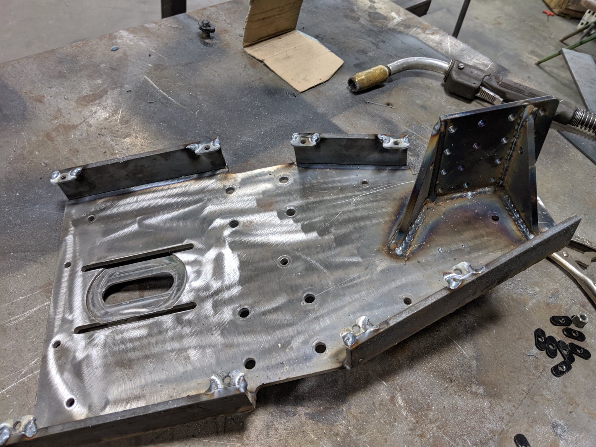

I am using 1/4" steel. I am not done as I am putting ribs on the uprights so they should be plenty rigid enough.
These servos I dont think will need reduction. It is right on the border so we will see. If it does there is planetary gearbox fits right on shaft and mount for the servos, so thats my backup plan.
The gantry will weigh less than 80 lbs so the servos should have enough torque.

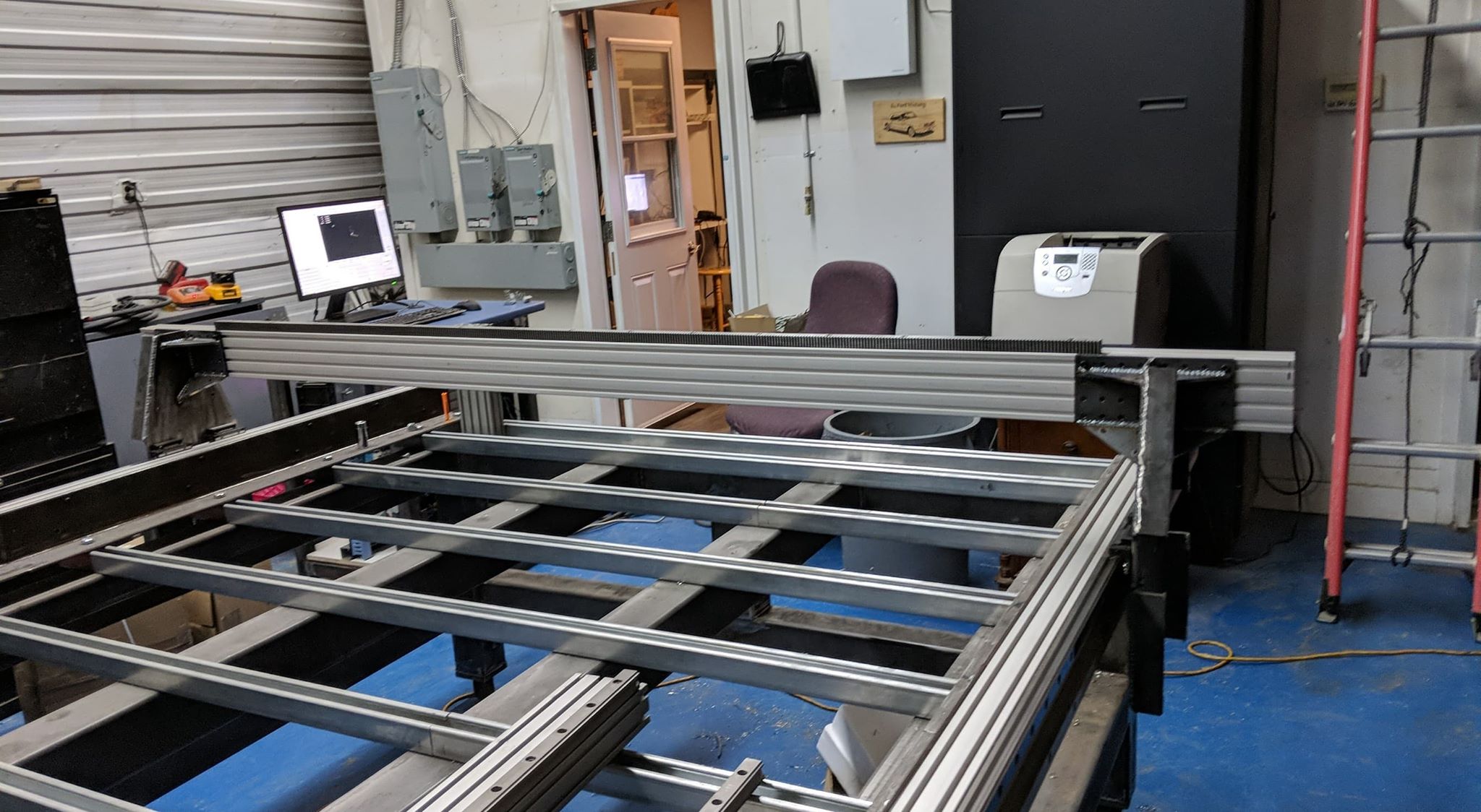

It would actually be interesting to know what your gantry ends weigh with the motors mounted. They are a bit like the folded Ally ones I made and from memory they weighed about 7kg (15.4 lb) each.
I think my total gantry with ends weighed about 34 kg (75 lb) so its not that much difference to what you expect. If I did it again, I'd only use one HGR15 rail on the X axis as 2 was overkill and added more weight than what was needed.

I think it will weigh in around 100 lbs maybe.
Still thinking on how to do the X bearings and Rack and Pinion. The bearings will have to be on two separate sides because it is only 2" X 4" alu extrusion. Rack and pinion on top maybe. Not sure yet. I should have put 3" X 6", but that stuff is triple the price.
Replied by bevins on topic Bob's Plasmac Build
Stefan, it makes me feel better now!
I know the feeling. It was all a bit of a puzzle. I Went through so many iterations.
I got mine to fit on an 80mm x 40mm extrusion so you have plenty of room. When you say bearings, you mean linear bearings and rails? If you look at the radial torque specs of the HGR rails, you only need one rail (even for HGR15...) Provided you are not wanting to use it as a router!... Clive's looked nice with a rear mounted motor...
