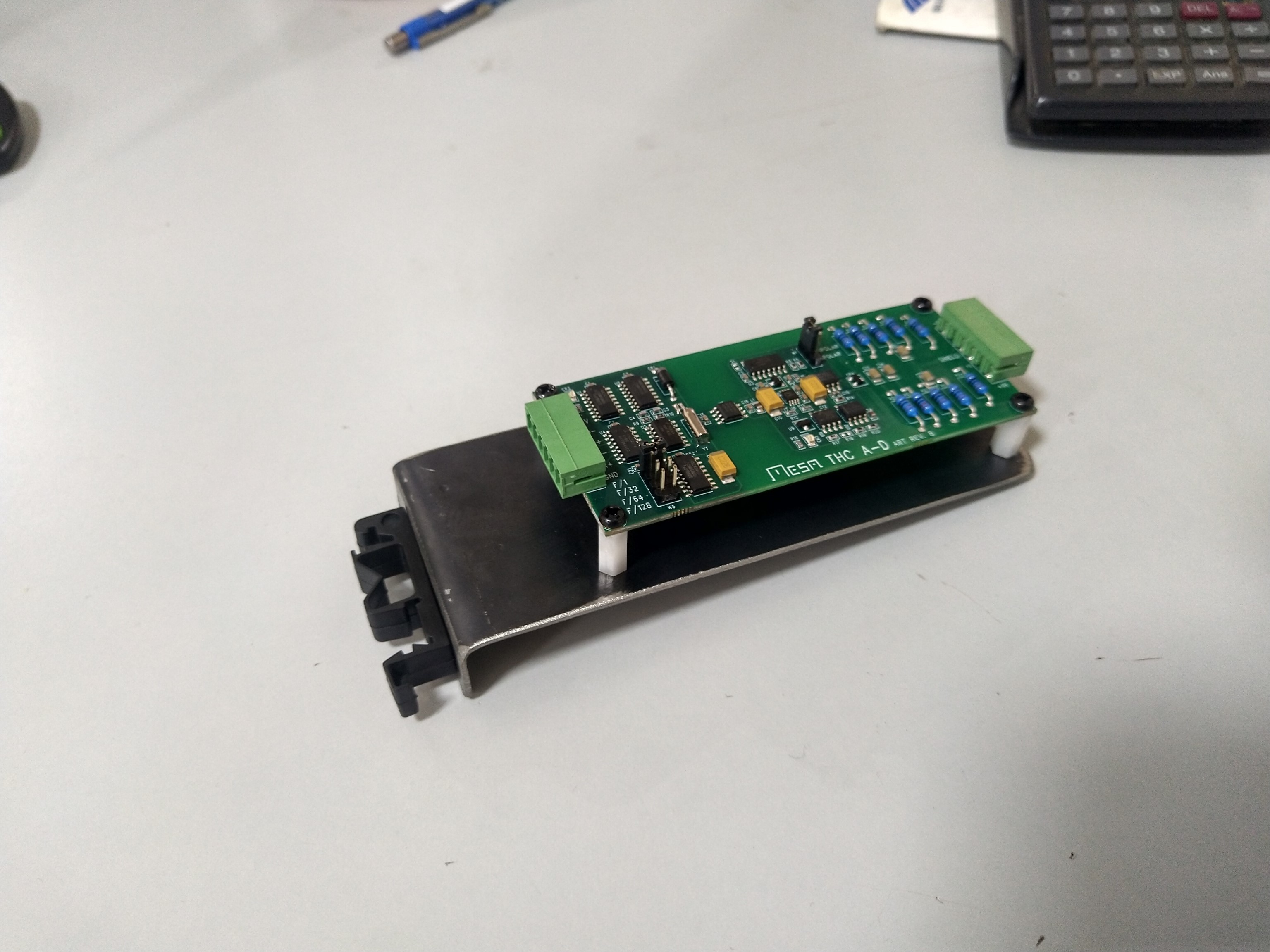

- thefabricator03
- Visitor
29 Nov 2019 22:51 #151530
by thefabricator03
Replied by thefabricator03 on topic Bob's Plasmac Build
I dont think I could of built my THCAD vertical mount any cheaper, used a cheap plastic din mount, some 1.6 mild steel sheet offcut and four plastic standoff and screws,
Although if I had the real estate available in my cabinet I would of done what Bob has done. I do like the look of it laying flat for some reason.
Attachment not found
- machinedude
- Posts: 715
- Thank you received: 312
30 Nov 2019 17:27 #151590
by machinedude
Replied by machinedude on topic Bob's Plasmac Build
to be honest i like this set up for mounting a board. for starters it saves space in the box. as long as the bracket has enough length to run any connections i don't see a down side to this approach.
space always seems to run out faster than you intent it to. anything din rail mounted is nice and easy to work with. i never worked with it until the last servo controller i built and din rail made my enclosure work out. without it i would have had a hard time fitting everything in.
for those of us who do not build theses every day it's easy to over look stuff
especially on a servo system
AC systems are a lot more involved and more expensive to build. i'm sure when you add plasma to the mix things can get sideways pretty easy as well.
