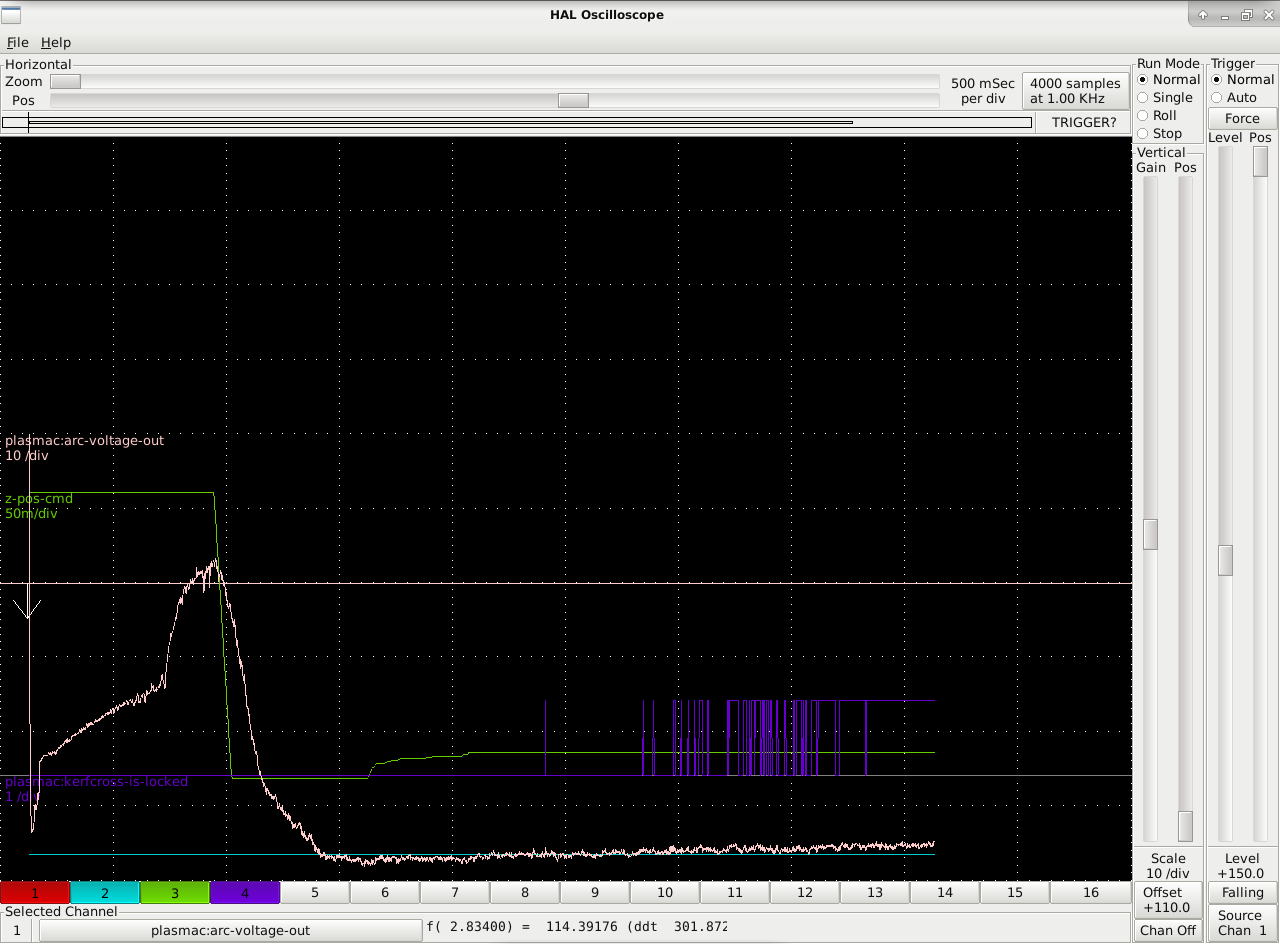

01 Jul 2019 01:14 #138269 by mkardasi
This is a homebuilt stepper table w/ 7i96 & THCAD powered by an ESAB PCM-875. THCAD is jumpered to F32, unipolar. Signal comes from the ESAB's 20:1 output via shielded cable to THCAD, in control box with the 7i96 which is 10ft from the PAC supply. Shield is terminated at the THCAD and 2nd shield term is wired to a star ground inside the enclosure. Control box is next to the table unfortunately. The ESAB is a HF start, pilot arc machine...I'm using the hand torch but the entire lead is sleeved with RF braid and grounded inside the PAC.
What I see is the triggering of plasmac anti-dive (kerf cross) even with the most aggressive setting (500% override, 0.002 height/volt).
Here is a straight cut with encoder.filter enabled and encoder.velocity pumped into lowpass.gain @ 0.467
Attachment not found
At this point I'm not sure if the false trigger is being caused by low I gain, signal jitter or the gravitational pull of the moon. Any advice would be greatly appreciated.

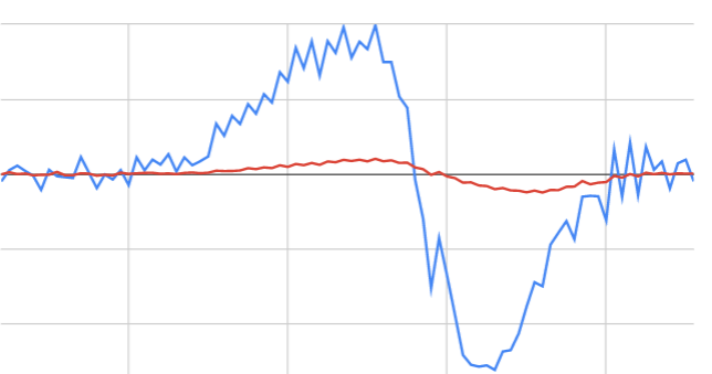

I think its best to disable the kerf crossing at this stage. Phill can't work on it until he gets his table built but your plot indicates his algorithm is not right. A couple of us have tried and given up for now
I have an alternative component I think will work but it will need some experimentation to pick a threshold to kick in at and also how best to turn it off. Plasmac has a pin for an external hold. I calculate a moving average of the rate of change in arc voltage per second so the threshold is something up around 6,000-10,000 when normal cutting is < 3,000 volts per second.

Looks like the torch is following the arc voltage ... Or am I wrong?
It looks like the kerf crossing is ticking the upper and lower limits after a while.
20:1 is not a very good scale. Can the inverter do a 50 to 1 scale?
Strange that it happens in the stable voltage cut path. For me it looks like a boolean software jitter..

01 Jul 2019 23:47 #138356 by mkardasi
Replied by mkardasi on topic Spurious engagement of Plasmac's Anti-dive
I agree. Torch follows arc voltage within the deadband of 1v. Then it locks out because kerf_threshold is exceeded.
* set kerfcross lock if voltage change > kerfcross threshold volts */
                            }else if(kerfcross_enable){
                                if(thc_feed_rate < current_velocity * 60){
                                    kerf_ratio = thc_feed_rate / (current_velocity * 60);
                                }else{
                                    kerf_ratio = 1; /* 45 degree ramp */
                                kerf_threshold = ((kerf_ratio * current_velocity * fperiod) / height_per_volt) * (kerfcross_override * 0.01);
                                if(arc_voltage > target_volts + kerf_threshold){
                                    kerfcross_is_locked = TRUE;
                                }else{
                                    last_arc_voltage = arc_voltage;
If I understand the code correctly. My kerf_ratio is set by else to 1 as (thc_feed_rate < (current_velocity * 60)) = FALSE ( 150 < ( 0.5 * 60)).
kerf_threshold = ((1 * 0.5 * 0.001) / 0.002) * ( 500 * 0.01 ) = 1.25v
kerf_ratio = 1
current_velocity = 30 IPM or 0.5 units/sec
fperiod = 0.001 sec
height/volt = 0.002 units/volt
kerf_override = 500
Based on if(arc_voltage > target_volts + kerf_threshold) I have to be within 1.25v of target cut voltage or kerf_cross disables the THC.

02 Jul 2019 00:29 - 02 Jul 2019 00:32 #138360 by PCW
It looks like the kerf detection disables the THC for some period of time (kerf width?) so once you got the first kerf detection event, the THC is never enabled again or the control duty cycle is is low enough that the control loop gain is insufficient to stay within the threshold and therefore does not track the slow change in voltage.
Have you tried simply increasing the kerf crossing threshold to say 3V?
I wonder if a threshold that's more independent of feedback loop bandwidth
would work better (like DVDT of filtered voltage > some threshold) plus some
smarter recovery scheme like detecting the other edge of the kerf
(with DVDT < some other threshold)
It would be nice to see a plot of plasma voltage at an actual kerf crossing...

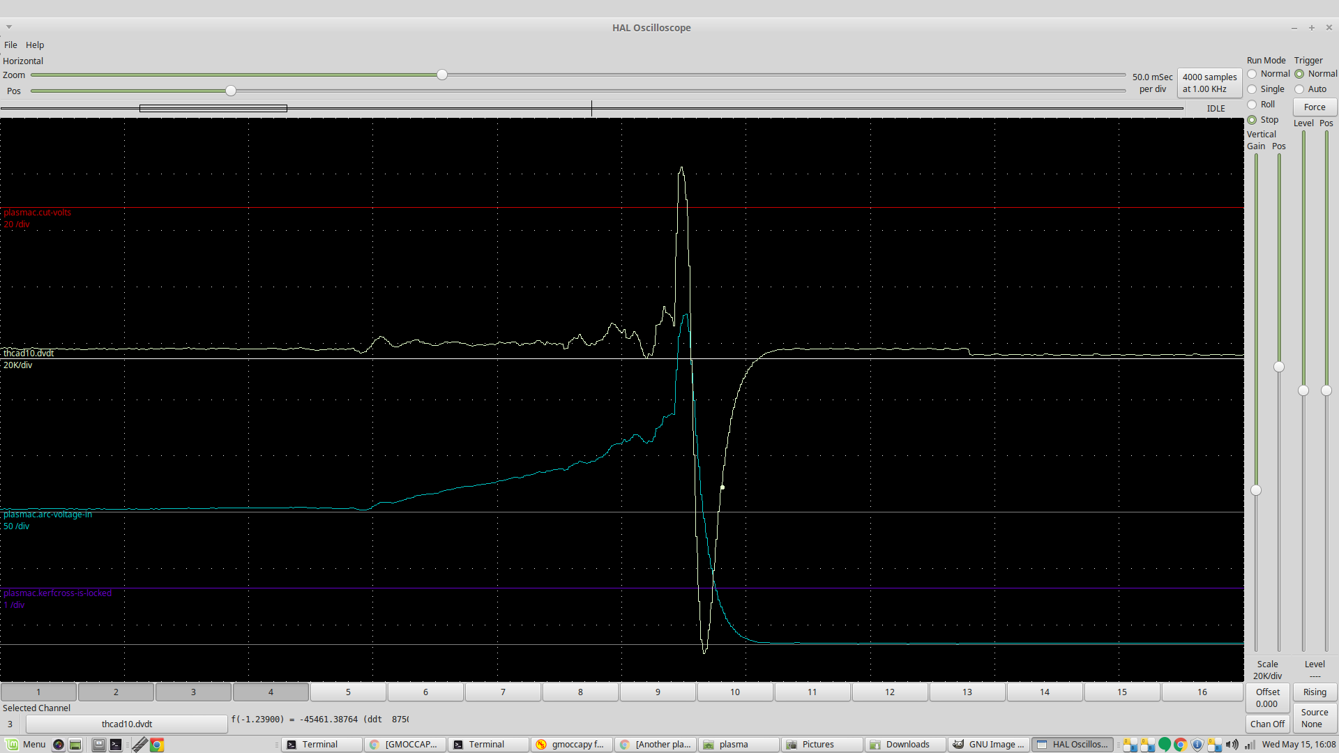

02 Jul 2019 00:45 - 02 Jul 2019 00:46 #138361 by rodw
Here you go, my one and only plasmac kerf crossing plot:
I don't think Plasmac's Kerf crossing algorithim is correct. It needs to be based on DV/DT which is shown on the plot above.
For the uninitiated, the DV/DT plot is hard to get your head around. Because its a rate of change, a constant increase in voltage will show as a flat line. So here you see as the torch runs out of material, there is a quick jump in DV/DT and then it skyrockets once its away from the material totally.
We need more data but I think a threshold set between the normal DV/DT behavior and the next flat line section would disable the THC in a few milliseconds.
This is a (much) earlier plot on my everlast from saved halsope data so the resolution is a bit coarse
Shows DV/DT in blue and moving average in red.
I'm hoping mkardasi has the time to explore this. It takes some time to get halscope and everything set up just right!
