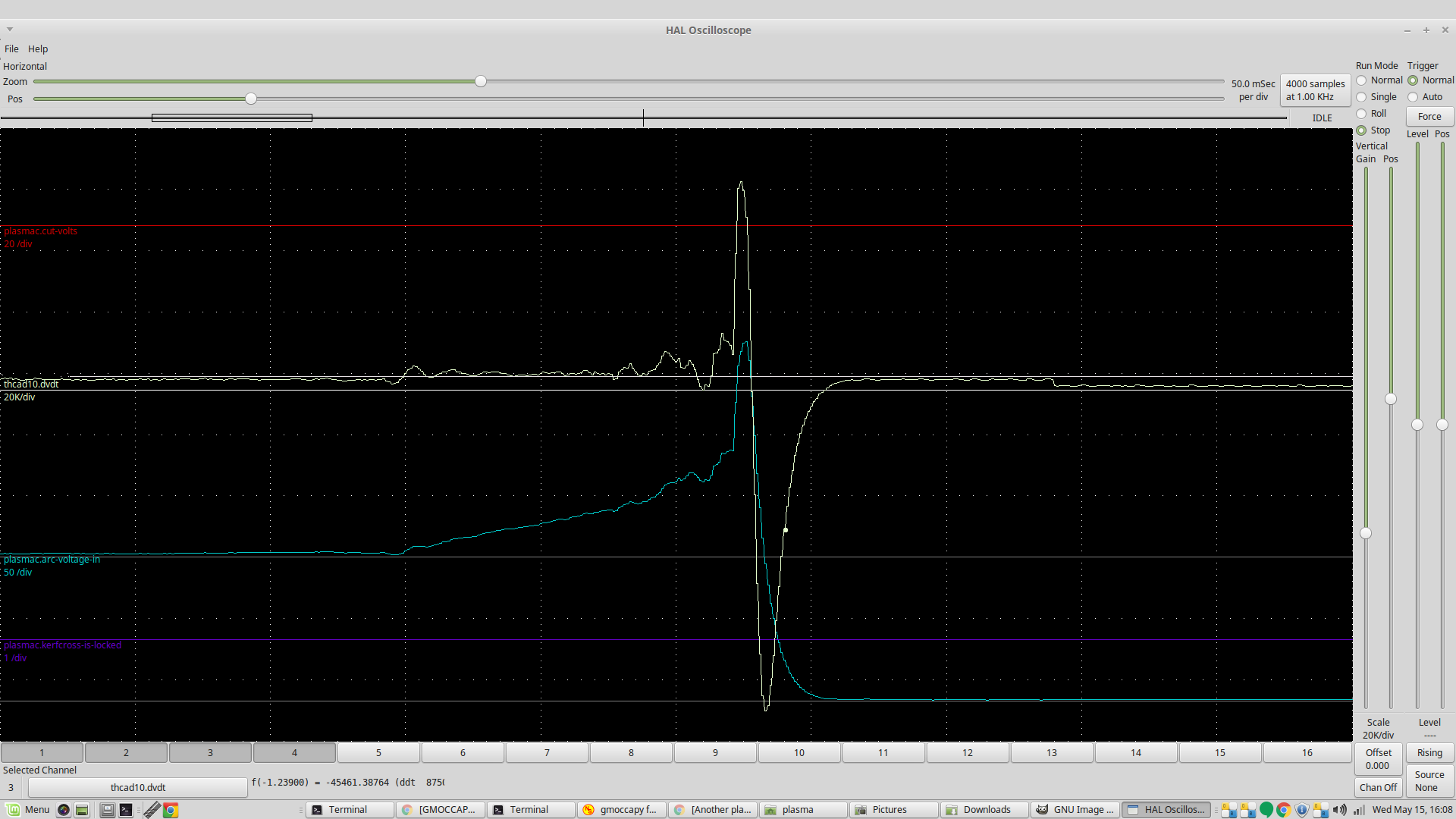

02 Jul 2019 01:17 #138363 by rodw

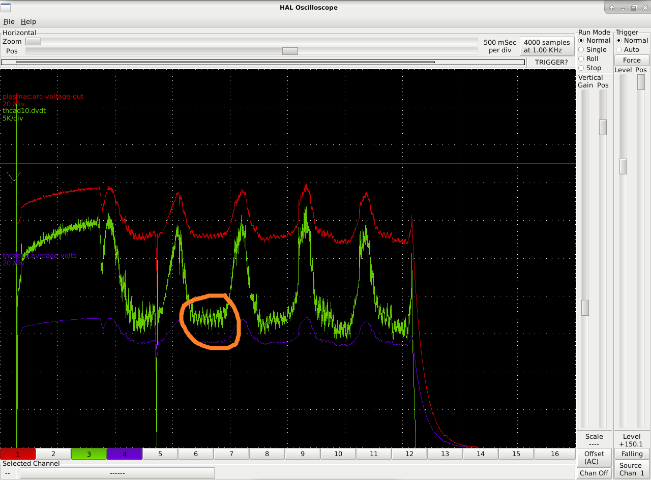

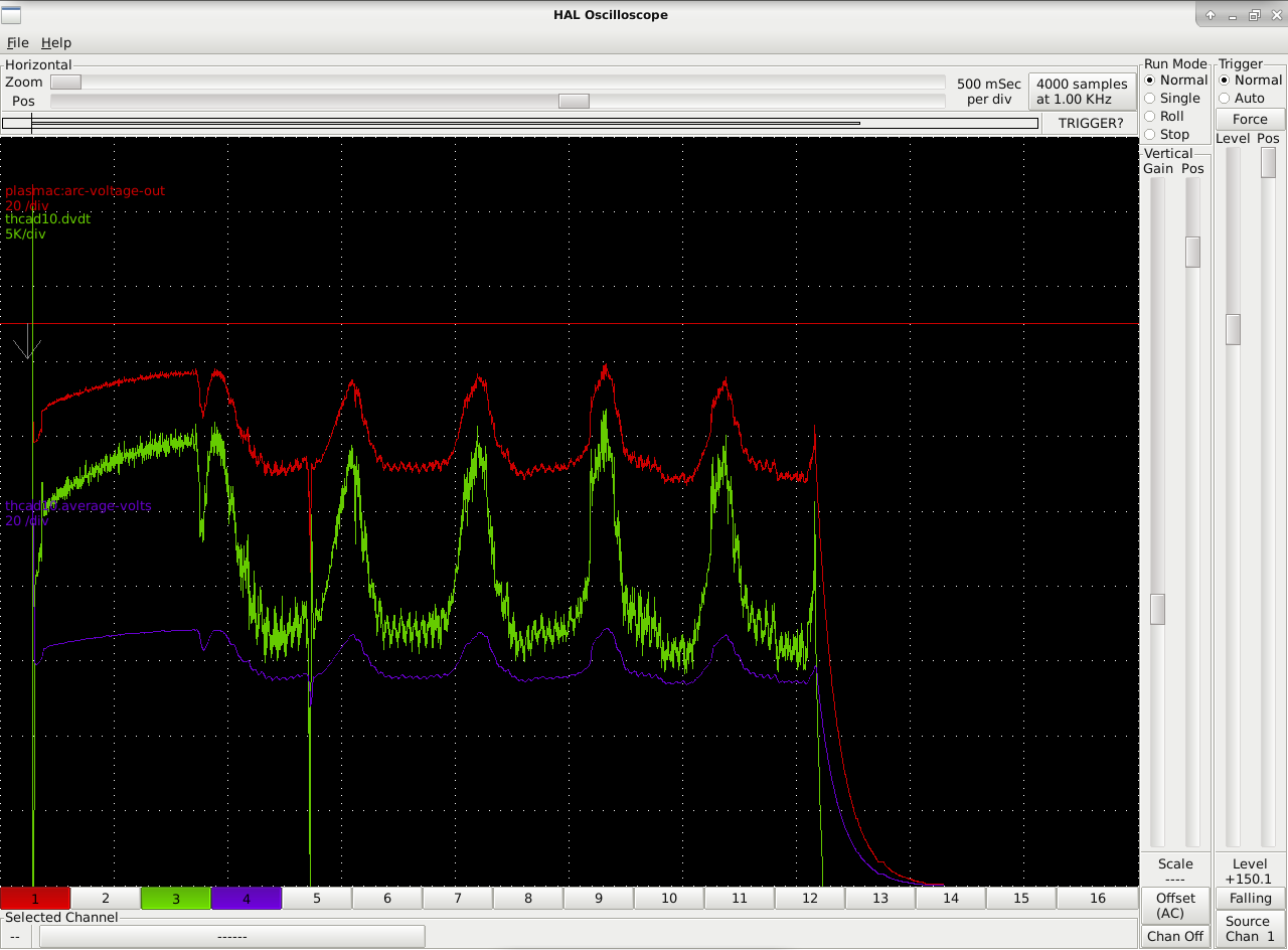

I've added a white line somewhere I think the dv/dt threshold should be. But as I said, we need more data!
And we have not even thought about re-enabling. I kinda think that should be when the arc voltage falls back to being near the desired cutting volts.

It looks like the kerf detection disables the THC for some period of time (kerf width?) so once you got the first kerf detection event, the THC is never enabled again or the control duty cycle is is low enough that the control loop gain is insufficient to stay within the threshold and therefore does not track the slow change in voltage.
Have you tried simply increasing the kerf crossing threshold to say 3V?
I wonder if a threshold that's more independent of feedback loop bandwidth
would work better (like DVDT of filtered voltage > some threshold) plus some
smarter recovery scheme like detecting the other edge of the kerf
(with DVDT < some other threshold)
It would be nice to see a plot of plasma voltage at an actual kerf crossing...

Rod was kind enough to share his component which calculates dv/dt. I just finished splicing it in to my config and cut 4 straight lines 0.200" apart, then I cut across those 4 lines. This is the resultant plot. F/32 & encoder.filter enabled. The lowpass filtering disabled.

02 Jul 2019 06:09 - 02 Jul 2019 06:10 #138372 by rodw
So what is the range of DV/DT movement where the circle is?
Set a threshold just above that and plot the disable pin so we know its turning on and off.
If that is working, and the threshold looks good, it will be time to try it with THC turned on and the disable pin connected to Plasmac.
Also, make sure you have at least 1.5 seconds of cutting before the kerf crossing to allow the arc to stabilise.
What plasma cutter? Your signal seems very noisy so you might benefit from trying some of the things in the EMI thread in the plasma section here. (been there, done that) :(
OOPS: I forgot to say we don't have any code to turn the THC back on again yet.!
