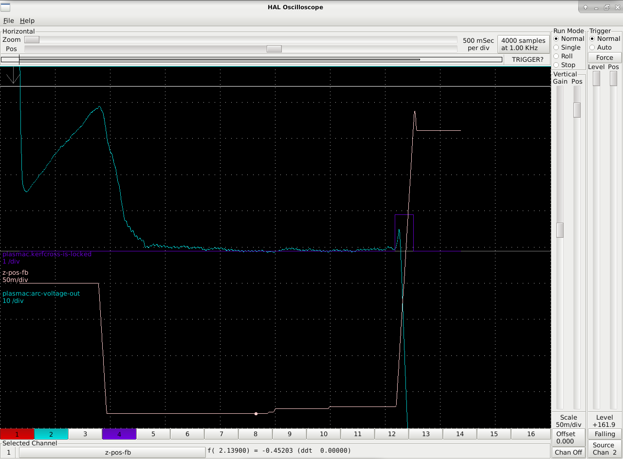

Agree 1 second might be too long but maybe 10 readings (0.01 sec) is too short....
This is probably as good a plot as any of an Arc establishment and cutting normally without THC (Everlast 50 amp)
And arc establishment, crossing a kerf and running off a sheet
Close up
And now with plasmac close up of the original one we've been discussing no THC (Thermal Dynamics A120)
So you can see the arc voltage peaks quickly during piercing (why we use a THC-on delay ) then stays very stable.
Also its clear that better quality machines have a much cleaner torch voltage but some of that could be due to me adding stuff to counter noise on the Everlast. So you have a much better process control signal if you spend the money.
The rate of change is a much better indicator of kerf crossing because it is several orders of magnitude higher than what can happen from normal warpage (but with the plasmac THC, this should be very little).
We are going to nail this eventually.
Close up

I implemented lowpass filtering and modified plasma_run.py to increase the adjustment range of Kerf Crossing Override.
This a short cut with Kerf crossing enabled but not cutting across a kerf.
This is a second cut on the same material now cutting across. That first spike is due to THC enabling while the arc was already in cutting in a kerf.
I just arbitrarily doubled the override threshold to 1000 with these cuts but it looks like the behavior is appropriate.

Looking good! so you are saying this now has a working kerf crossing feature for your machine?
Its interesting that you have been able to filter the signal out quite nicely.
