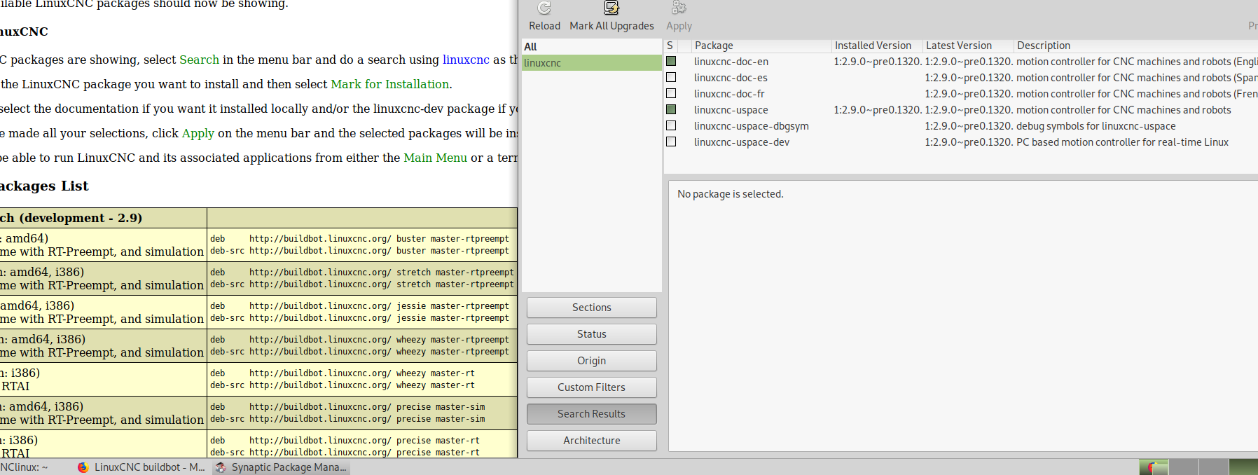

I did like on your homepage described:
gnipsel.com/linuxcnc/uspace/debian10-emc.html
I made a deb package . then installed the package.
I don't have plasmac-dev .
should I use a different installation procedure?

29 Mar 2020 11:37 - 29 Mar 2020 11:38 #161957
by phillc54
Replied by phillc54 on topic Valid Arc Lost, Thcad 300 config & Plasmac override
That's not mine nor is it recommended if you use GladeVCP or Gscreen. They want you to use qtpyvcp.
There is no plasma-dev.
That is why you can't update. You would need to build a package and install the package every time you want to update.
You would be better of with an image from Rob.
forum.linuxcnc.org/9-installing-linuxcnc...with-linuxcnc#157411

- CNCFred

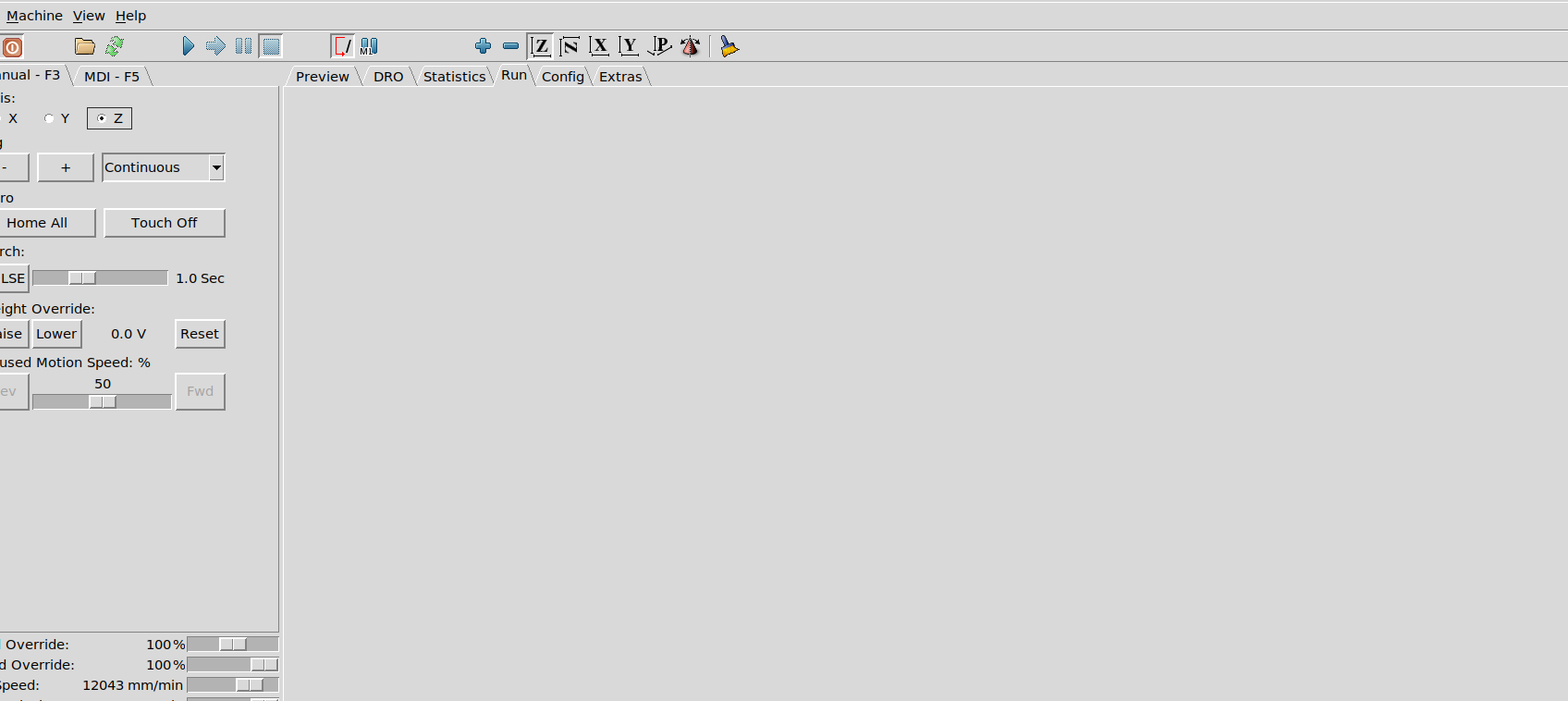

29 Mar 2020 13:11 - 29 Mar 2020 13:29 #161967
by CNCFred
Replied by CNCFred on topic Valid Arc Lost, Thcad 300 config & Plasmac override
funny Sunday...
Phill, I am an IT guy...now I know how people must feel when they approach me and I say..everything is working..
installed buildbot linuxcnc...as above, super!!! all settings in config are there..but
the probe button does not work...and
with humorous greetings...
plasma pulse works...home ..all except...
*** pause-at-end missing from plasmathc_run.cfg
*** thc-mode missing from plasmathc_run.cfg
56623107
58720259
62914563
65011715
after the second start of linuxcnc all settings are there ....and I CAN MAKE A CUT >...YEA on second start of torch , but it did start...>>>
56623107
58720259
62914563
65011715
