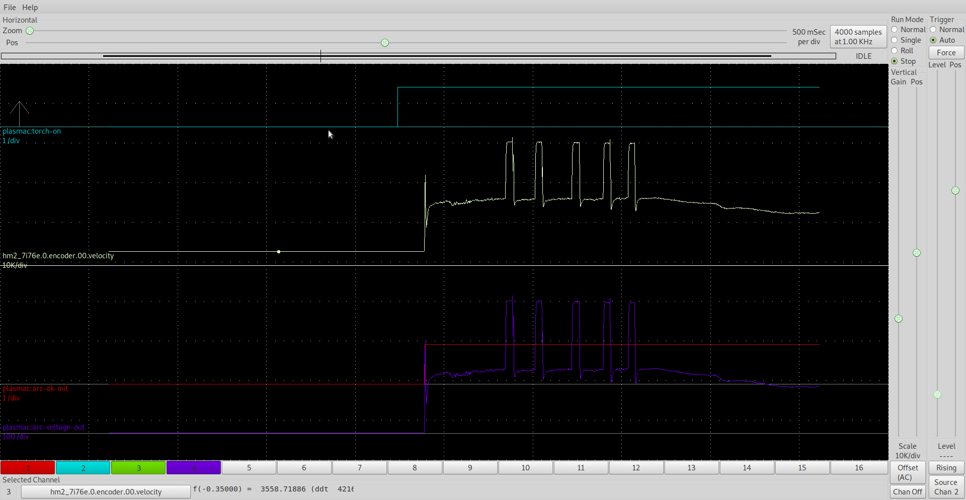

What are those spikes? Kerf crossings ?

I measured the voltage now at the points of the connection thc with a DVM , it is the same ....DC!! with DVM measured..

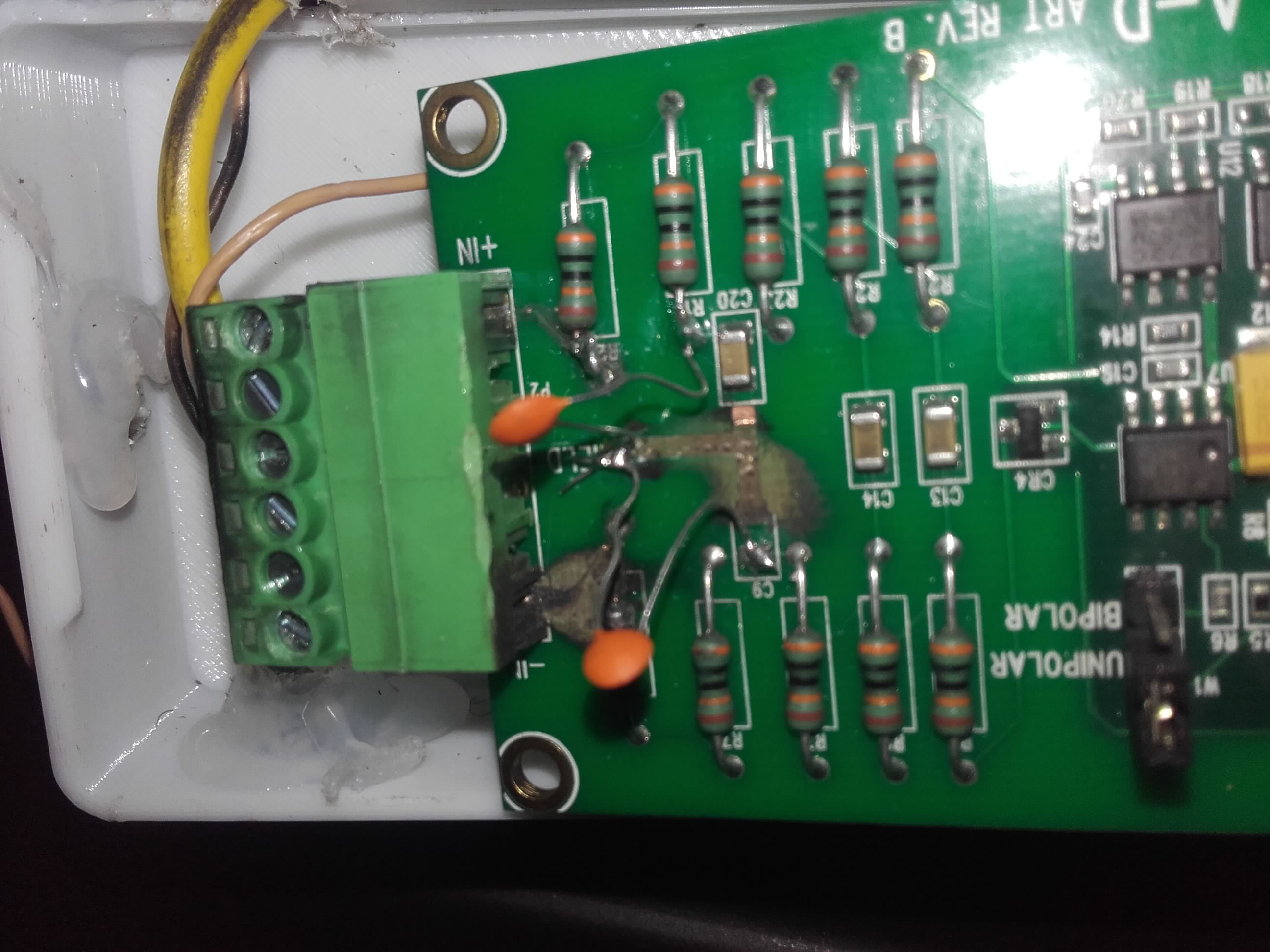

Tommylight Thx for giving the hint about a motor cover...
Ugly fix but working (I am not proud of it) , I used cut off resistor legs as replacement for the broken conductor tracks.(other side)
I am quite happy to have bought Mesa cards! Good choice!
I hope PCW is surprised what his cards can do..... (just kidding)

Well !! hf discharges are spectacular but do not do much damage. the important thing is to clean the carbon residues well, maybe even remove the connector to clean better.
