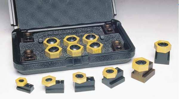

here is a company that does nothing but work holding products. these would work well on a gantry machine with limited Z clearance. these drop right into the t solt and the back bolt fixes it to the table in the t slot and the bolt with the brass nut is actually on a cam so when you tighten the brass nut section pushes the part to a fixed solid jaw and stop on the table. one of many types of specialized clamps.
Mitee-bite
Mitee-bite
