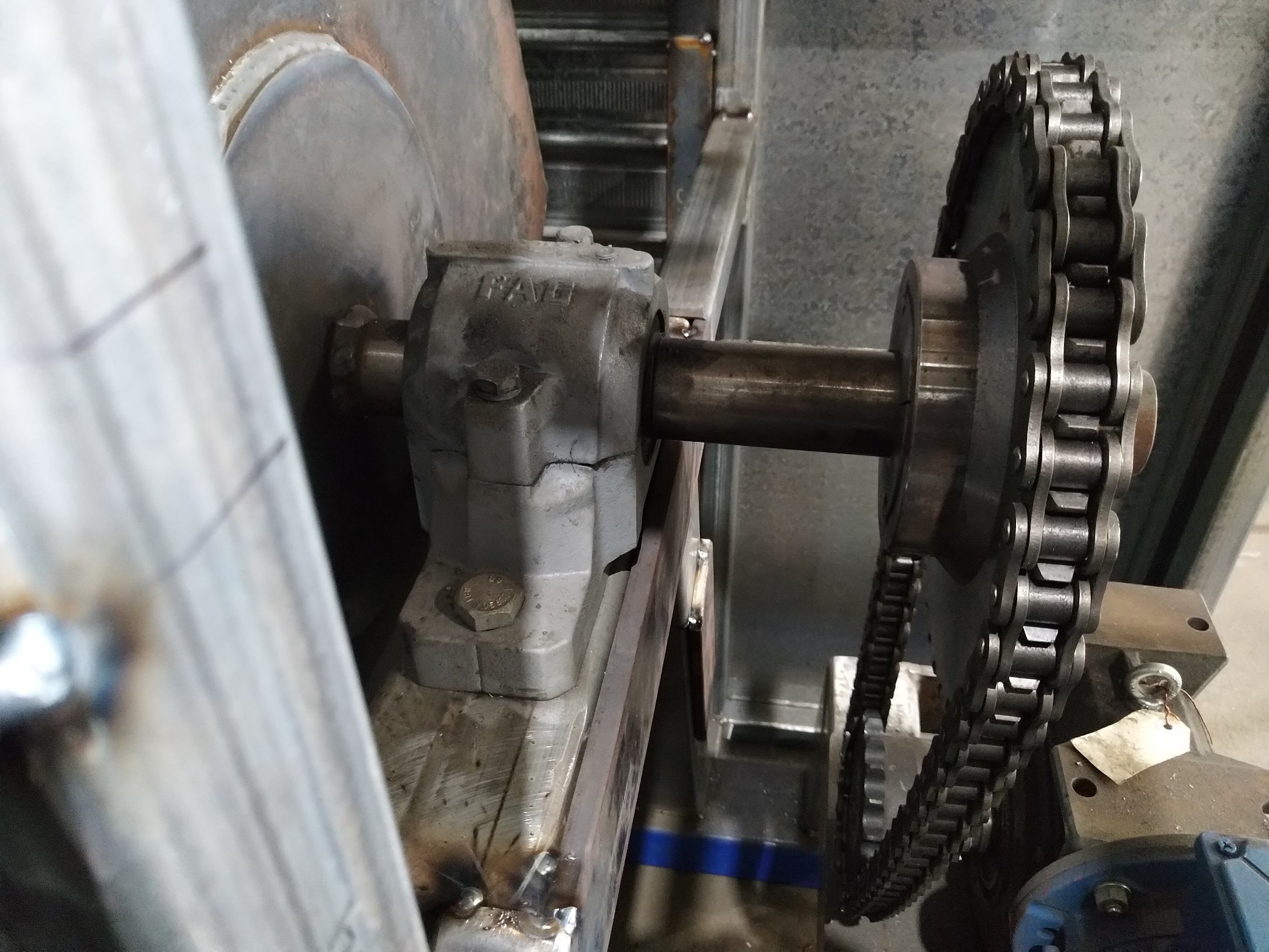

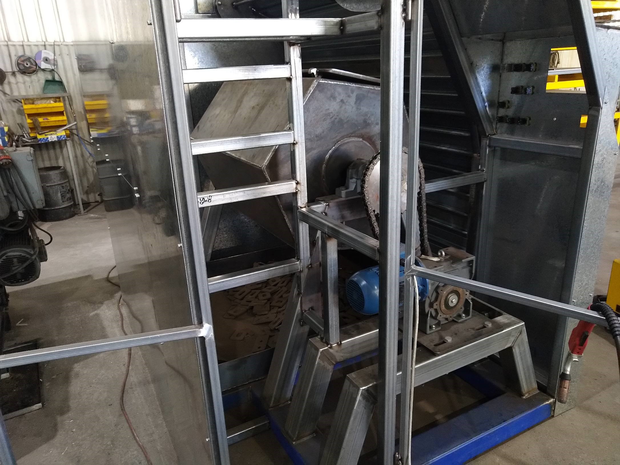

Progress has been slow with the tumbler, I have had the last couple weeks off with the birth of my second son. I hope to get everything apart from the electronics finished in the next couple of weeks,
Center wall, VFD and control box supports tacked in,
The bearings that support the barrel shaft are wider at the top than at the base. I had to offset the internal wall to allow the wall sheet to miss the bearings. If I were to do it again I would just cut a wider notch in the wall sheet to go around the bearing offset and leave the wall flush with the drum frame.
