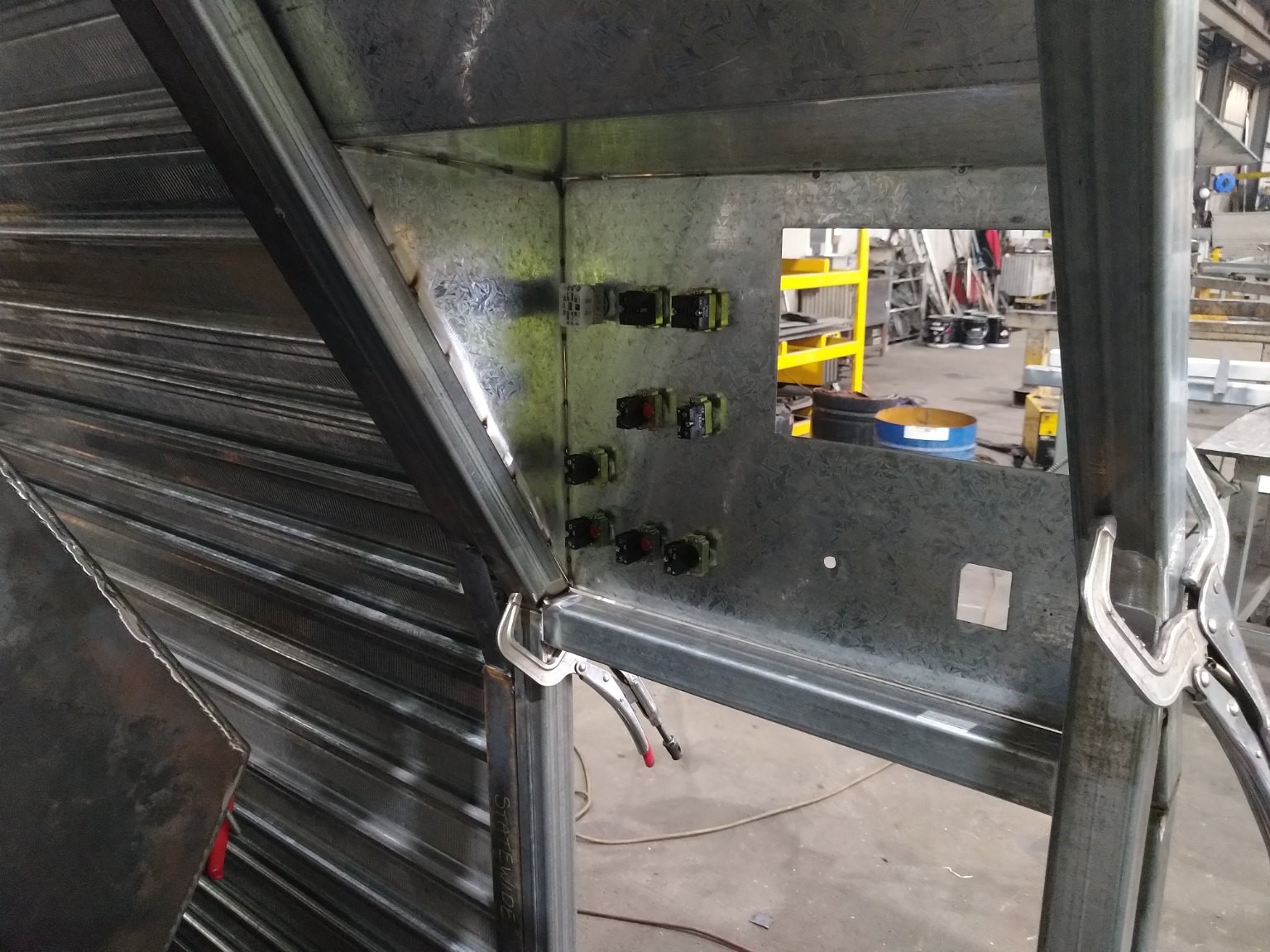

Got the control panel cut out and tacked together,

Aren't plasma cutters cool? Do you remember doing this with tin snips and cold chisels?

Yeah its been a while since I have done it the hard way. Literally took 5 mins to cut out, then about 10 mins to clean the water off and debur and about 5 mins to tack up.
I could of spent an hour on the control panel sheet alone if I was doing it by hand.

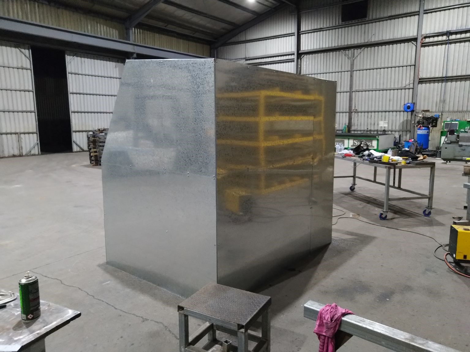

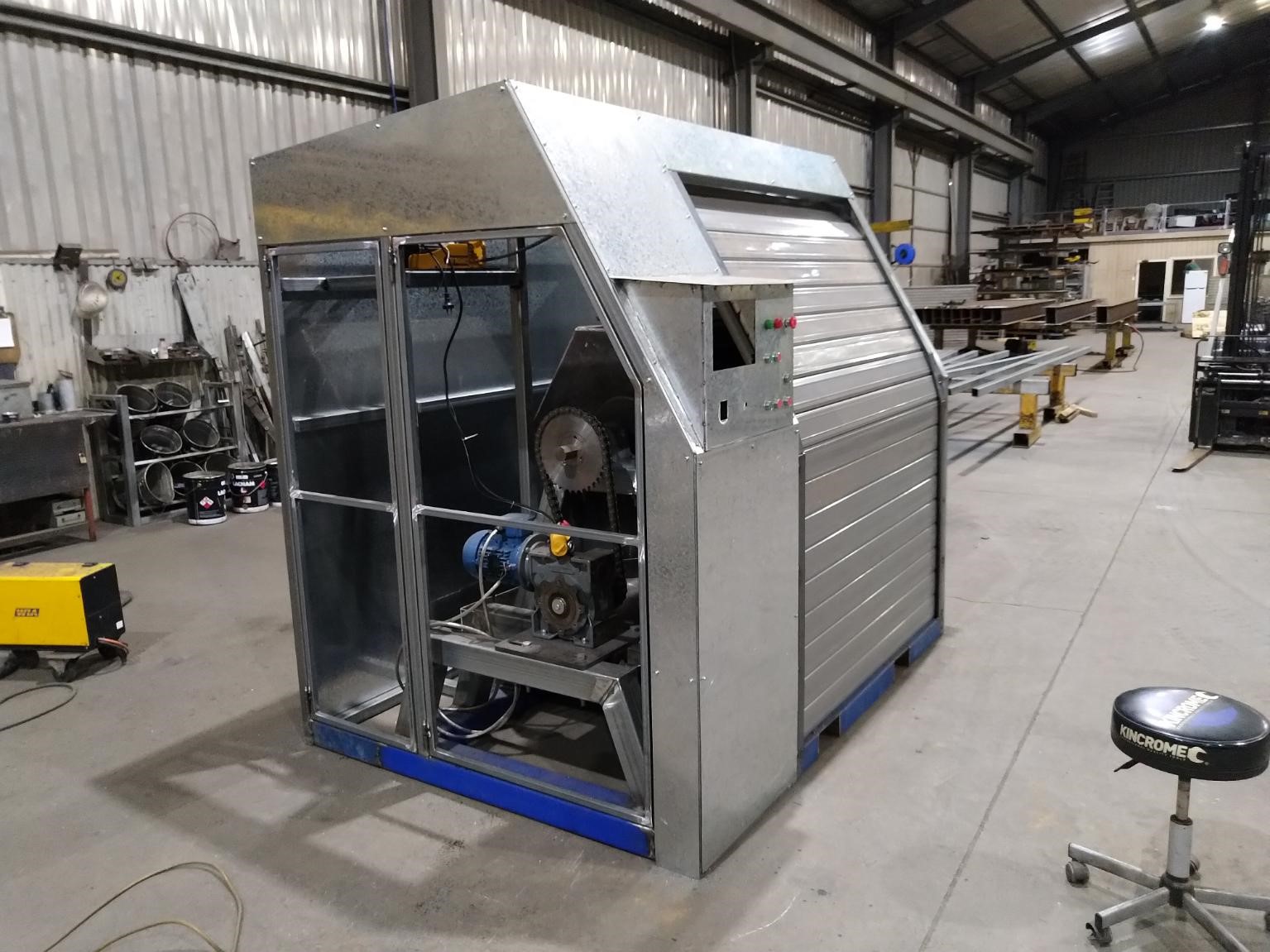

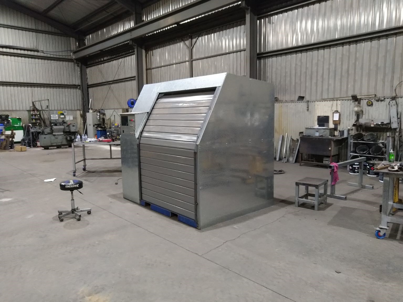

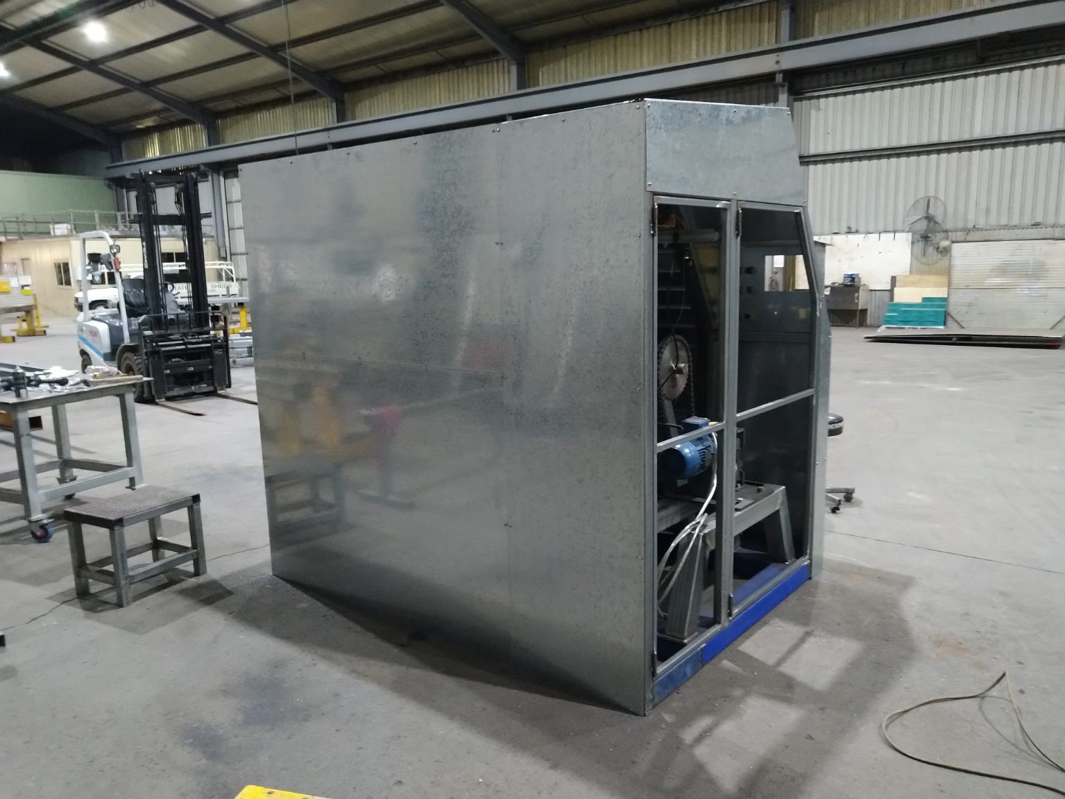

Outside all sheeted except the doors and roof,

if your intention was leaving the tube tube open in the front for a place to get forks in to move it around that was pretty smart
but your shop is big enough to move a fork truck around in pretty easy.
i would be in heaven if i had that much space at home and had the stuff to move the big stuff around quickly and easily
very nice work.
