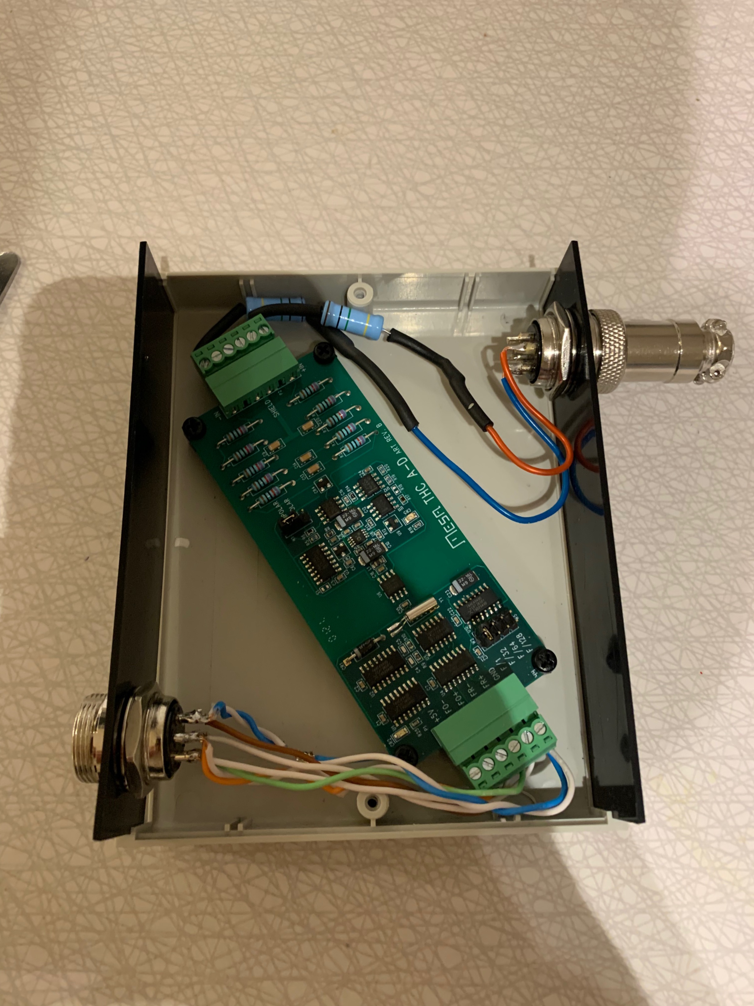

You can use two 1MOhm/2W resistors, one on each wire to THCAD.

Personally I would put the resistors inside the plasma as then you would get better protection re the current

Two things:
1. It is never a good idea to use the same connectors for input and output, that is just fire waiting to happen.
2. Metal connector on the high voltage side, again fire.
Use normal home power sockets if you have nothing else, if you are in Europe they are rated for 250V, if in US = you're out of luck as the 220V stuff there is big !

Replied by robertspark on topic THCAD 10 to Herocut 55i (1:1)
you could use IEC connectors or figure of 8
I would put the divider in the machine. I would not export raw arc very far...... when I had an old Powermax 350, and used a raw arc voltage output into a Proma THC 150 (I knew nothing then and only know a little more now), I bolted the enclosure to the side of the plasma cutter and within it I located the PromaTHC 150, and just had 1 connector on the side of it with those circular connectors.
I have since used them extensively, but I use all sorts of pin connections (2, 4, 5, 6, 7, 8,9 and 10 pin connectors so that there cannot be a mix up on wiring or voltages etc)

Thanks! I will move the resistors inside the machine. My Herocut plasma has these metallic connector (but smaller), but I share your thoughts but didn’t want to tamper with warranty. But I will move the resistors as I share your consern.
But Shall the resistors only be in series? That’s not what I imagined a voltage divider? Can someone please make a picture how I should connect the resistors.
the connectors is 7 and 4 pin so I can’t mix them up.

not so ... simply in series. the divider is in the thcad board. one in series to pin 1 and one in series to pin 2
