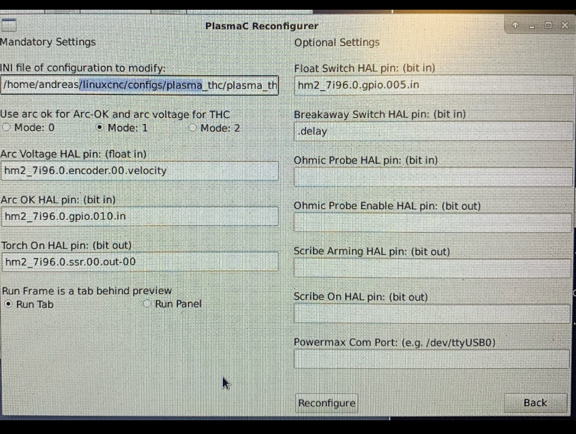

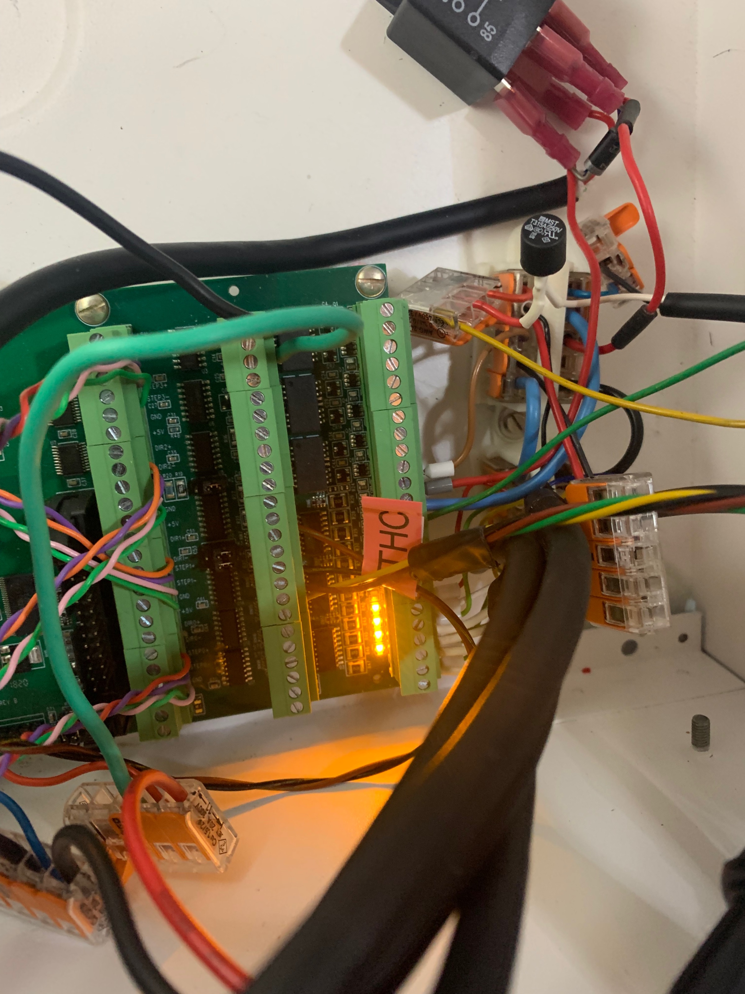

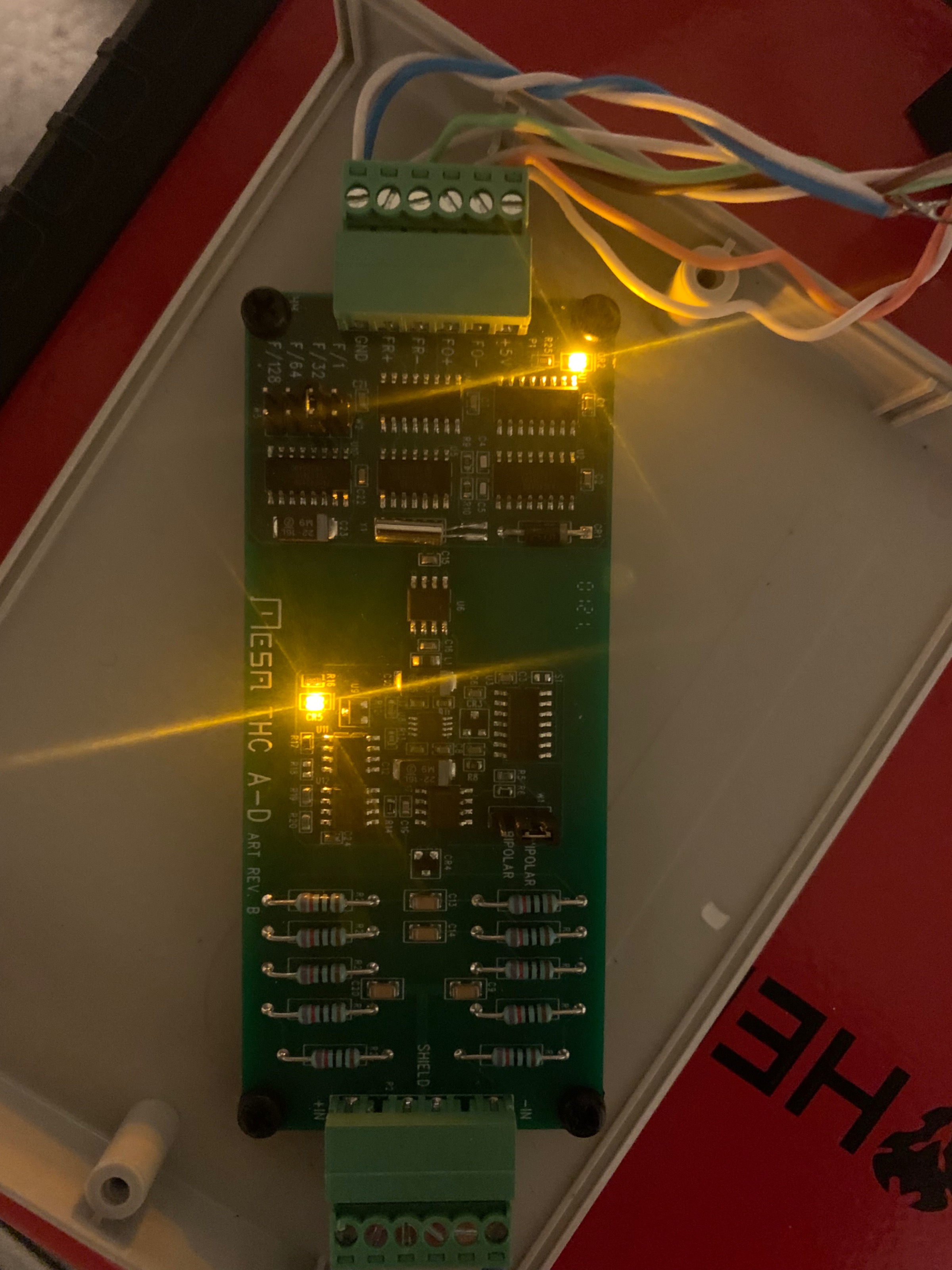

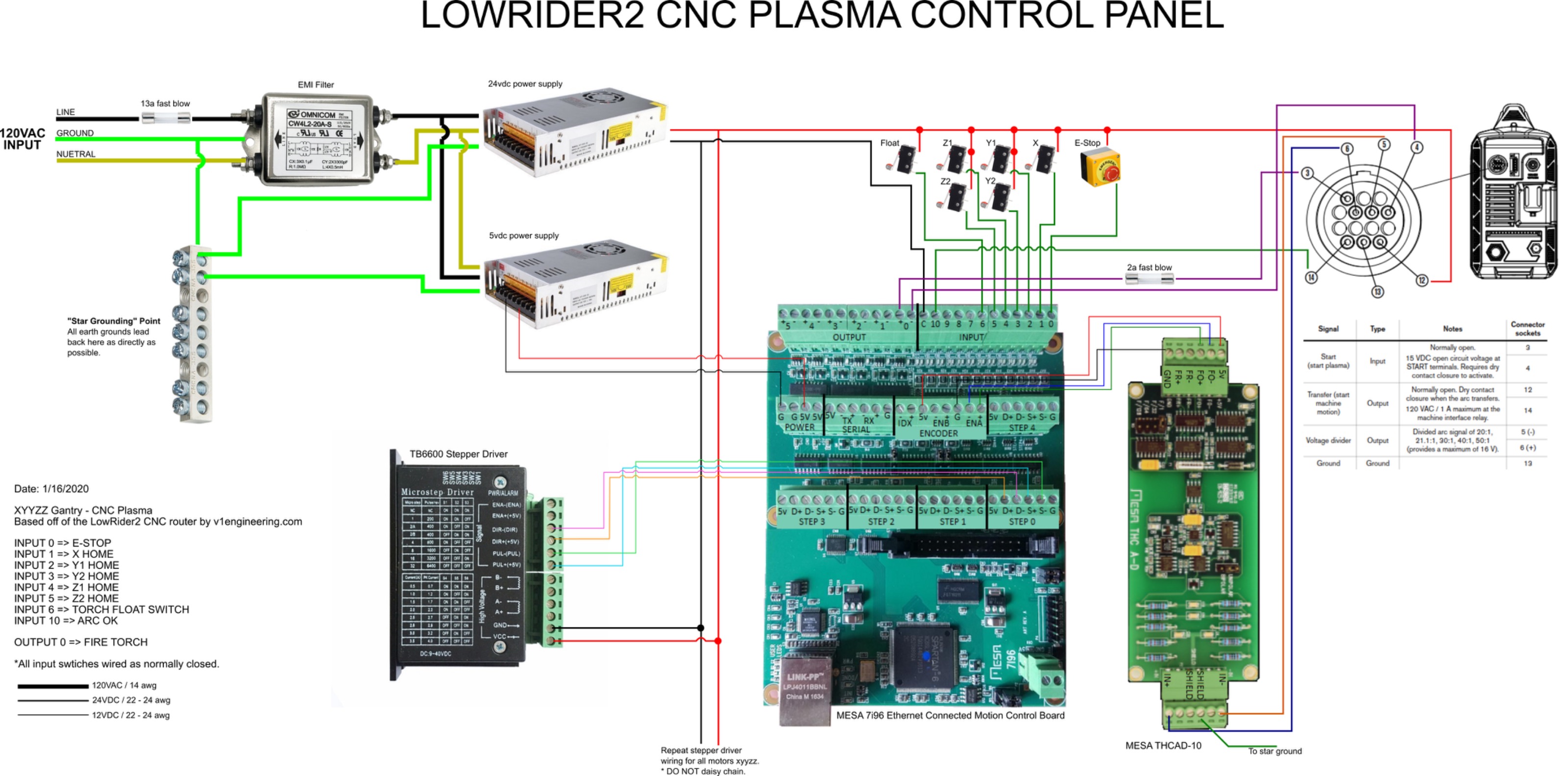

hi! I have now tried to connect and run my plasma, but I can’t get the arc voltage to display on screen. I have tried to connect as the first image, and have made the configuration as the picture. The output voltage is around 100V after the resistors. Do I monitor the wrong port? I have tried with all frequency settings and still no luck. How do I go forward?I read the manual that I green light should be on the Thcad board but one is blinking orange and one is steady glowing orange. The one that is blinking is blinking faster when arc is on

That is perfectly OK, so the issue is on the other side from THCAD to 7i96 or in the config, so check the connections.hal file for :I read the manual that I green light should be on the Thcad board but one is blinking orange and one is steady glowing orange. The one that is blinking is blinking faster when arc is on
# ---Encoder feedback signals/setup---
setp hm2_7i92.0.encoder.00.counter-mode 1
setp hm2_7i92.0.encoder.00.filter 1
setp hm2_7i92.0.encoder.00.scale -1Please Log in or Create an account to join the conversation.
