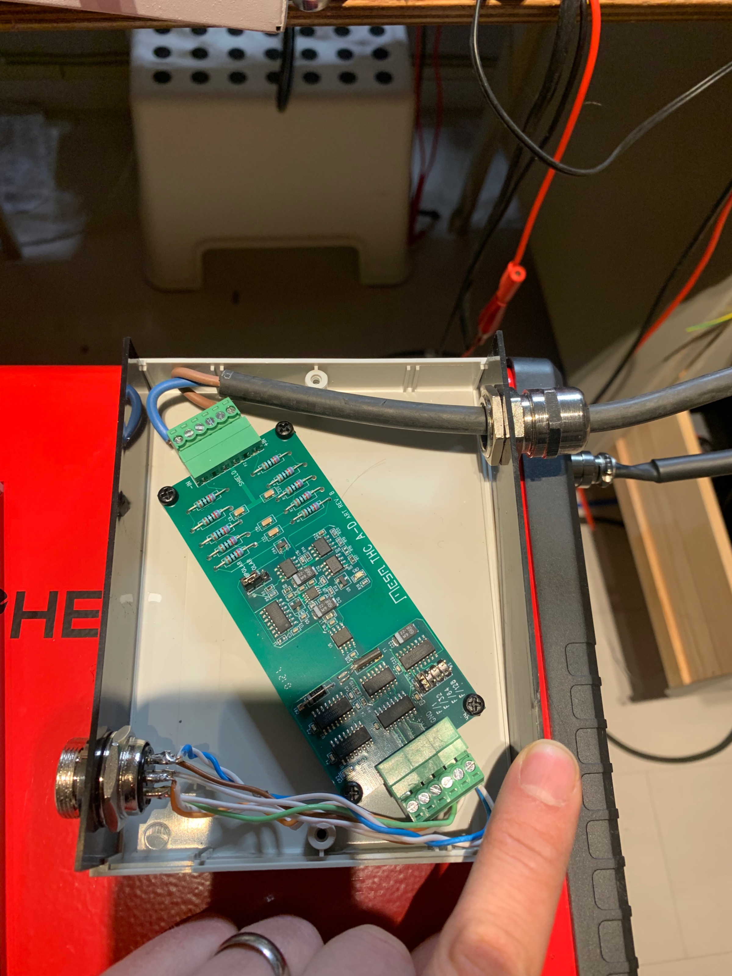

Did you check if there is any resistance between the electrodes and the raw arc outputs?
That would need to be included as part of your scaling resistors to get the thcad scaled correctly.
If it does have say 100k on each pin, the external voltage won't be lethal so it will be safe to keep it all outside as you have now.
The Everlast and Thermal Dynamics machines I have had both had 100k resistance mentioned in the manual and I measured that on the everlast with a multimeter.

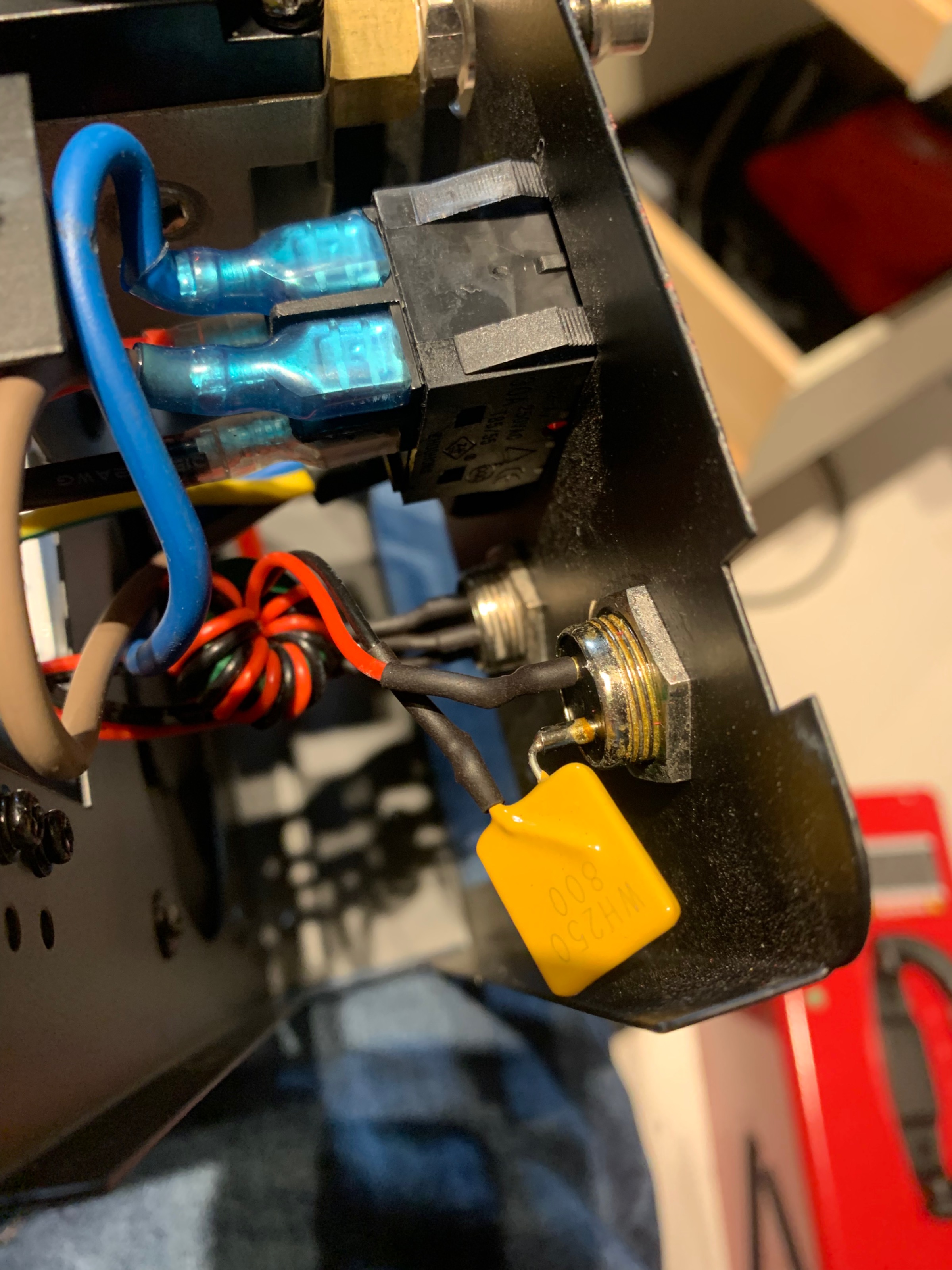

Did you use your multimeter to check if there was any resistance between the pins and the electrodes before you started?
YO really need to know that.
- Ekholm
- Posts: 73
- Thank you received: 12
10 Jan 2022 19:25 #231335
by Ekholm
Replied by Ekholm on topic THCAD 10 to Herocut 55i (1:1)
Oh didn’t know that it was important, thanks! I measured 120kohm on both ground and plus. Do I need to compensate with a smaller resistor or how do I do it?
- Posts: 12111
- Thank you received: 4136
10 Jan 2022 19:41 #231339
Recalculate the full scale reading as per the formula in the THCAD manual including ALL resistance in the circuit (eg 240k Ohm plus the resistors you added).
If its not satisfactory, adjust your resistor values to account for this.
I tested this on my plasma cutter and the adjustment is definitely required. Be sure to scale your software scaling parameters correctly
Replied by rodw on topic THCAD 10 to Herocut 55i (1:1)
Yes, you need to adjust as its part of the scaling resistance the THCAD sees.Oh didn’t know that it was important, thanks! I measured 120kohm on both ground and plus. Do I need to compensate with a smaller resistor or how do I do it?
- Posts: 12111
10 Jan 2022 19:48 #231340
PS: For others contemplating this plasma cutter, there is no need to locate resistors inside the plasma case with this plasma cutter as the 120k resistance on each terminal ensures the current is non-lethal. In fact, there is no reason why the THCAD can't be located inside the main control box.

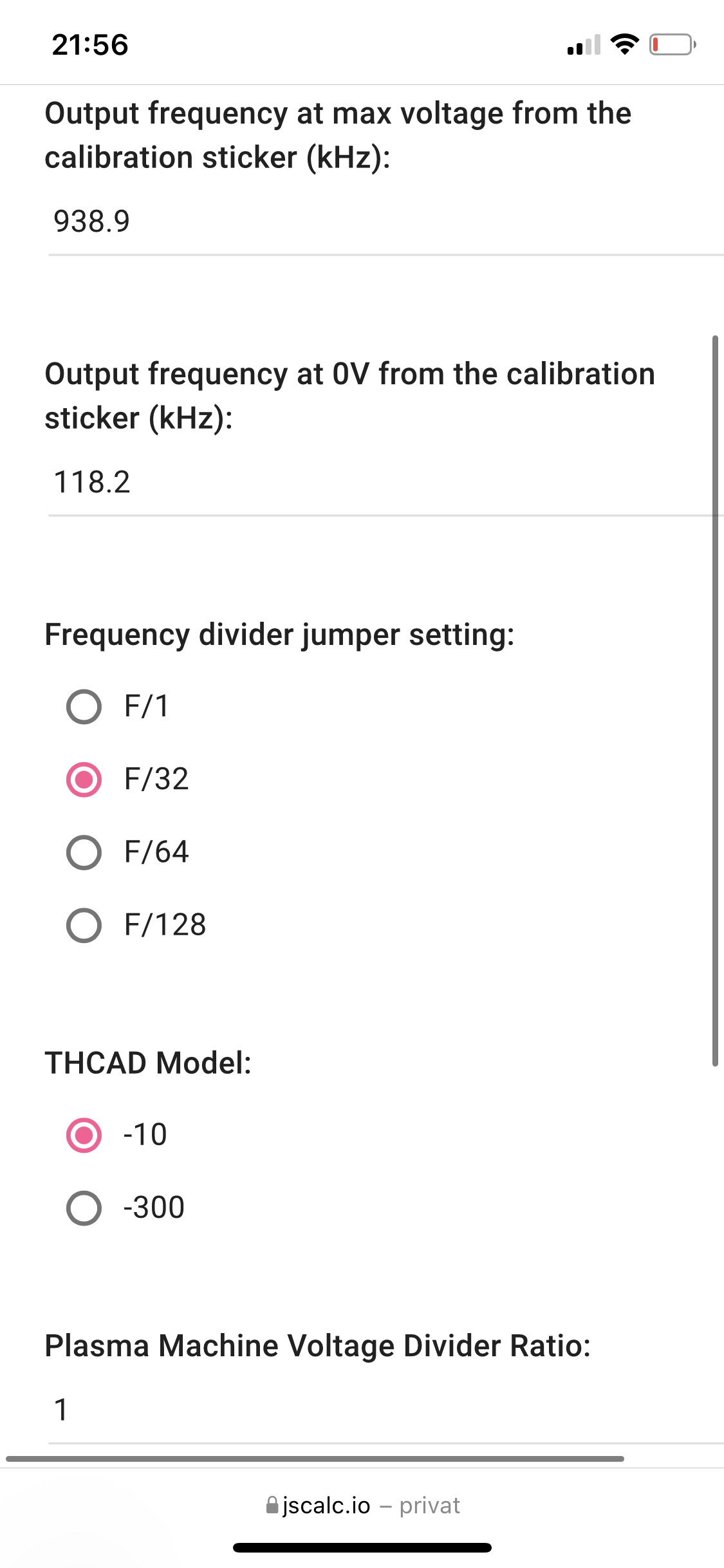

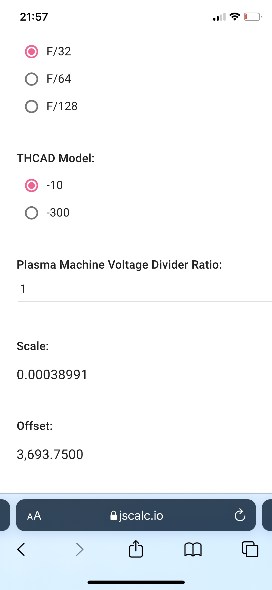

10 Jan 2022 21:09 - 10 Jan 2022 21:13 #231345
by Ekholm
Last edit: 10 Jan 2022 21:13 by Ekholm.
- Posts: 12111
10 Jan 2022 21:59 #231349
You read the manual. Use 1/32
