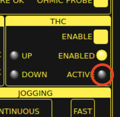

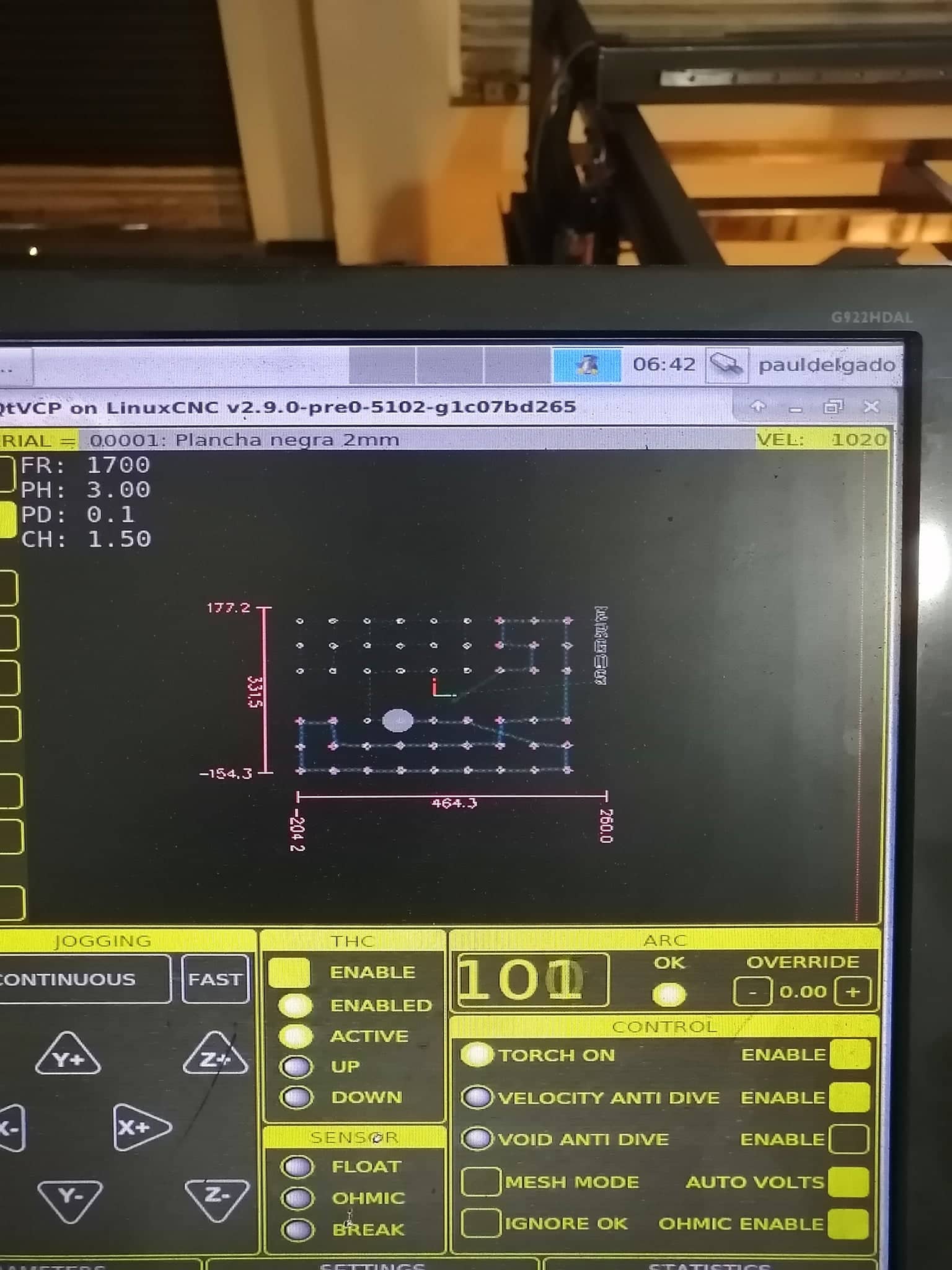

Greetings.I hope someone can help me with the following problem:I am cutting a part with multiple holes using fusion 360 and Qtplasmac v1. 217. 128 what I understand is that the Fusion pp already performs the speed decrease for cutting holes but I realize when cutting the thc it does not lock and I see that the z axis moves when it should be locked. The hole diameter is 10mm

Here I attach the configuration of the machine and a photo where you can see that the thc is activated at the time of cutting the holes.

I made a sim from this posted config and ran the gcode you posted earlier without any problem.
You are still on an old version, can you update and see if there is any change.

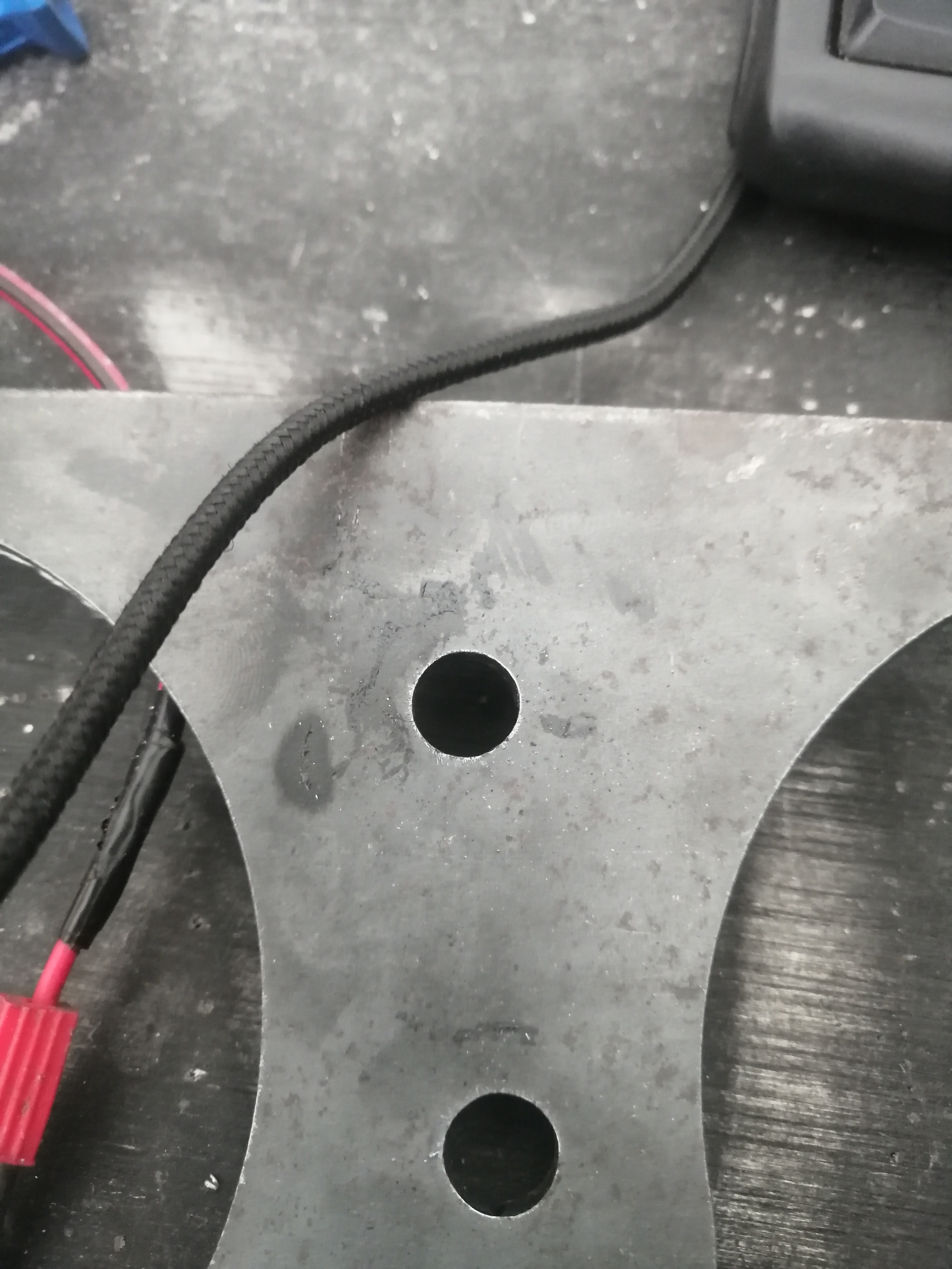

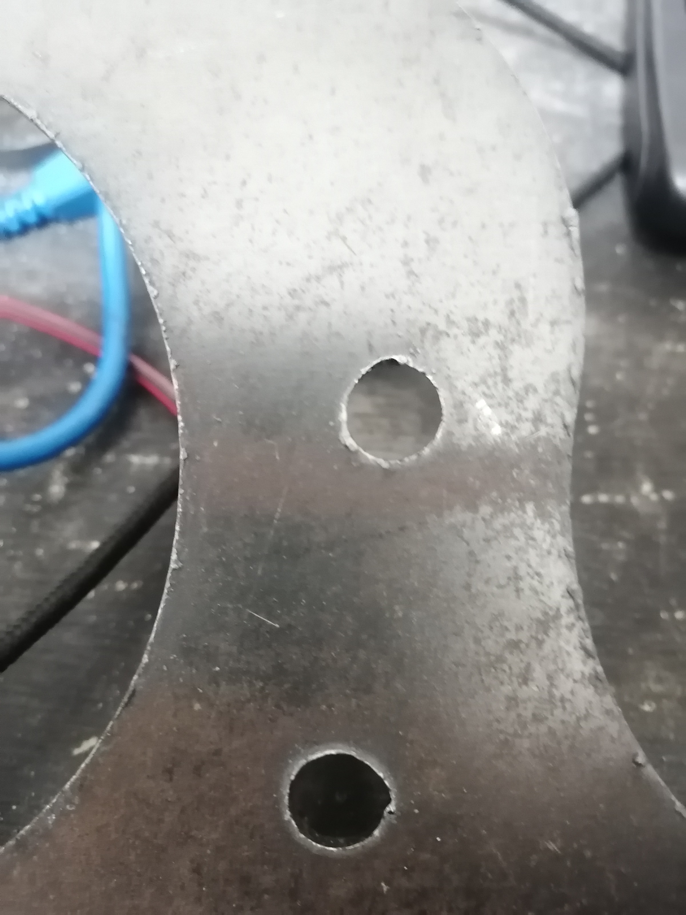

Greetings.Thanks for your help and advice, the problem was solved by upgrading to a new version of qtplasmac, thc is now blocked. Attached image of tests to see if you can help me improve the circles on the back or if it seems fine. Thanks.

Your circles dont look consistent and round to me, so first and foremost, you need to make sure the following are correct to get round circles:
1. The X axis is square to the Y axis after homing
2. You need to check that for all axes that the commanded length = the length actually traveled with a dial indicator.
If you need an explanation of a process for either, don't hesitate to ask.
From there you can go down a rabbit hole with lead ins and lead outs, etc. etc., there will be a lot of differing opinions here as to what is best, in the end you need to do testing with different settings and see what works to give you the best cut quality for that material thickness.
