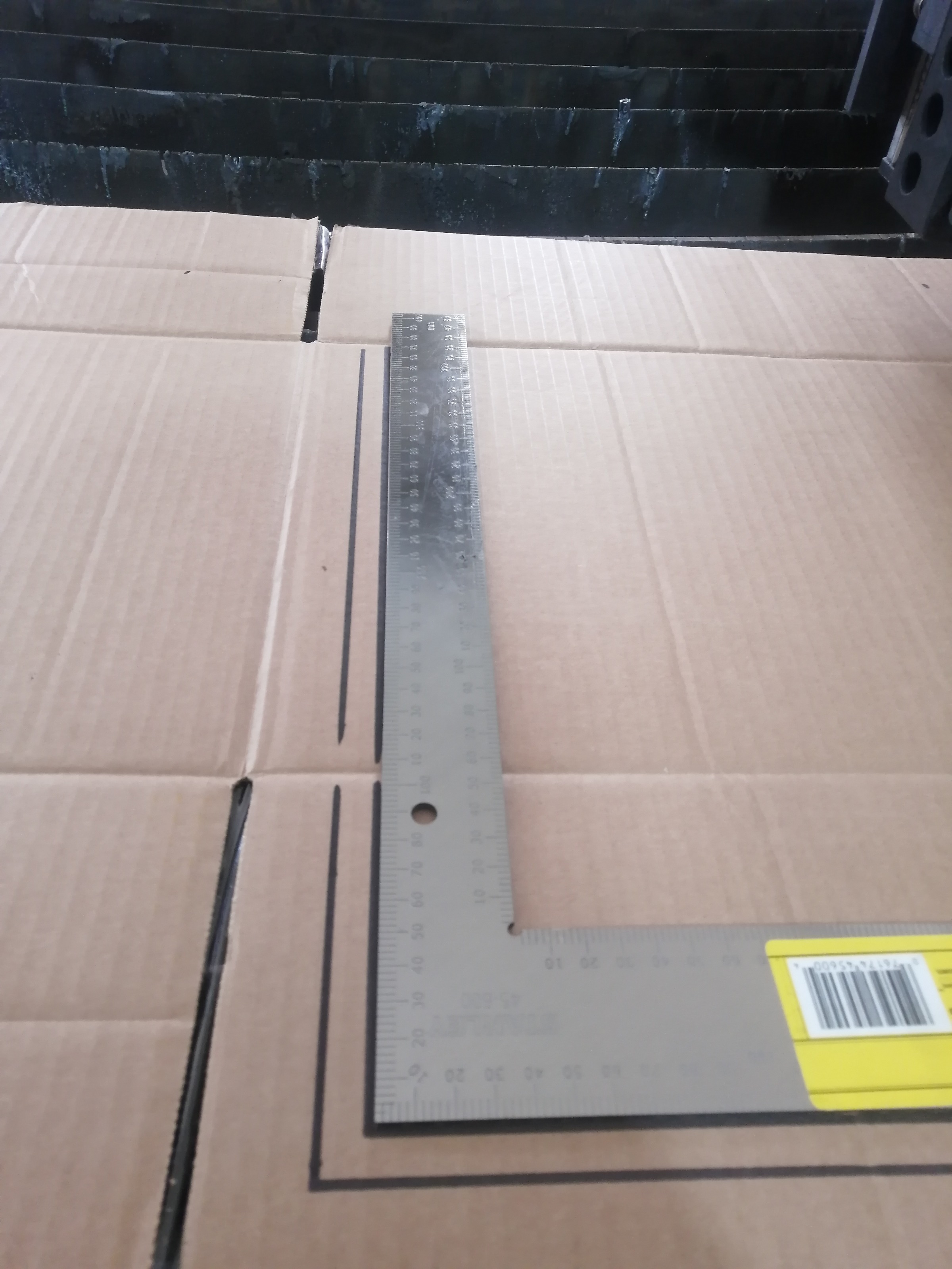

24 Mar 2022 21:33 #238279
by paulsao
Replied by paulsao on topic Thc disable
The first test
- snowgoer540
- Posts: 2580
- Thank you received: 907
24 Mar 2022 21:40 #238280
by snowgoer540
Replied by snowgoer540 on topic Thc disable
Awesome! Looks great!

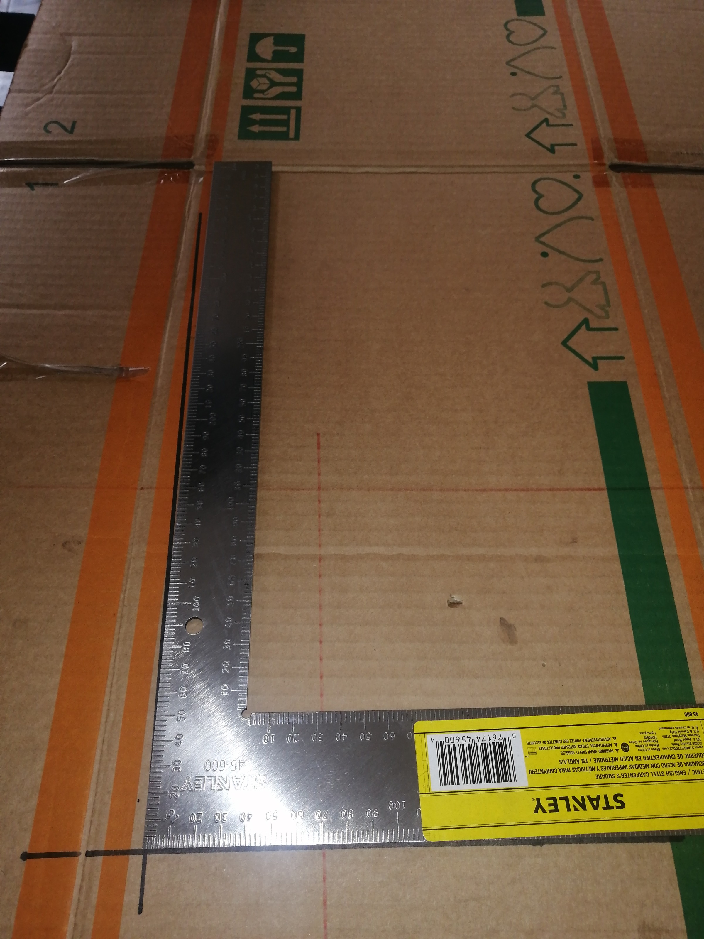

- Posts: 22005
- Thank you received: 7488
24 Mar 2022 22:29 #238288
Replied by tommylight on topic Thc disable
Left side more offset, not sure how big the machine is (also not sure how it is oriented), but seems like at least 2 or 3mm more offset on the left side.
- paulsao
- Posts: 233
- Thank you received: 22
24 Mar 2022 23:15 #238292
by paulsao
Look at the first photo, not the second, which is as you say, there is about 3 mm of error.
- snowgoer540
- Posts: 2580
24 Mar 2022 23:31 #238294
by snowgoer540
Well, that's what I get for looking at it on my phone earlier hahaha, I didnt even notice it needed more offset, I thought he was showing he got it right. Oops.Left side more offset, not sure how big the machine is (also not sure how it is oriented), but seems like at least 2 or 3mm more offset on the left side.

24 Mar 2022 23:43 #238295
by paulsao
- snowgoer540
- Posts: 2580
24 Mar 2022 23:47 #238296
by snowgoer540
Am I losing it? I swear that’s the pic I saw earlier haha. I’ll Blame the editor for playing tricks on me ¯\_(ツ)_/¯
either way, looks great, for real this time
The following user(s) said Thank You: tommylight, paulsao
- Posts: 22005
25 Mar 2022 00:09 #238298
I did see the first pic and it was very close to perfect or perfect (hard to tell from a skewed pic), but then the second pic happened ...
To have it exactly, it does need to be checked on a much bigger area, i tend to use almost all the cutting area so when i get the diagonals to be within 1mm, i consider that "perfect".
Luckily i was looking at it on a 32" monitor, otherwise ....Well, that's what I get for looking at it on my phone earlier hahaha, I didnt even notice it needed more offset, I thought he was showing he got it right. Oops.

25 Mar 2022 01:08 #238300
by paulsao
My table is 2.40 meters long and 1.50 meters wide. I think the best way would be to make diagonals?
- Posts: 22005
25 Mar 2022 01:47 #238301
You make a square and measure diagonals of that square, they must be equal.
While measuring diagonals, mind the side of the tape measure and the side of the square being measured, misplacing the tape measure will give incorrect results.
