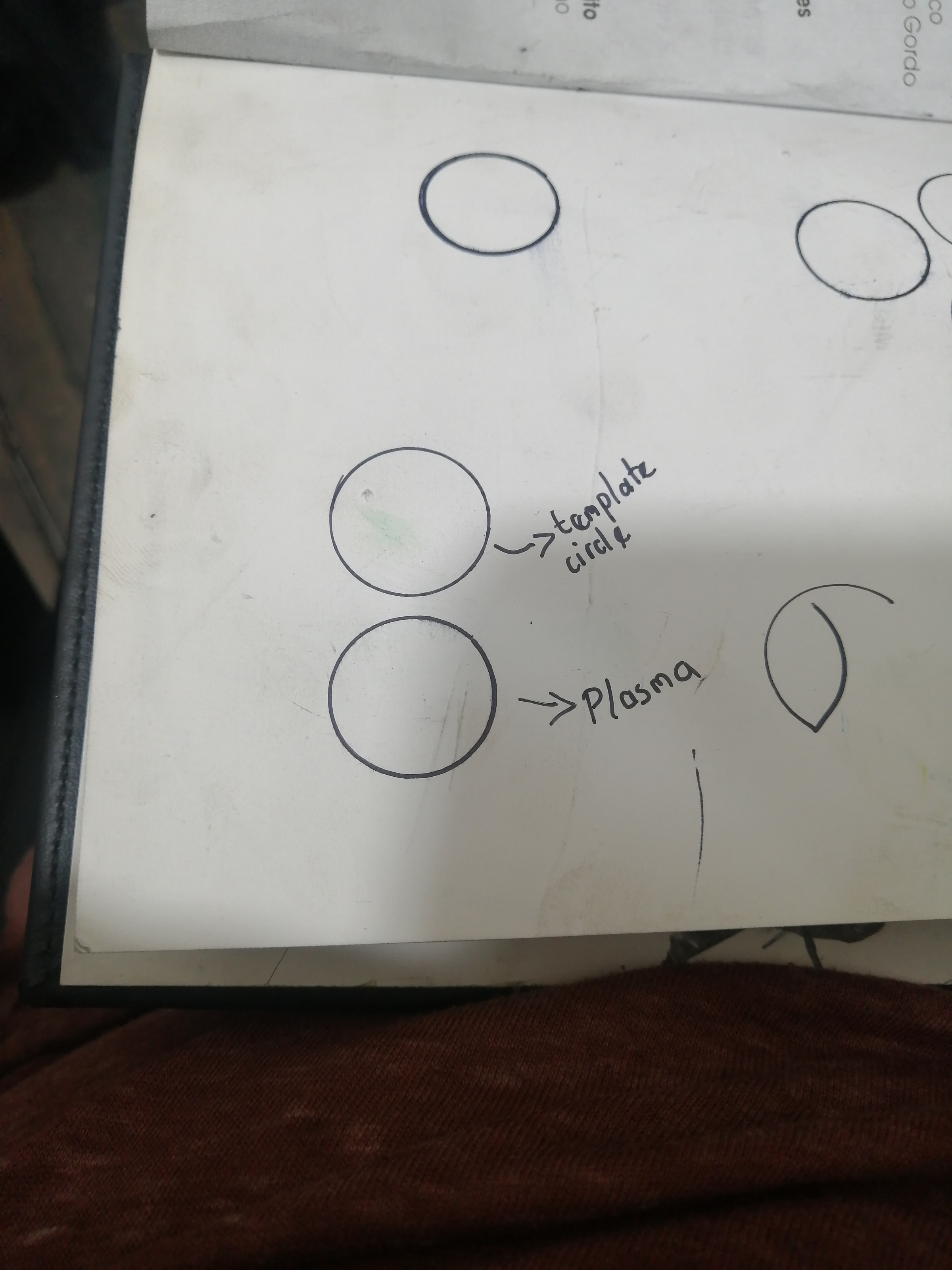

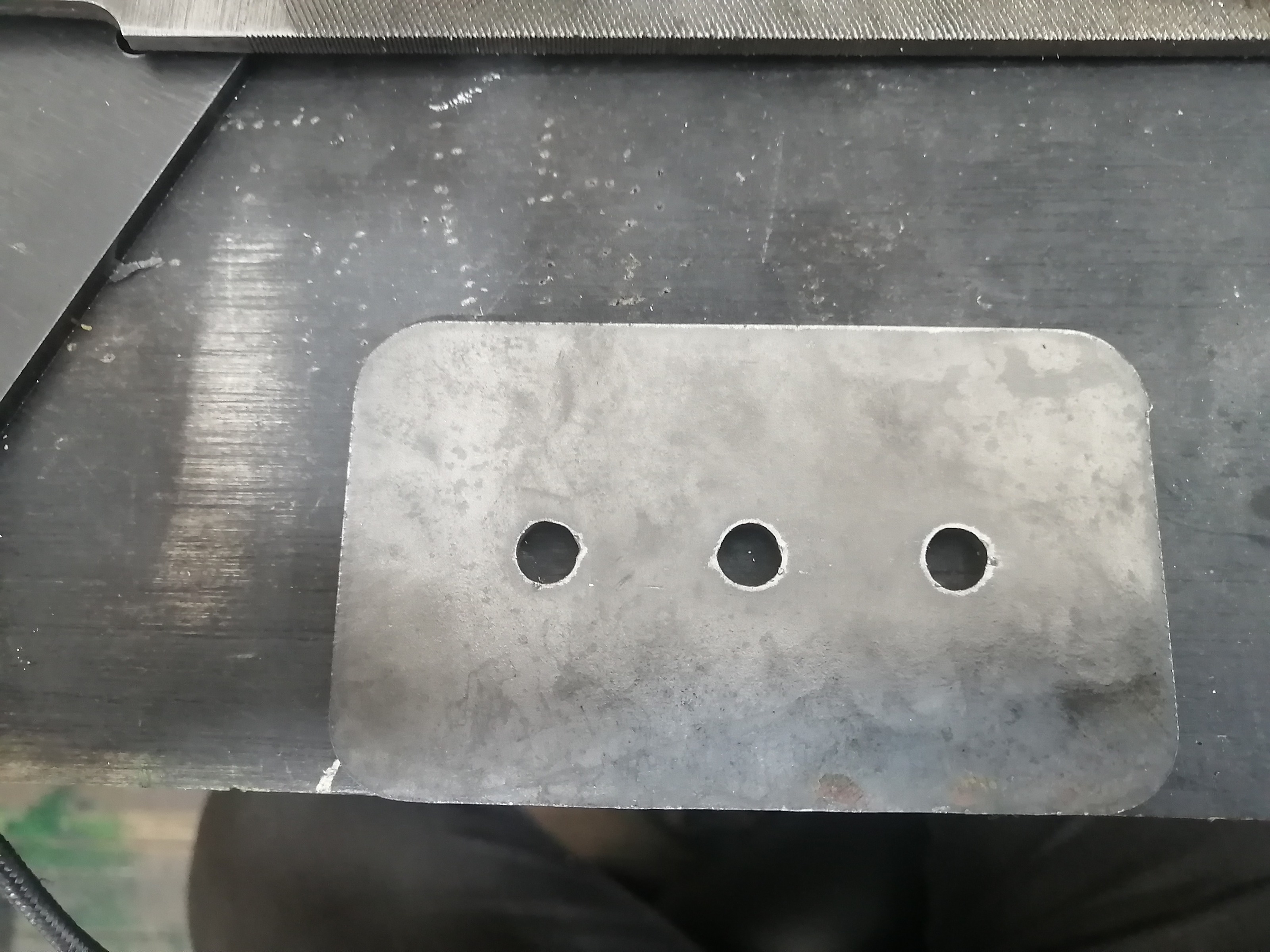

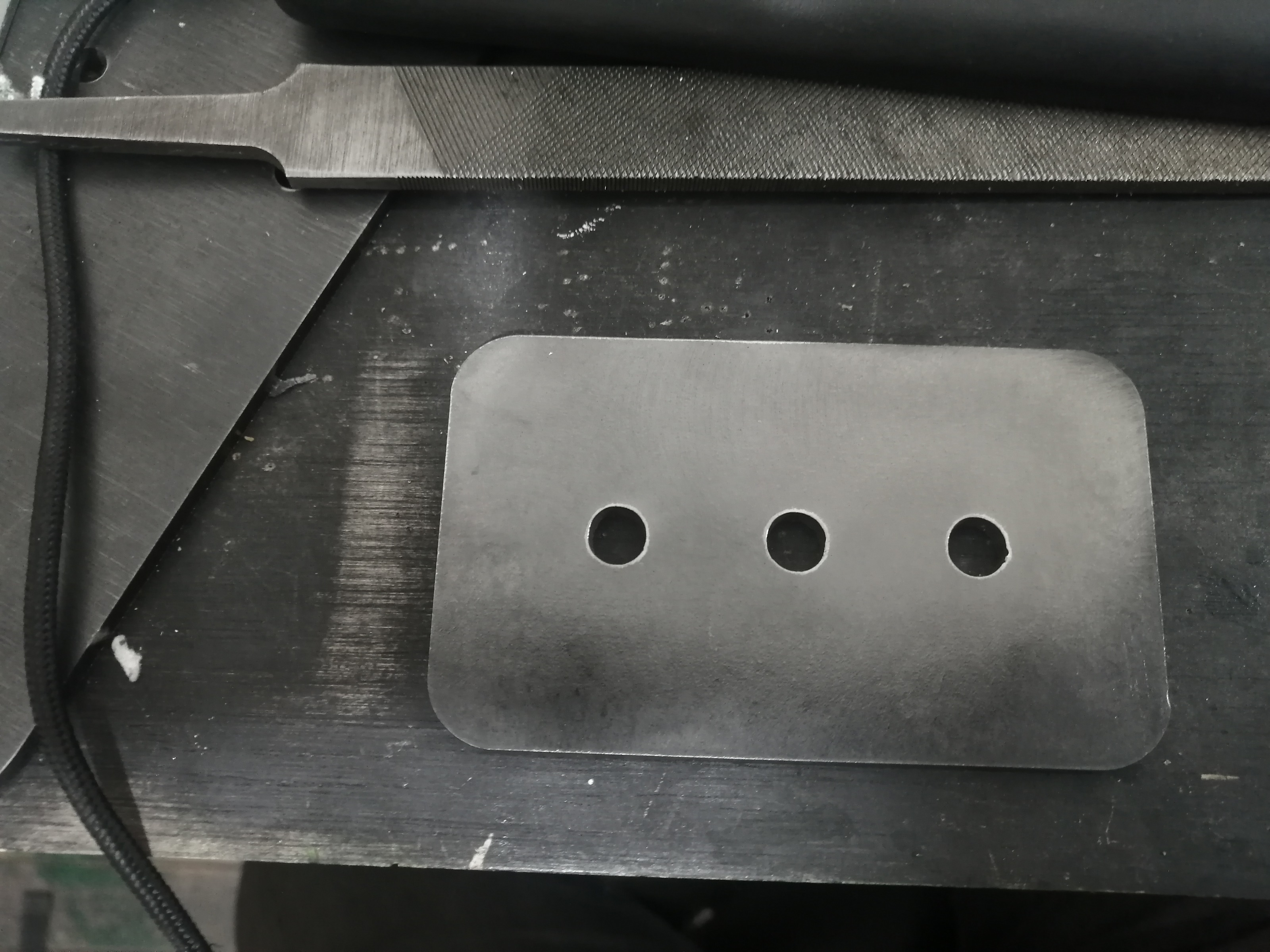

Greetings.After performing the calibration and squaring the machine as best as possible, I have these results: 4mm steel plate, 8mm diameter holes and 4mm overcut, any advice or suggestion to improve?
- Posts: 22005
- Thank you received: 7488
30 Mar 2022 23:42 #238851
Plasma can not cut such small holes as you are expecting it, the air that does the cutting is spinning fast while cutting so changes in direction will change the cut angle.
Anything under 30mm on 3 to 5mm thick material will not be perfectly round, 20mm hole will have nearly 1mm difference on 5mm material, etc etc.
Search for "true hole technology" from hypertherm just to get an idea on what it takes to do good holes, even that might not do 8mm perfectly.
Having said that, try slower feed rate, that always helps on holes, use small nozzles and low power so the machine can have some time to remove material.
Replied by tommylight on topic Thc disable
Yes, do not cut small holes!..... any advice or suggestion to improve?

Both Plasmac and Sheetcam have settings that allow you to slow cutting speeds down on holes. Try them
