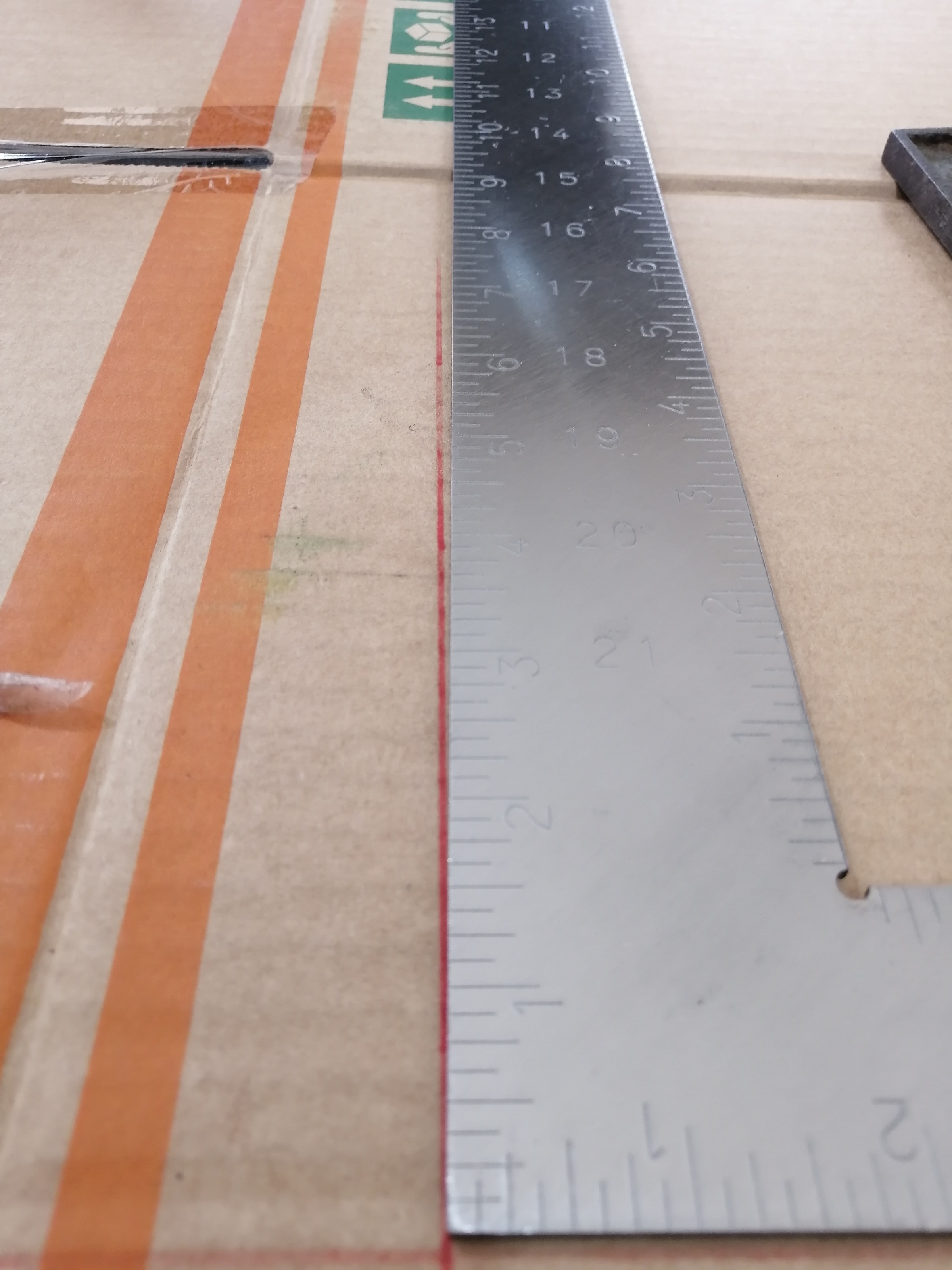

18 Mar 2022 17:28 #237656
by paulsao
Replied by paulsao on topic Thc disable
Greetings to all.This week I was able to adjust some things and carry out the process to square my machine as indicated below. I attached an image where you can see that my machine is not square, as it interpreted this in the form of distance to be able to calibrate the switches.I appreciate your help
- snowgoer540
- Posts: 2580
- Thank you received: 907
18 Mar 2022 21:01 #237673
by snowgoer540
Replied by snowgoer540 on topic Thc disable
I think you’re asking how far to move the switches? If so I just did it with trial and error until it was square. You can also change the offset value in the ini file if you didn’t want to physically move the switch. I’ve not done the second one, but Tommy says it works, and I trust Tommy

18 Mar 2022 21:11 #237675
by paulsao
If the move distances are correct, and if you were asking how to move the switches or how to adjust the start offset in the ini file, I guess that value is also trial and error, well I'll give it a try and if I have any questions I'll ask for here, thanks.

- Posts: 21962
- Thank you received: 7478
18 Mar 2022 21:44 #237680
Now takes even less, takes more time to measure and home the machine.
In general, mark the 4 corners on a plate/table/sheet/ply (using a laser makes this a breeze), measure the two diagonals, calculate the difference, figure out what side is best to move, edit ini by entering HALF of the difference to one joint, check again, chances are it will be spot on.
Replied by tommylight on topic Thc disable
I have 3 machines in the shop, two more on client sites that i have built and use .INI squaring in use daily, and another 2 industrial retrofitted ones,one of them still on 2.8PRE since when that came out. Must have been very lucky on this last/first one as i edited the hal and ini by hand and got it working in about 10 minutes ... after dealing with the fear of "how do i do joints now?"I’ve not done the second one, but Tommy says it works, and I trust Tommy
