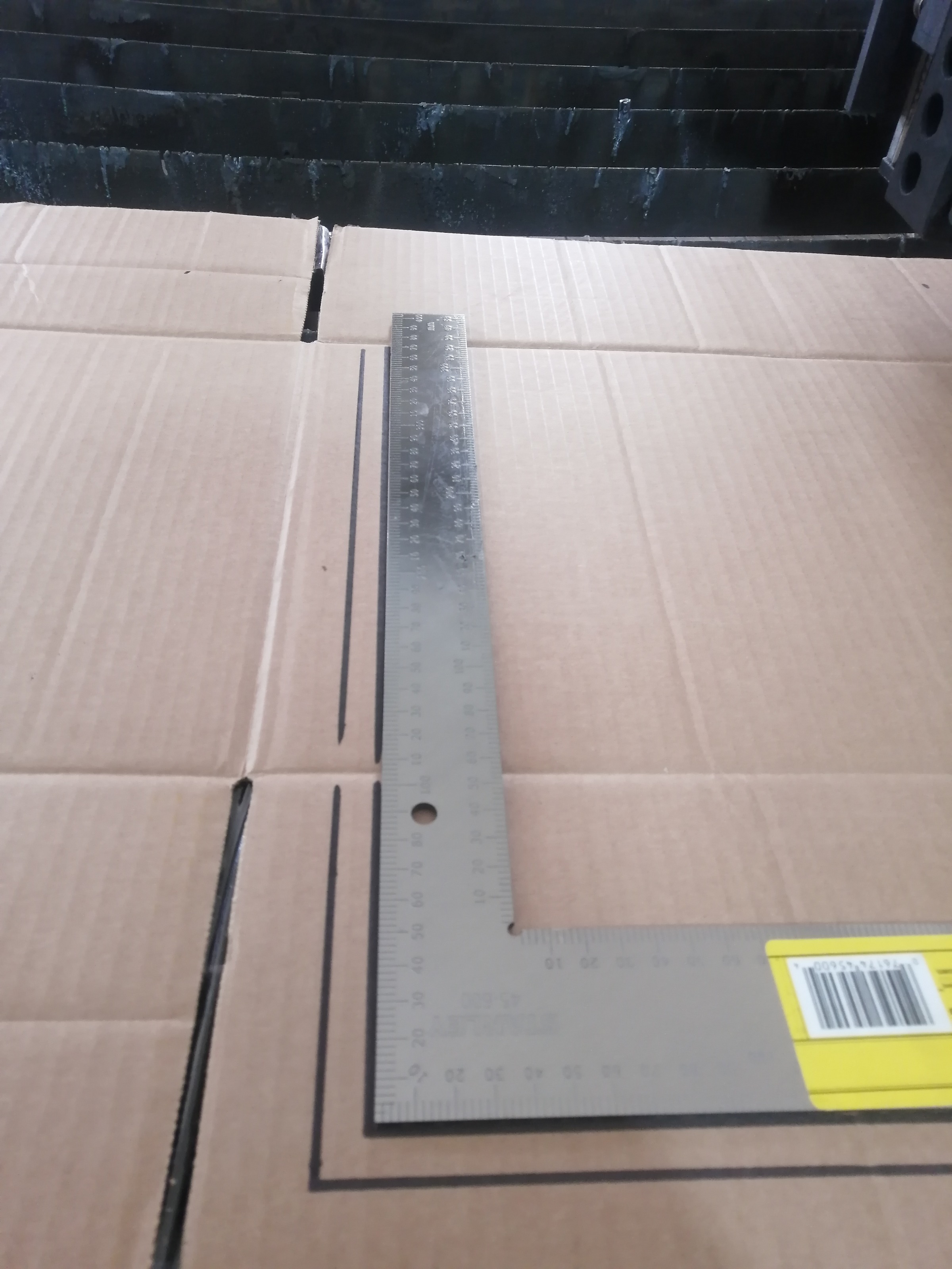

Well that was the problem, the limit switch was changed so I changed the order and now it is back home and behaving fine, now I am going to square the machine and wanted to know if it is varying by trial and error. Home offset or is there a more accurate way to do it, thanks.
Last edit: 24 Mar 2022 16:07 by paulsao.

24 Mar 2022 16:12 #238232
by snowgoer540
Replied by snowgoer540 on topic Thc disable
You have two choices previously described in this thread:
Tommy's suggestion:
forum.linuxcnc.org/plasma-laser/45302-th...able?start=10#237680
My suggestion:
forum.linuxcnc.org/plasma-laser/45302-th...able?start=10#236862
Either will get you there. Currently it requires trial and error either way.
You will have to restart linuxcnc between INI file edits.
Tommy's suggestion:
My suggestion:
The following user(s) said Thank You: tommylight, paulsao

24 Mar 2022 21:31 #238277
by paulsao
Replied by paulsao on topic Thc disable
I think I have improved a lot!
