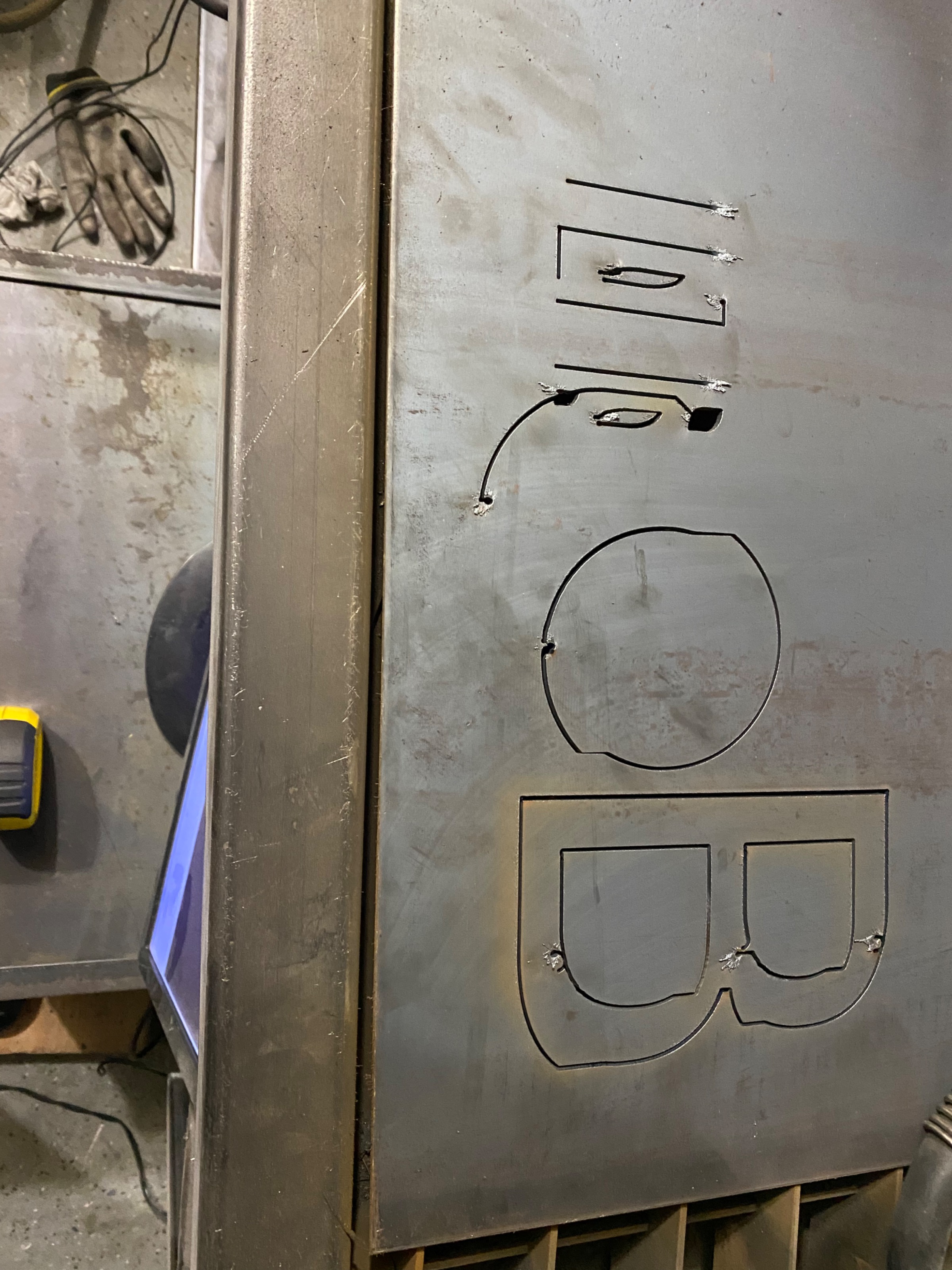

- Aldenflorio
- Posts: 389
- Thank you received: 15

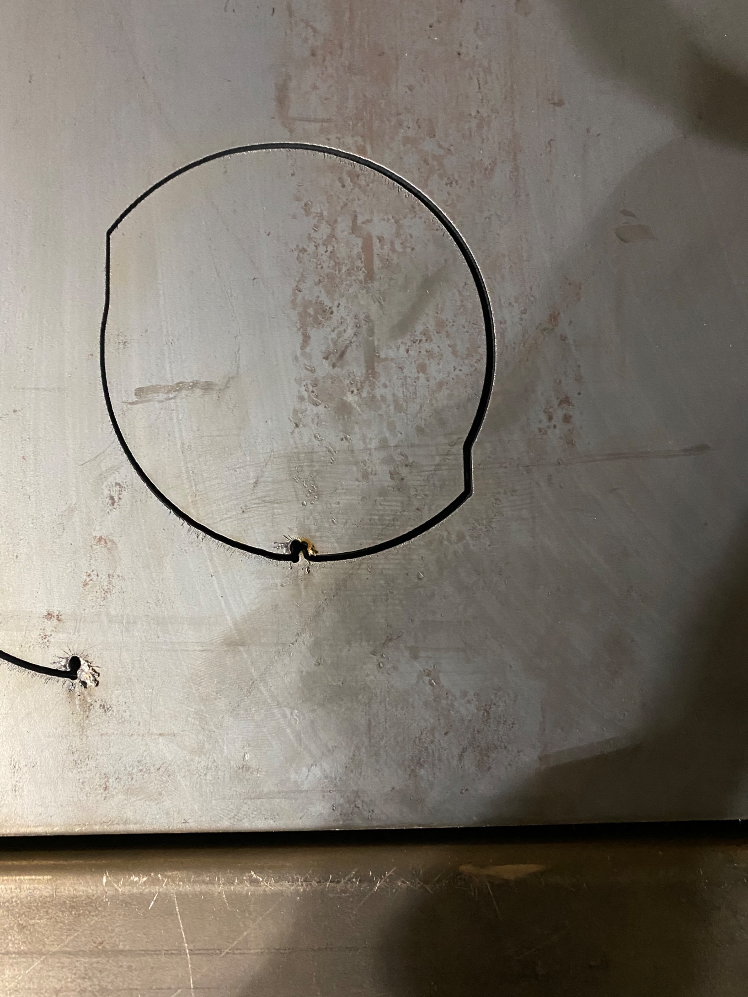

10 Mar 2022 21:01 #236887
by Aldenflorio
Replied by Aldenflorio on topic Torch isn’t firing
- robertspark
- Posts: 915
- Thank you received: 216
10 Mar 2022 21:02 #236888
by robertspark
Replied by robertspark on topic Torch isn’t firing
backlash or something loose?
problem seems to be on the same axis
note the powermax 45 (non xp) is 50:1 voltage divider, non adjustable.
