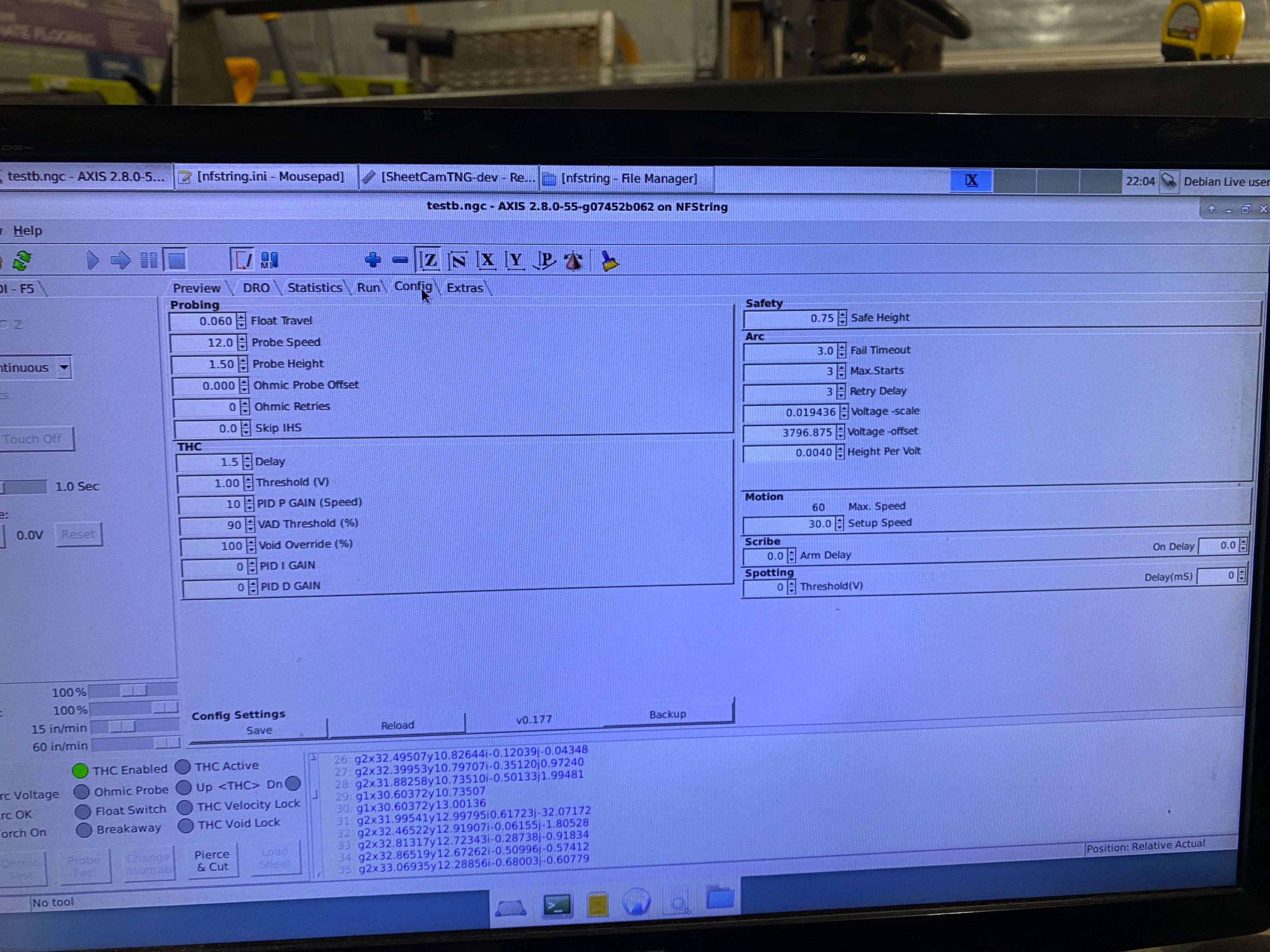

I will do this. Do you think it will take care of the velocity lock? Maybe I set the correction rate too fast and the motor is locking? What seems to be the issue with that?

Hard to say what the issue may be without seeing what you are trying to cut and also the settings you have for THC and ARC on the config tab.
Are you using the defaults or did you change them? VAD Threshold (%) should be 90 by default.

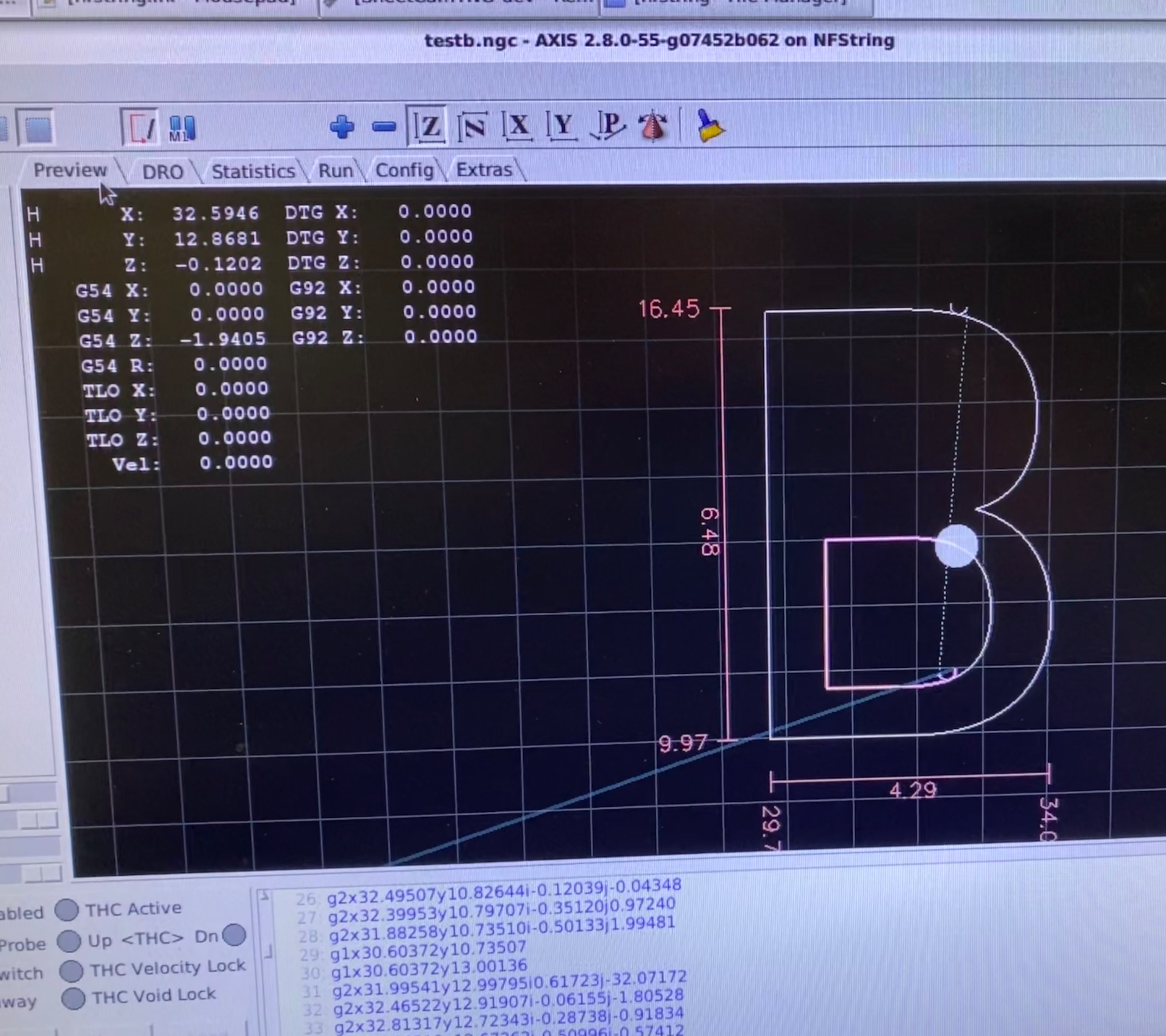

I think cut and paste made a mess of the config.
Use the "Backup" button in the centre of the second image to create a backup of the config and post that as an attachment here and also attach a copy of the gcode file.

Sorry for not being specific, I meant see as in look at the g-code file. While you're grabbing a new zip of your config to post, can you post the testb.ngc file as well. Just in case there's an issue there.
