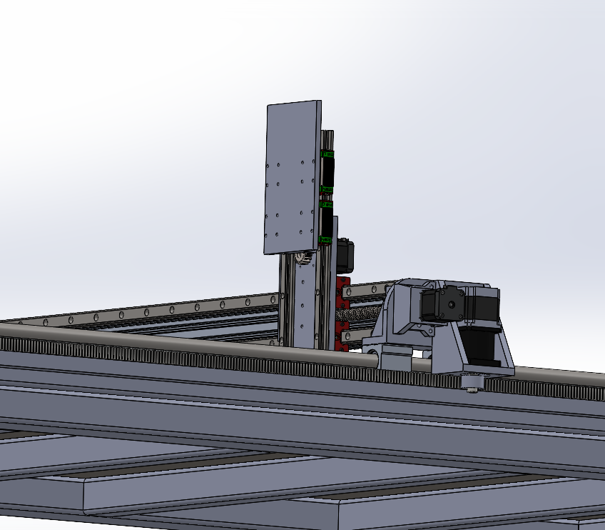

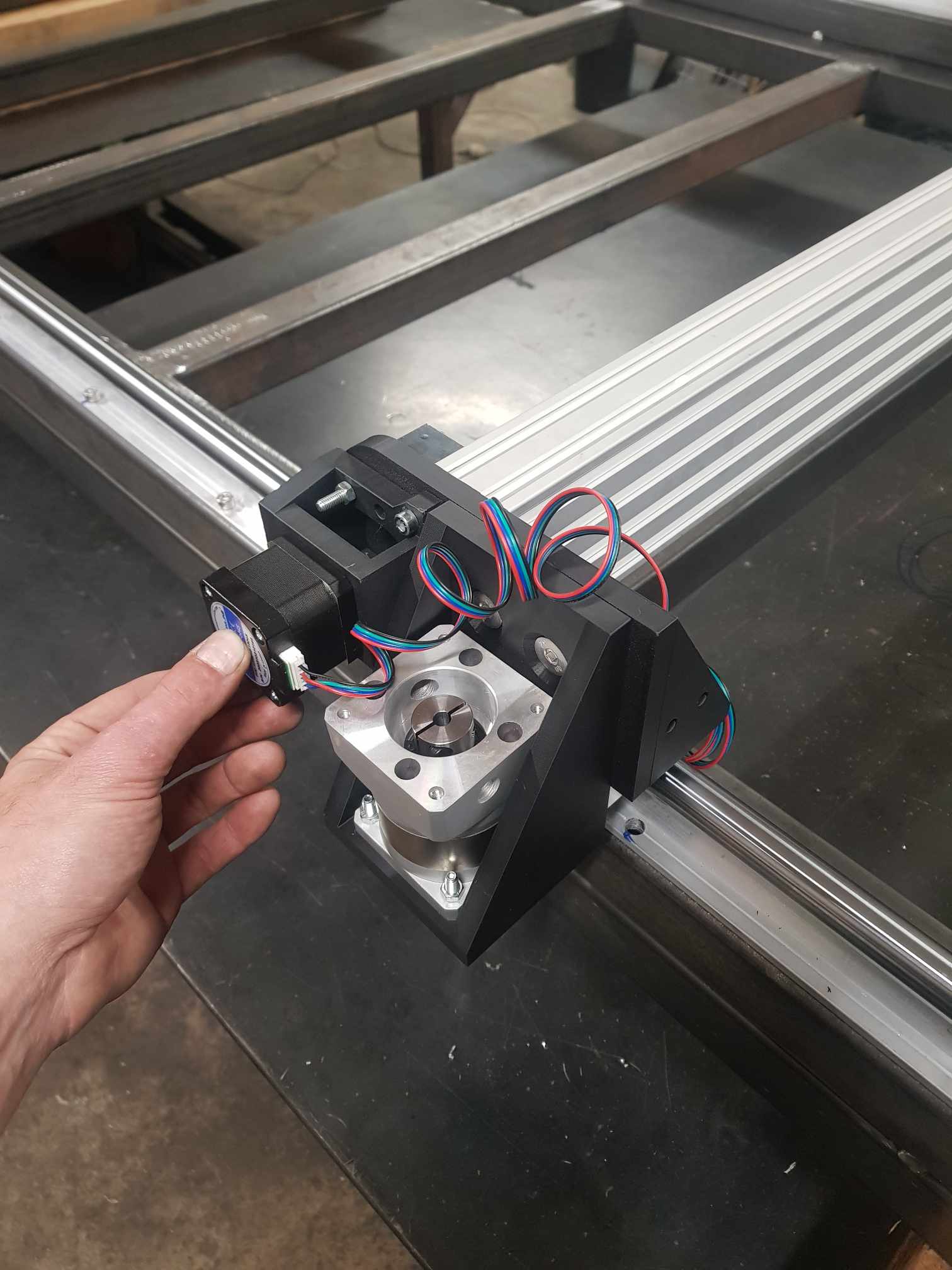

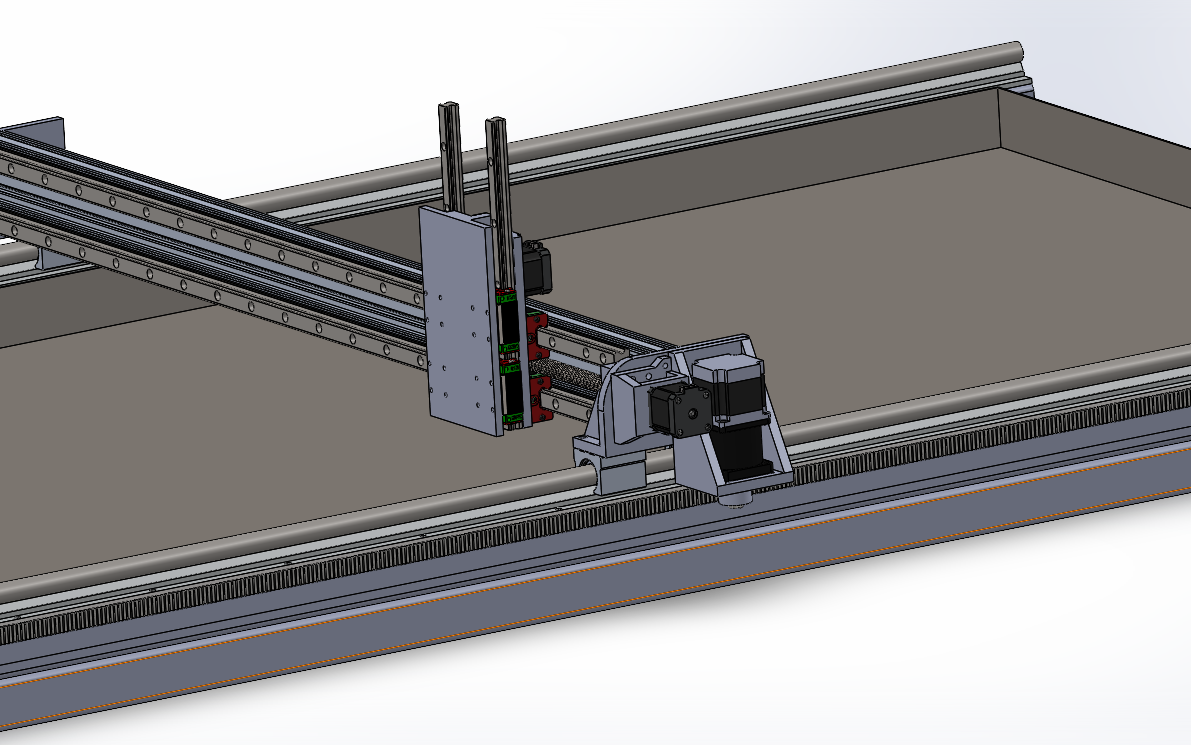

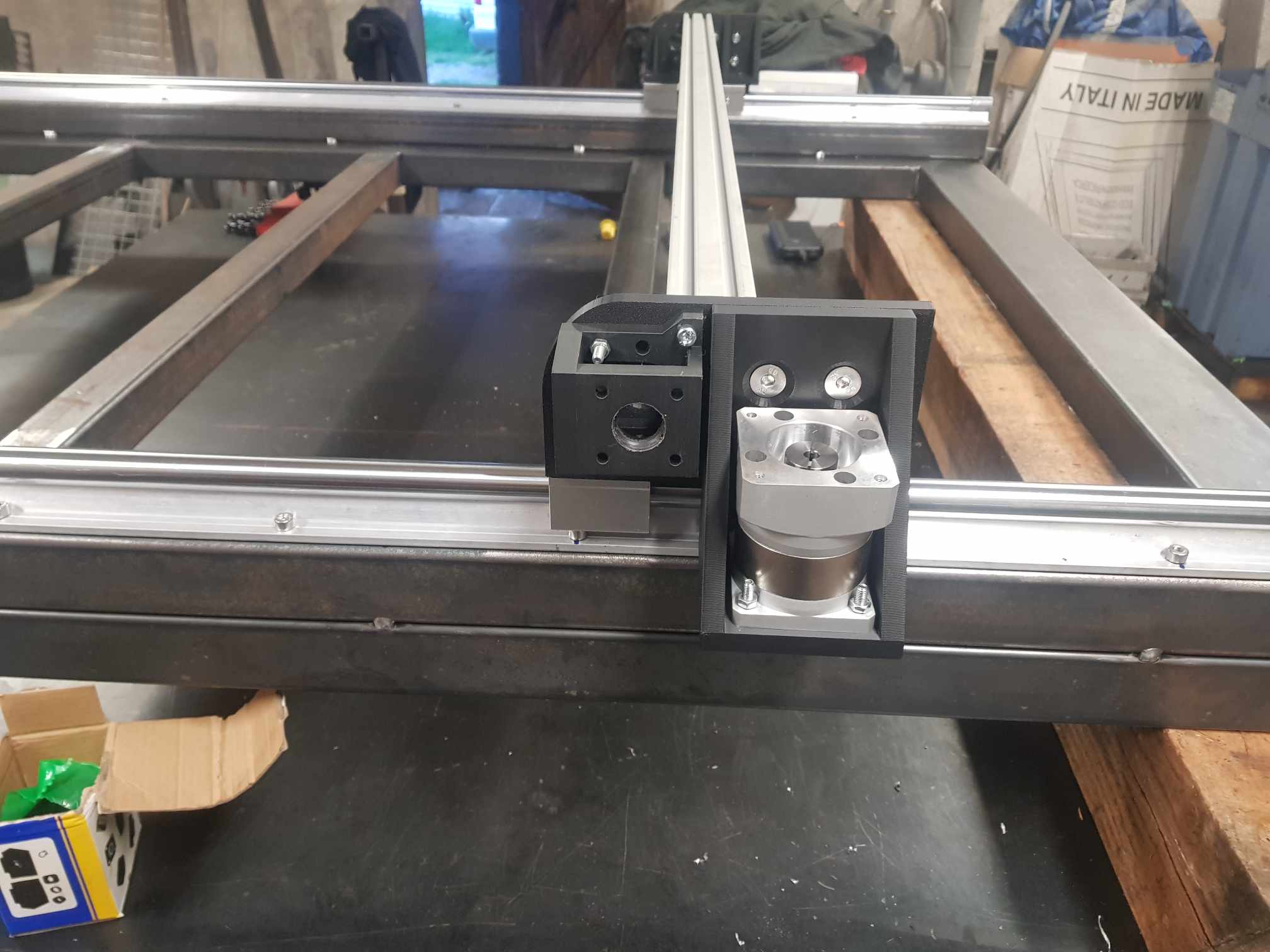

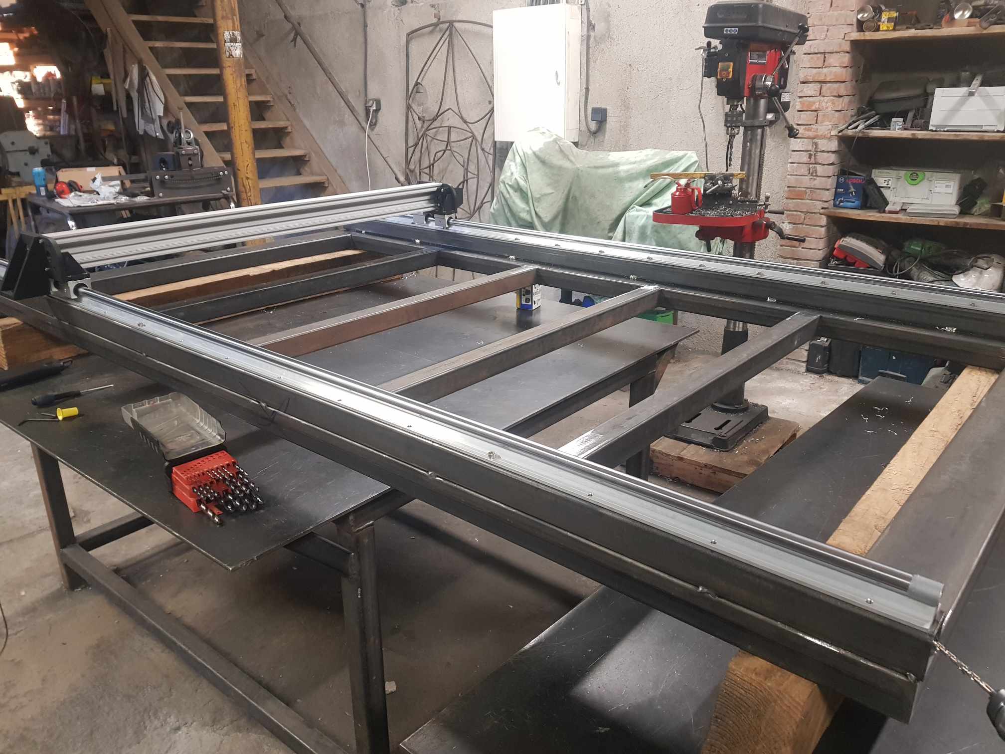

Hi everyone,
I'm a blacksmith/metalworker with my own shop, and I'm in the process of building a CNC plasma table and I thought I would create a subject on this board to help me go through the electornic part which scares me a little.
I'd like to use LinuxCNC to run it with a Mesa7i96s and Mesa THCAD, and an old computer I have. I've found this subject which seems to be really helpfull (with a complete wiring diagram) : forum.v1e.com/t/lowrider2-plasma-build/13939/4
I'm a bit lost though because electronic is a bit complicated to me and would like some precision about how this thing works.
First I understand the needs for a floating head. I also understand that it can be build with a limit switch. I'm not sure though how it goes in the grand scheme of things. Do linuxCNC already knows how to use a floating head ? Is it as simple as telling LinuxCNC which pin of the Mesa 7I96s is connected to the limit switch of the floating head and teeling it the distance it has to go up after the switch is triggered, and then use Gcode to tell the plasma to probe the distance before each cut ?
Also I currently own a Stalhwerk cut 70 which I believe is HF. From my lecture on the subject a HF CNC plasma is really not a good idea. I'm ready to sell it and to buy another plasma CNC compatible (I'd like to have already pins on the plasma because I dont trust myself opening it and playing with voltage dividers etc, as I said I'm not confortable with electronics, even though I try to learn). Hypertherm is not really an option as of right now because of the price. I believe Stamos make a CNC compatible plasma cutter for a bit less than 700 euros.
Could someone confirm that I should wait to know which plasma I'll use before I buy the THCAD as I believe it depends on the arc voltage coming from the plasma (some already have a voltage divider, other not) ?
I'm really sorry if my questions sounds messy, I'm not a nativ english speaker and I'm a bit lost with the huge sum of inormations (sometimes which contradict themselves) I find on the internet. I would greatly appreciate any ressources you have which could help me in my project. Thank you very much for reading me. I plan on updating this subject as the building goes.
Some pictures of my 3D model and the start of the build (I'll replace the 3D printed part with aluminium one's once I've validated the build):
