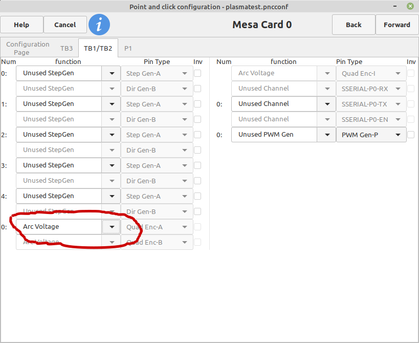

It's a stupid question again but I can't find the page during the configuration with pncconf where I should enter the THCAD-2 informations.
On the QtPlasmaC documentation page it says : "The THCAD screen will only appear if a Plasma Encoder is selected in the card screen". I can't seem to find how or where to do that.
- Posts: 18093
- Thank you received: 5325
19 May 2024 14:57 - 19 May 2024 15:09 #300968
Replied by PCW on topic The blacksmith's plasma table
Last edit: 19 May 2024 15:09 by PCW.
The following user(s) said Thank You: polskleforgeron

I have a bit of time ahead of me so I started to set up the THC (I wasn't using it until today). Of course i doesnt work and I have no idea why.
First I'm not sure what I should enter when asked for the voltage divider. I'm using a THCAD-2 with two 1MO resistor on both + and - cable. I've entered THCAD-2 with W1 UP when asked during the configuration. By default there is a 20 ratio voltage divider. I would say I have no voltage divider and should enter 1 but I'm not so sure...
Anyway, I'm pretty sure it isn't what makes it not work. When cutting, even though I have enabled the THC (both in QTplasmaC and in sheetcam) the "active" indicator on QTplasmaC never turn on. I'm not sure where to start to know what's wrong (the physical led on the THCAD-2 board is turned on though).

24 Aug 2024 09:50 #308525
Replied by rodw on topic The blacksmith's plasma table
Its getting exciting for you.
2 M Ohm resistor will give you a full scale reading of 210 volts. (per the THCAD manual p 6)
The Thcad full scale is 10 volts so you have a 21:1 divider.
